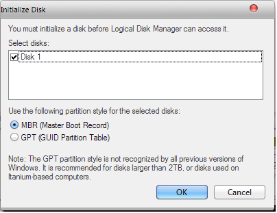

Hey Everyone, Nice to meet u all... I got a Seagate 500GB External Hardisk which i bought around 6 months ago.. I always used to keep my harddisk connected to my pc and then one day it stopped working without any warning.. i tried installing the driver again and reconnected it but still it wouldnt work... and then when i went to device manager the harddisk is displayed there but it wont get displayed in mycomputer... then i tried assigning a drive letter so i went to disk management but it didnt show up there.. so i uninstalled the driver and then tried reconnecting and then the disk management kept on loading and after sometime it showed up and in the bottom where the hdd is displayed its written "Disk 1 with a red down arrow, below tat unknown, below it 2048.00GB, below it Not Initialized..... and after some time it showed Initialize Disk window and it said tat i need to initialize it before logical disk can access it... Wat to do?? i got so many important data in it... is there a way to recover it??

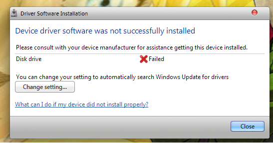

Right now i tried everything i said here.. and when i tried the driver installation it said failed.. and in disk management it shows exactly like i said.. and in device manager it written "Disk Drive" and when click on details its blank...i have attached the disk management view and driver failed view... hope u guys can help me.. Thanks.. ^_^
File comment: Initialize Disk View
File comment: Driver Installation Failed View

If your data on the drive is important, first thing I would go to a data recovery company to get a diagnosis, so you could understand what's the problem of your drive.
A DYI for now would be to power up the drive and listen very carefully what sounds does it produce and let us know.
When the drive shows up like this in device manager did you create a partition?
I think it may have a Firmware problem our some information in the MBR was lost.
I recomend you to don't create a partition and take the drive to a Data recover pro near your house.

As it's a 500Gb drive showing a 2Tb partition I suspect firmware / PCB... but proper diagnosis is crucial... Not a DIY case I'm afraid.
