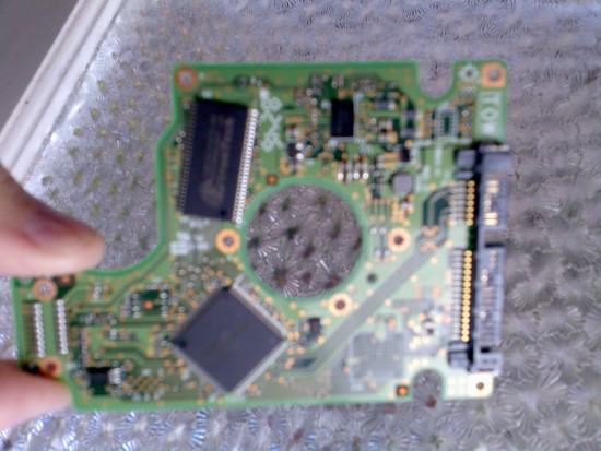

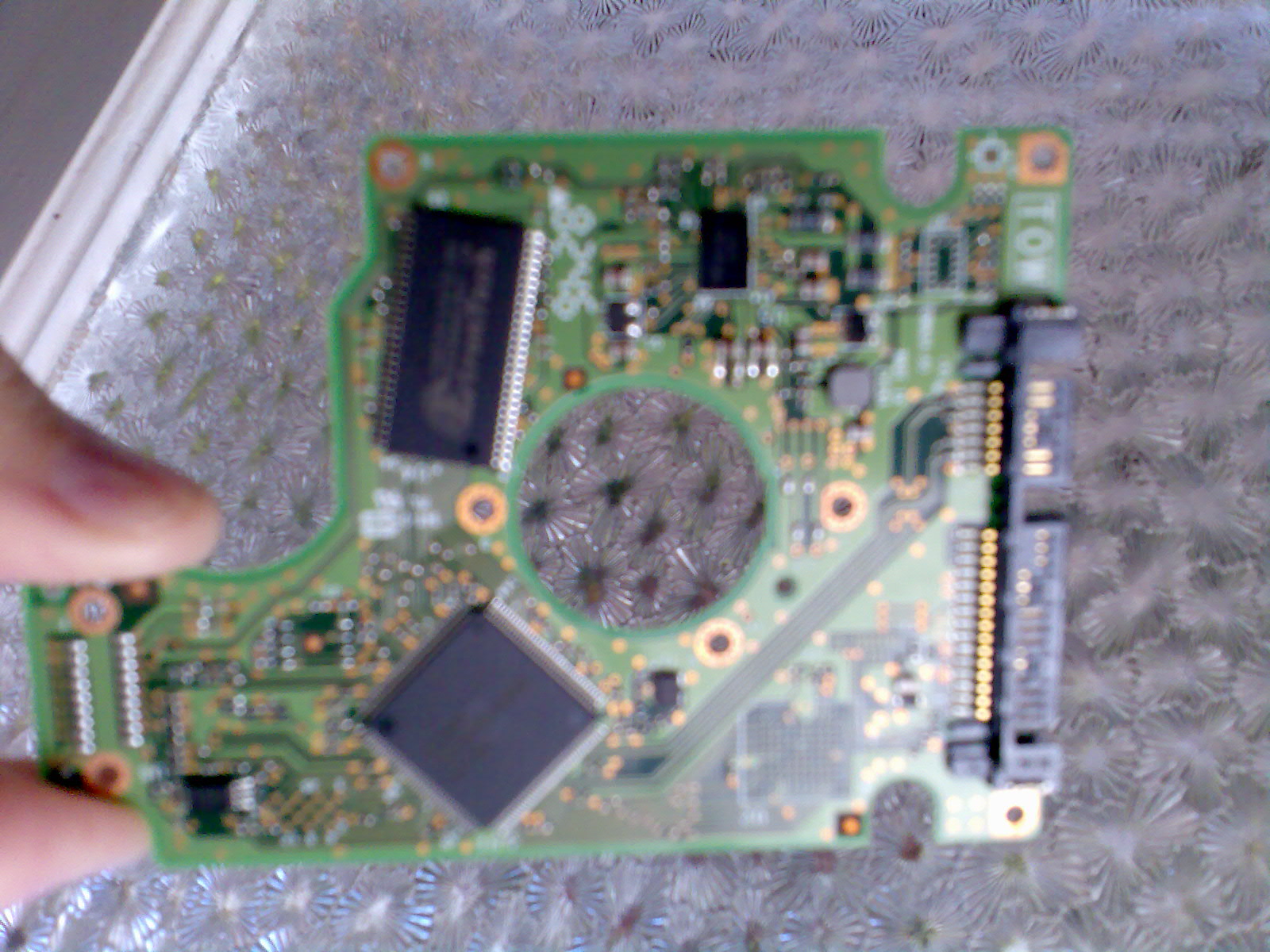

HITACHI Model: HTS543225L9A300 - SATA - 250GB
P/N: 0A57365 MLC: DA2352
No sound, nothing ... doesn't work at all.
I search near the Power - SATA in PCB and found a Diode - D1, a gray block and 2 Fuse - F1 and F2 (one is missing (only the points) and the other is present but infinite ohm).
If you have this disk working and good shape, please tell me values for this components (ohm - Ω).
Or other values, I can check in PCB - Volts or Ohms.
Thanks,
Neuron

Any of you encounter any problem (in your experience) in the rest of PCB to damage this components?
I think (in this disk) the damage ... because the notebook send incorrect volts.

 Post subject: Re: HITACHI HTS543225L9A300 - SATA - 250GB
PostPosted: February 2nd, 2012, 3:11
Posts: 17311
The fuse is open. Is D1 shorted?

My first post I asked about the fuse, because we have 2 in most PCB and in this one I have F1, F2 write in PCB.
But, one is missing, with a magnify glass I see the pins with solder and i can't see the burn or pieces of fuse.
The other fuse in all scales 200Ω, 2000Ω, 20KΩ, 200KΩ, 2000KΩ .... no Ω value - infinite.
D1 - I can read some Ω. Since I don't have another identical board, I ask your value opinion, or I can connect the power and see the voltages in this part of circuit.
Best regards,
Neuron

Yes, the second fuse doesn't exist in this PCB and version.
SATA Power (+5 V) -> Fuse (open) -> D1, Brown block and a small block (in parallel)
The disk don't power on because the Fuse don't conduct.
D1 - Cathode (-) Black (from Multim.) thousand Ohm
Anode (+) Red (from Multim.)
Cathode (-) Red (from Multim.) infinite Ohm
Anode (+) Black (from Multim.)
What is your experience and some examples that you encounter?
D1 is damage if a Overvoltage came from SATA Power (Ex. 19 V).
The Fuse(s) are damage .... because overvoltage (microseconds) from SATA Power or a short circuit inside the PCB or in disk?

An overvoltage from a laptop adapter, when applied to an external drive, usually causes the drive's 12V TVS diode to go short circuit. But that's a different problem.
Since your diode is not shorted, then you could be lucky and it could be just a problem with the fuse. I would bridge the fuse and power up the board on its own. To this end, you could use an external 2.5" USB-IDE adapter.
