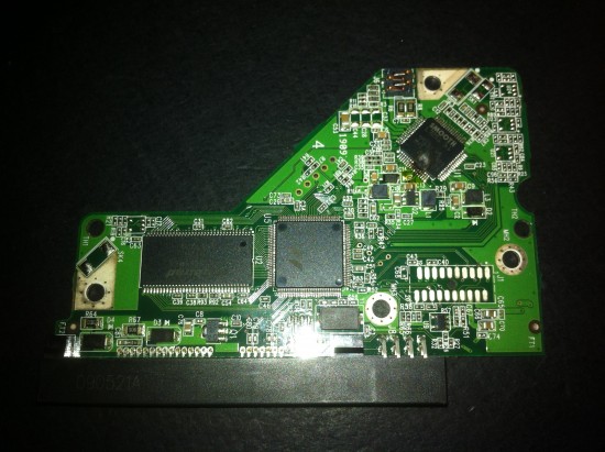

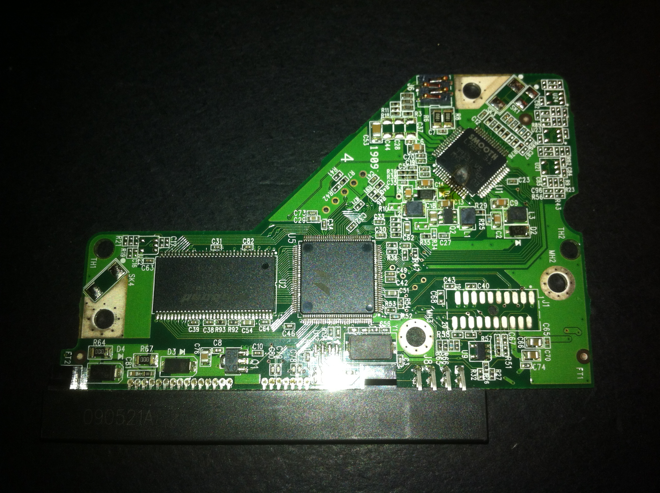

While attempting to recover data from my parents' hard drive, I found that the Voice Coil Motor controller/motor chip/whatever else it is called (SMOOTH L7251 3.1) has been burned. I have a donor hard drive that it the same model (WD3200AAKS-00L9A0), LBA (625142448), PCB (2060-705190-000 Rev A), Voice Coil Motor controller/motor chip, and numbers on the barcode on the PCB (2061-701590-G00 AD).
The patient HDD's DCM: HGRNHT2CG; DATE: 23 JUN 2009
The donor HDD's DCM: HBNNHT2CE; DATE: 07 MAY 2009
After conducting more research, I have found that swapping the PCB's rarely works. I tried this and while I can hear the patient HDD power up, the computer cannot read it. During my research I read that I may have to transplant some of the chips on the PCB from the donor to the patient HDD. Neither have a BIOS chip at U12.
Any suggestions/help that anyone can provide would be appreciated?

Hi, As you don't have a U12...no chip is need to be moved.
That will only make thing's a bit harder, as it a 320Gb drive.
You will seek pro advice on this one

Agree with mr_spokke, U12 is not populated. Therefore you will require assistance from a pro with the appropriate tools.
Perhaps somebody here can help. What part of the USA are you located?

The DIY solution is to purchase either WD HD Pro (US$80 - $100) or WDR-UDMA (US$150). These software tools will allow you to regenerate and reprogram the ROM data from the appropriate firmware modules in the System Area on the platters.
AIUI, they both provide a single-click solution for this problem.
