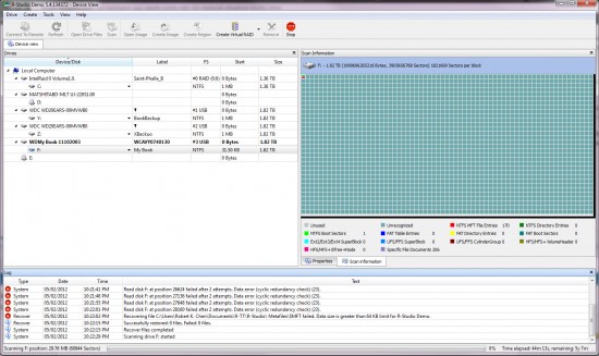

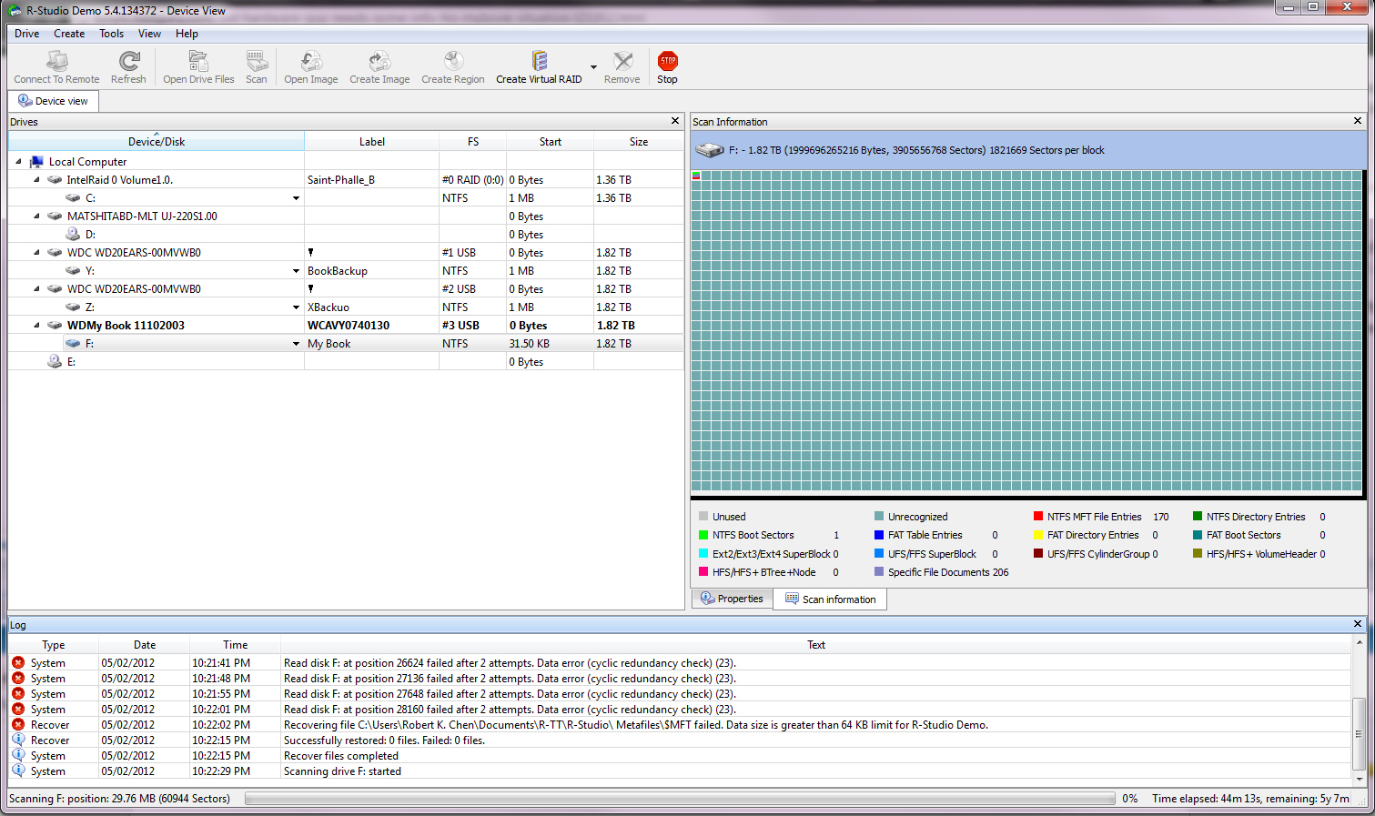

I ran Partition F&M and it could not find any data. Windows 7 (64) sees it as RAW (asks to format it). I'm Running R-Studio as I type but it doesn't seem to be moving (currently at 44 min and still on first block).
Any suggestions?
And an opinion question, is EaseUS just as effective?
RU

Sounds like bad sectors.
Image that drive right away.
Could be bad sectors, but could also be sign of failing heads. Also, the USB does not help.
You could attempt to image it yourself, or you could send for professional analysis, but either way it will not recover by R-studio and not over USB in its poor condition,
