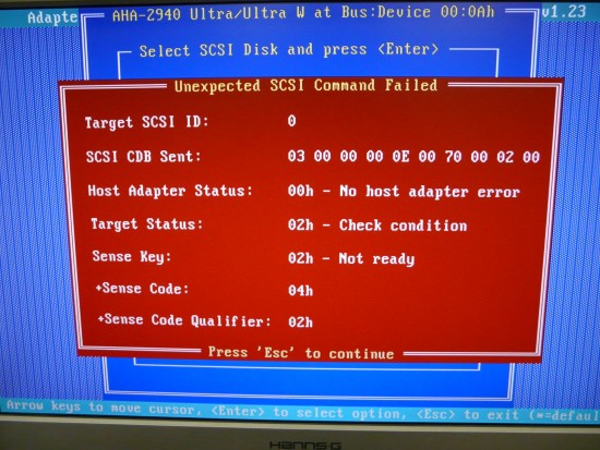

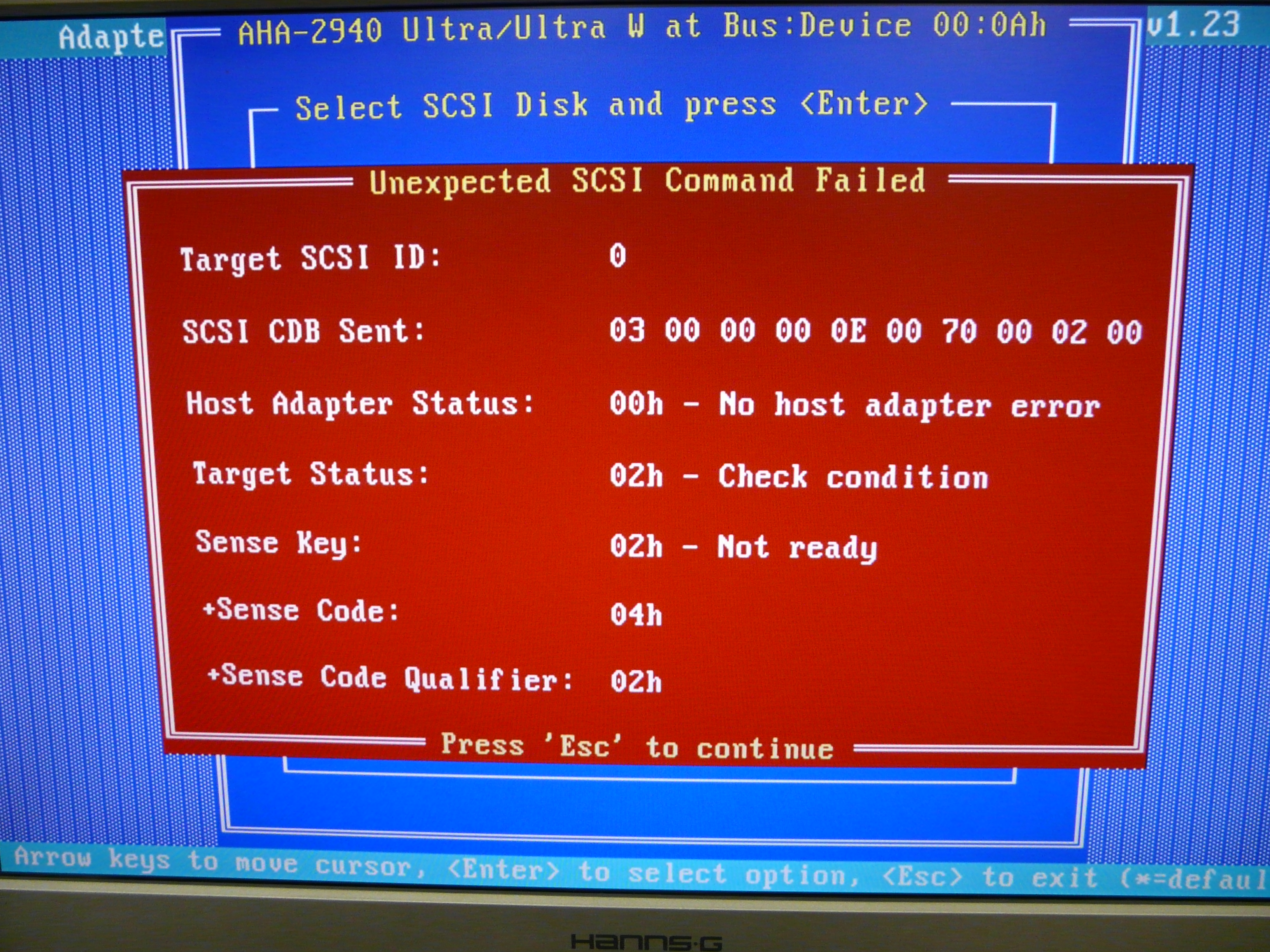

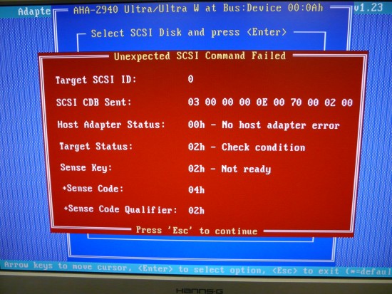

I don't know very much about SCSI drive but maybe some of you will...
So do you know what that error would mean (see attached file) ?
File comment: sceencap

 Post subject: Re: SCSI HDD
PostPosted: February 6th, 2012, 11:17
Posts: 3598
Location: Chicago
Does it spin?
Looks like it doesn't
PostPosted: February 6th, 2012, 12:45
Posts: 3598
Location: Chicago
ici_lemmy wrote:
You're right, it doesn't spin...
But the motor is not stuck and the result is the same with a donor PCB.
error says - use spin up command to spin up the drive
Try auto spin up jumper
Agreed - unfortunately I have also seen exactly the same ASC & ASCQ values from disks which have deliberately spun-down (or did not spin-up) due to an internal fault, and on those drives, sending a Start Unit from the host causes the drive to return the same values again. :(
Some of the Adaptec SCSI card BIOS can be configured to send (or not) a Start Unit command (on a per-target basis), so the OP can try that BIOS setting for the correct target ID, in order to try your suggestion. :)

ici_lemmy wrote:
So do you know what that error would mean ?
See http://en.wikipedia.org/wiki/Key_Code_Qualifier
Key / ASC / ASCQ --- Error Condition
2 / 04 / 02 --- Not Ready - need initialise command (start unit)

With the jumper, now the HDD is spinning but I still have "Unexpected SCSI Command Failed" and now the "Sens Code Qualifier" is 0x00. So according to fzabkar (thank's for the wikipedia page), the HDD is now "Not Ready - Cause not reportable." with the original and donor PCB...
I think i'll try to change the head's in the afternoon.
Do you think that's a good idea or that's useless because it's firmeware issue ?

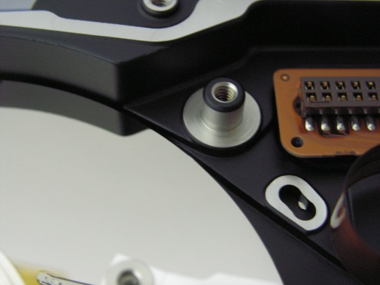

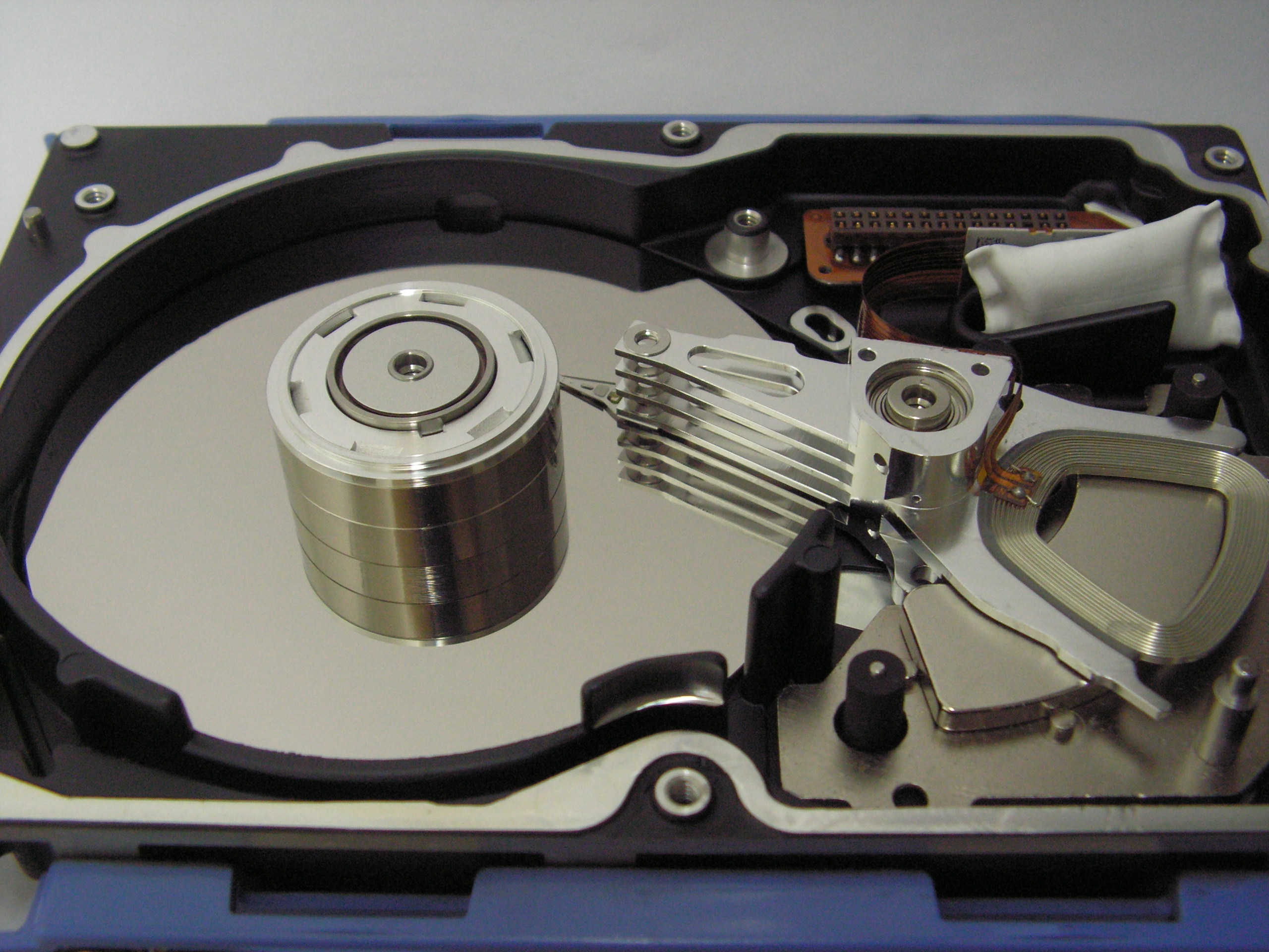

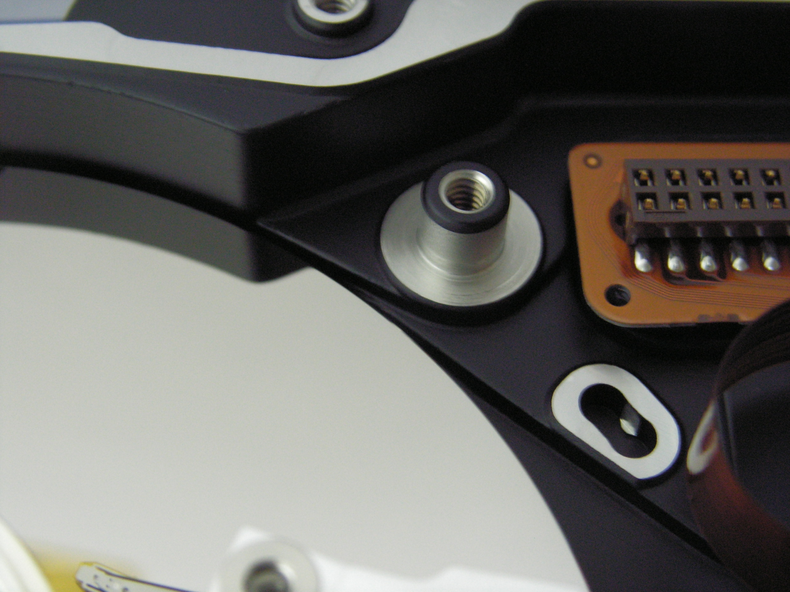

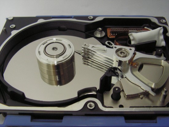

so the bad new is that we can't change the heads...
Maybe i'll post a picture tomorow...
I think i'm gonna give up !
Lemmy

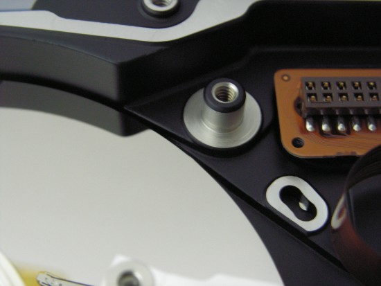

Start with PCB then
It's not PCB since the original one works with donor drive
I don't think it's heads
Anyway, I can't change them
PostPosted: February 8th, 2012, 6:22
Posts: 3598
Location: Chicago
good for you
I hope you don't charge client for your service
PostPosted: February 8th, 2012, 7:15
Posts: 2984
These can be changed, but the process is difficult and procedure totally different to any head change you may have done already.
If the job is bigger than you then simply return the media to your client who can send to to someone who can do it, though it will not be cheap considering the work required and the fact that work has already been attempted on it.
