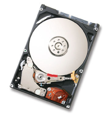

LOL. Sorry about that. What I meant was "fingernail". No idea why I stated "toe", guess it's due to my over-broken english practices. Actually, laughing quite hard about this right now.. Imagining the picture how i'd hold my foot next to the drive to "unstick" the heads with one of my toes :mrgreen:
That's the side area marked on the img. where I applied pressure with my fingernail in order to push the arm to the ramp.

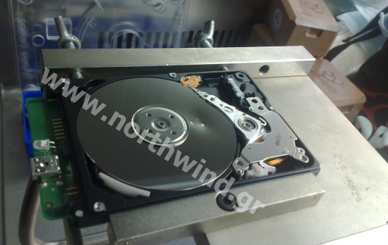

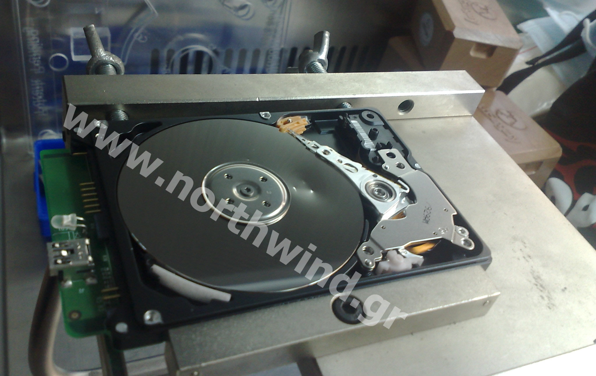

XXL wrote:
Before taking it to a tech. I would like to know as much as possible about the potential procedure that is going to be undertaken and learn a few things here and there while I have the chance - is that a bad thing?
Not at all. Following instructions you read on forums/on youtube/in a blog/somewhere written by someone somehow IS bad.
Y' know, it is very easy -even for a very good tech- to make mistakes, esp. if that someone does not have the drive in front of him. So lets say, you take advice by someone who tells you, hey! it's easy, all you have to do is hit the drive with a hammer (don't laugh my friend, it is a REAL example, just search THIS forum). And you do it. And then you find out that what you did had no good result and you decide to take your drive to a pro who opens up the drive and sees this:
Know where i'm getting at?
Anyway, no matter as i read you have decided to take the safe route, and hddguy has given very good explanations to your questions, so good luck :)
PS. I fell off the chair laughing with that toenail. Funny thing is, i didn't notice it until HDD Spaz mentioned it :lol:
