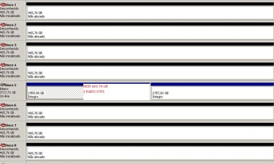

Hi to all!
Please help!
1 hdd 1024 sectors bads only...
RAID 0
8 HDDS 500GB
NTFS
CONTROLLER INTEL
2 PARTITIONS NTFS
256kb or 128 kb
I can see the partitions and all folders and files over the files are corrupted

 Post subject: Re: RAID 0 8 DISKS
PostPosted: February 7th, 2012, 16:32
Posts: 1060
LOOK.....

Is the drive order correct?
you can try two different products from Runtime Software call Raid Reconstructor ( it might work) or a slightly better version of it called Raid recovery for windows. See if it can pick up the correct order and stripe size.
PostPosted: February 8th, 2012, 6:57
Posts: 2984
Check consistency in MFT records.
For RAID0 with many disks is really only way unless you get lucky with automated software.

Thanks all helps!!!
Solved!! :D
