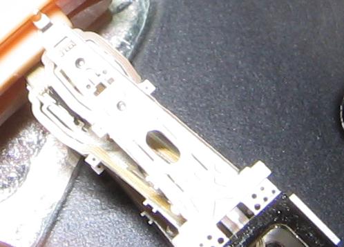

OK so I took apart a different bad drive that had fail DFT with 0x70 or 0x72 error code can't remember which but anyway I wanted to see how a crashed head would sound. To find this out I moved the heads over the platter when the drive was powered off and then turned it on. The noise it made was kinda like the noise the other HDD was making and the motor or the head did not move at all. I then powered off the drive and moved the head back off the platters and even made some noise and was a bit sickly so I know the heads were touching the platters. I then powered back on the hard drive and some how I was able to read data off it still!?!?! I was very surprised by this so I took apart the hard drive with the data on it and the heads where stuck on the very outer edge of the platters. I powered on the drive to see if the motor or the head was moving and it was not. So I vary carefully moved the heads off the platter and power the drive up. The motor started to spin up and the head moved over the platter to the very center part of the disks then to the end and repeats and the computer will not read it. There is also a high pitch noise that changes as the head moves around. I powered it off and looked at the heads closely and noticed that the 2nd head from the top head has a bend closer to the platters then the others. I don't think one head should be different out of 4 but what do you think? If the head is not normal has anyone had success bending it back?
File comment: HDD heads

I 'm sorry to tell you. You are likely kill the drive , make thing worse. even data seem impossible to recover....

Diy=kill drive. Yes, with proper tool and procedure it is possible to recover data - not all. But only if someone did not experimenting like you.
