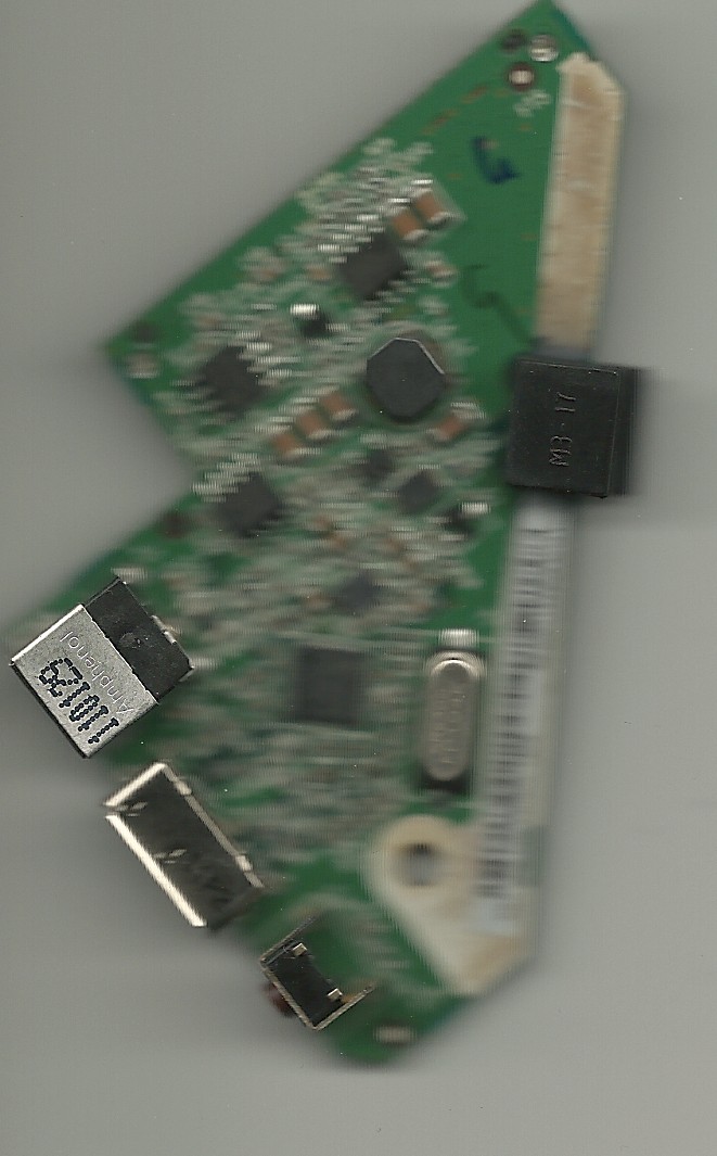

(This was flatbed scan for reference only!)
Spontaneous failure of ext3 formatted 2TB. No password, obviously.
I know there are various reports of success of board swaps to recover data. Has anyone any info or experience with a board swap on this model?
The bridge board ID is 4061-705094-0001 rev 13R
It's different to the others I've seen, possibly because USB3.
The data on the drive is not crucial, and it's going into a QNAP TS219 II after. I'll buy the second drive later - prices have doubled since I bought this unit last August (£66/$100/€80)

Wasn't dropped.
Was plugged into a Netgear WNDR3700 as a pseudo-NAS.
Powers up fine, then goes into cycles of seeking.
Won't mount.
Identifies correctly with lsusb and other drive utilities but nothing will read from it - I/O or read errors reported. Tried rewriting the MBR and partition table, same symptom - I/O error. Will not image - same symptom - read error.
Haven't checked power adaptor voltage yet.
