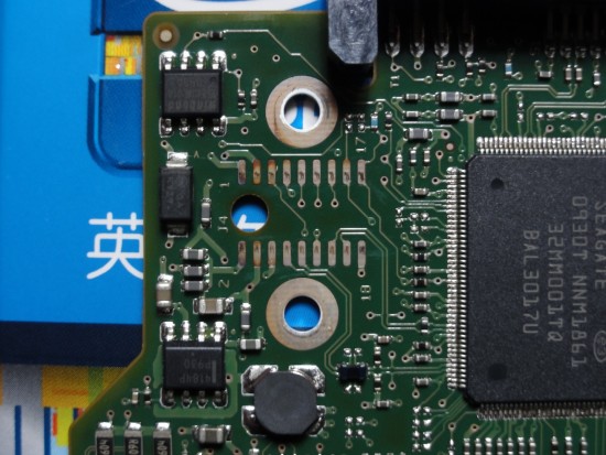

help me please :cry:
I update FIRMWARE then computer can't find it any more.
F3 2>Z
HighPowerMode
Spin Down Complete
Elapsed Time 0.103 msecs
F3 2>U
HighPowerMode
ExecuteSpinRequest
DiagError 00006008
Spin Error
the motor can't Spin up.

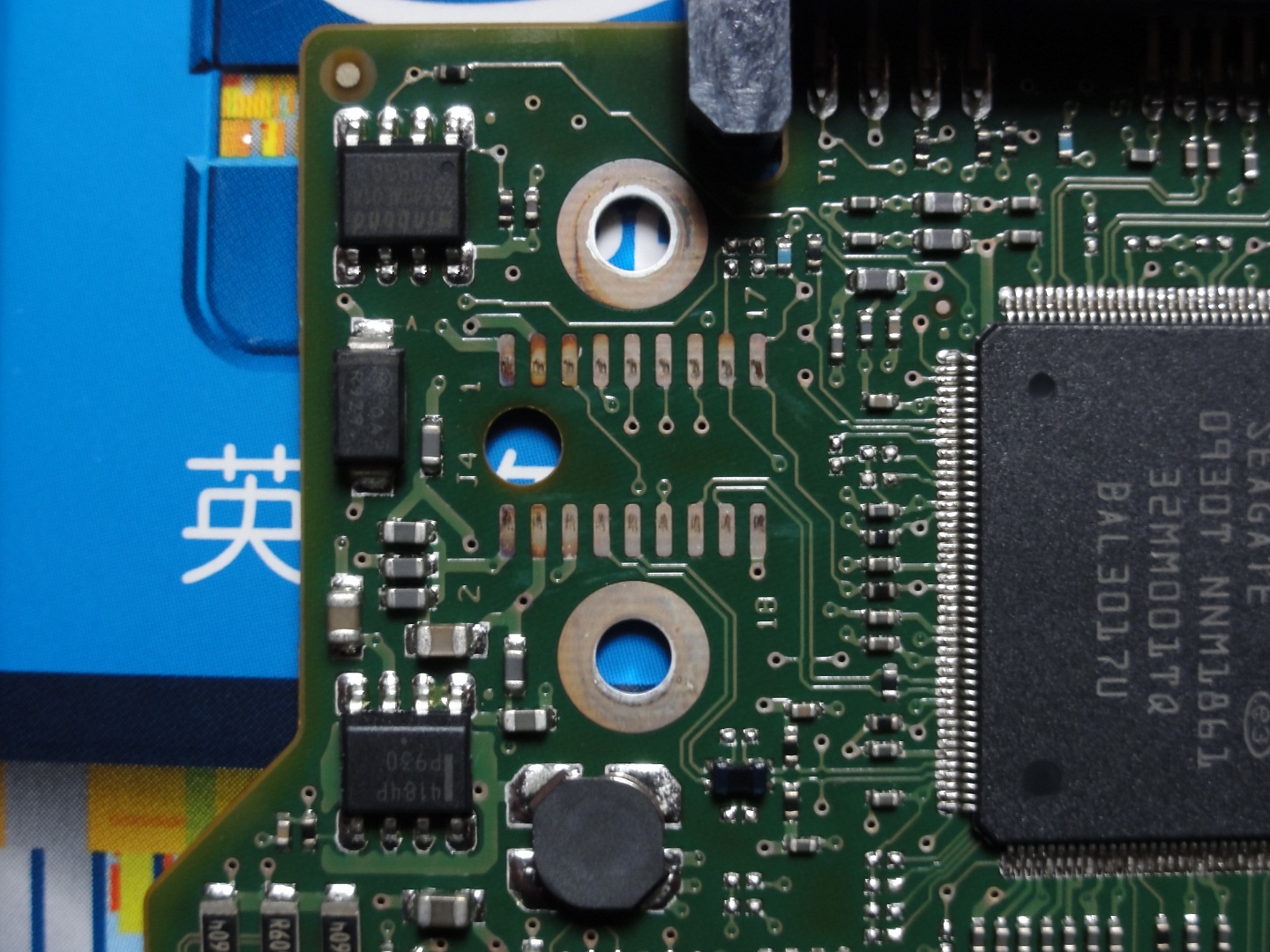

how to short circuit for this PCB.
MODEL: ST3320418AS
FIRMWARE: HP41

I don't know the actual problem (did you update HP OEM firmware with Seagate's retail firmware?), but if you're looking for the read channel test points, then they are pins 14 and 16 of the preamp connector.
You will probably find a 100 ohm resistor between the differential pair near the MCU.
Here are more examples:
http://www.users.on.net/~fzabkar/HDD/RW_TestPoints/

the motor alway can't spin up.
