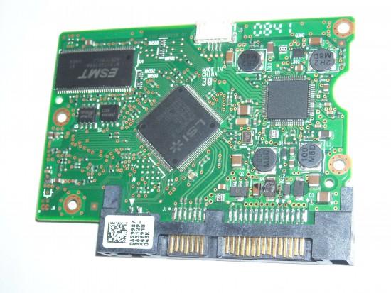

I just rebuild my desktop and ALL my backup info music, movies, games personal Documents are on that drive. The sata part broke while installing and I need this board to replace it. Do anybody know where I can find one?
Model: HTD721010SLA360
P/N: 0A38016
S/N: MH2NJ3GK
MLC:BA3013
File comment: The Black sata part over the gold metal Broke. Need a new board to fix it.

Sir ,
This Connector Can Be Changed At small cost IMHO

You can't just change the PCB. You need to transfer the NVRAM chip as well.

All I want to do is get my data off.
