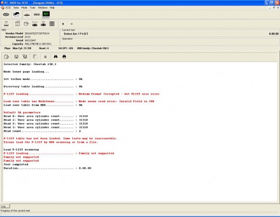

Drive calibrate, utility show correct model,fw,serial but wrong capacity (not 0)
Plist is demaged so i can't regenerate Translator.
All modules and tracks are OK on every head.
Any ideas are wellcome since i am out of any.

Can you check if there's bad sectors on Plist area?
