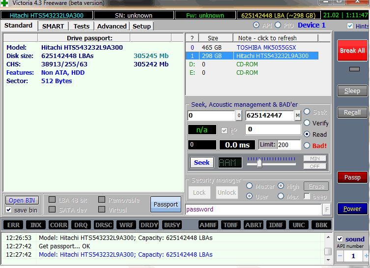

Whenever I start my laptop using this hard drive, it asks me the hdd password. I tried booting with MHDD CD but still it was asking for the password first. So, I took off the drive and booted my laptop via CD and then tried to connect the HDD via USB and the primary SATA. It said "Drive not ready" whenever I used any MHDD command. Tried using Victoria but as you can see in the attached pic, it shows the drive connected via external USB. But still the PIO is disabled. Could you pls. help me with unlocking its password? Thanks!

Did you actually set a password on the drive, or did the laptop suddenly start asking for a password on its own?
I rarely use Victoria, but based on the image you included, which shows the f/w and s/n as "unknown" and your report that MHDD shows "drive not ready", these symptoms do not sound like normal ATA password has been set...
Did MHDD report the drive as security locked when you used the EID command?
