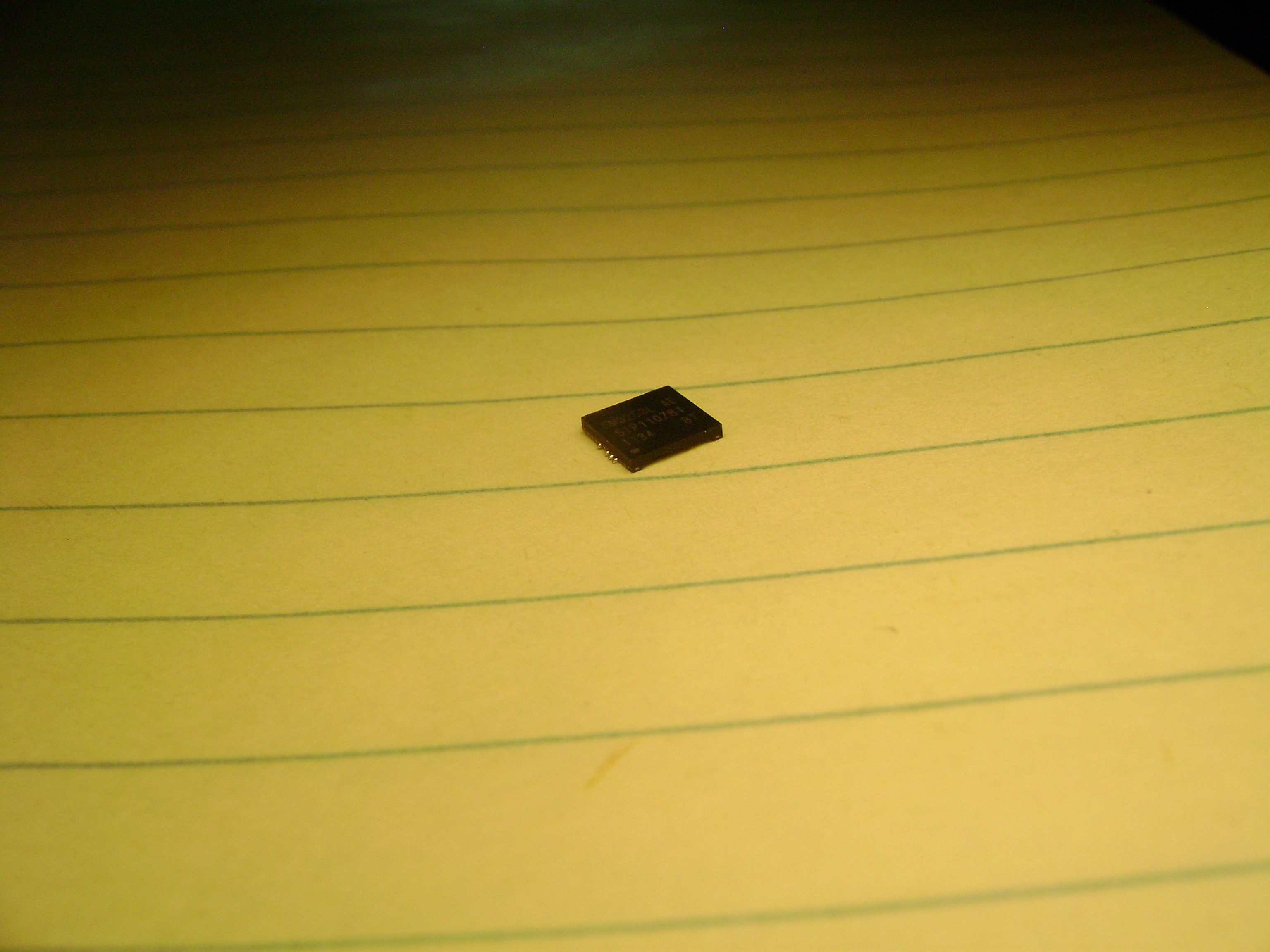

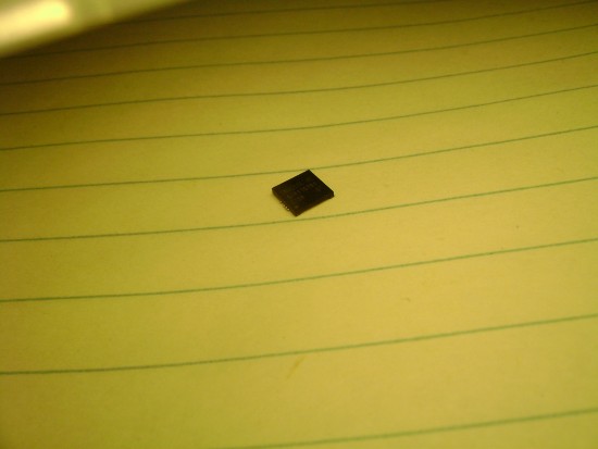

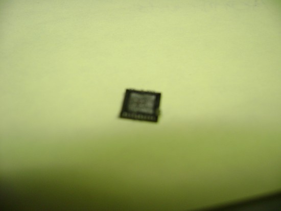

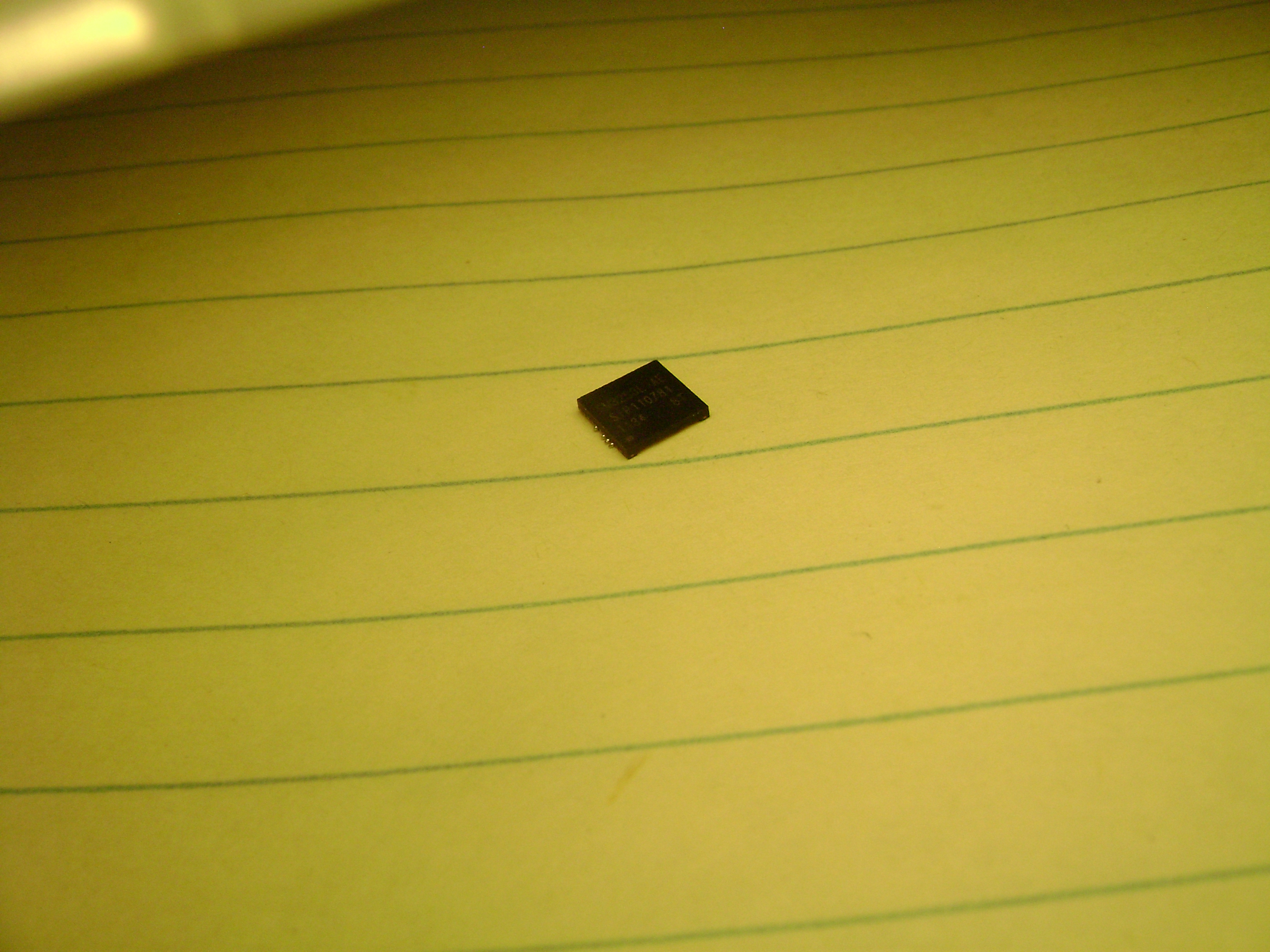

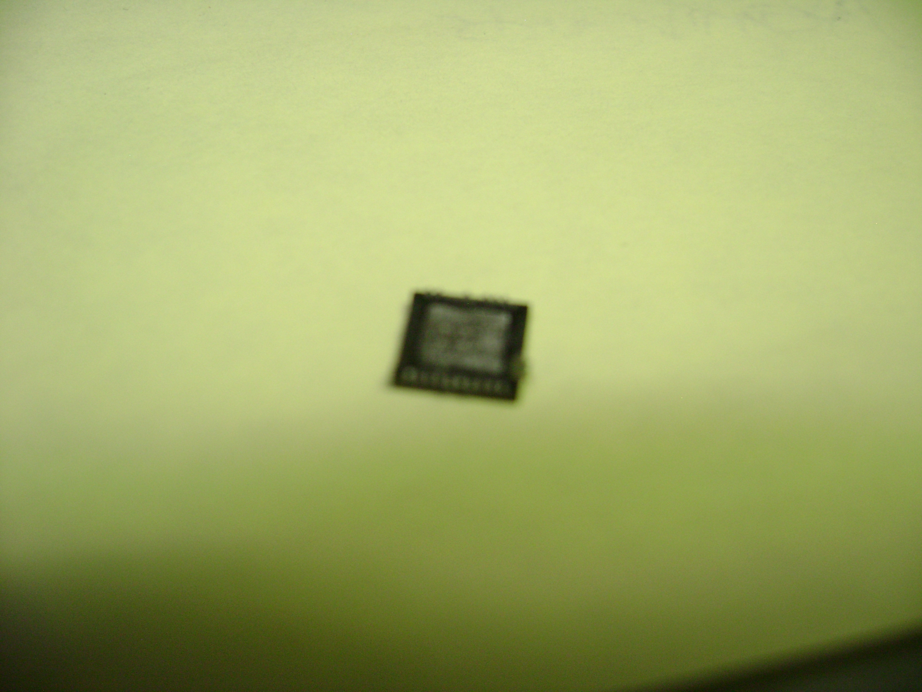

Yes, it does look like SM instead of SW. I attached a few pictures (didn't come out too great, as the controller card code is faded a bit).
Also attached a picture of some of the broken legs (along the left and right sides, and on the right you can clearly see the contrasts between legs being there and legs missing).
We're thinking this may be a bit over our heads (32GB flash drive as opposed to 2 or 4GB like we typically receive). Anyone near the central US want to take a crack at this one? Send me a quote and we can talk. The two data chips don't look cracked (from the top anyways), so presumably the main issue will be working with the reconstruction. After quotes, I can relay them to the customer and see what they would like to do.

Wise decission, flash doctor in it's current condition is only good as a paper weight. Can you post a high resolution picture?
Most important is the NAND chips. You should have 2 of them. If the NAND chips have not been damaged, a recovery should be possible.

Did you explain to him that the controller pins came off and not the nand chips' pins? Because when I first read your post I thought the nand chips' pins came off (and that would be possibly game over). Then when I saw the pics you posted I realized it is the controller you were talking about.
I second (third) everyone's opinion, this is definitely do-able (assuming no damage to nand chips).
That's gotta be an understatement. Did you try scanning the chip?
BTW, does your image editing software have a crop feature? ;-|

@northwind,
Yes, we did explain that, we spoke with him on the phone. The tech that called him explained that the concern was that some of the actual contacts came off of the board with the controller chip, meaning a new one cannot be attached to that board.
@fzabkar,
We did try scanning the chip into the machine, but it didn't come out very well at all (worse than the pictures).
The client needed the data as soon as they could, and money was not really a concern for them, so we opted to send it to OnTrack. Update you guys further when we hear from them.
