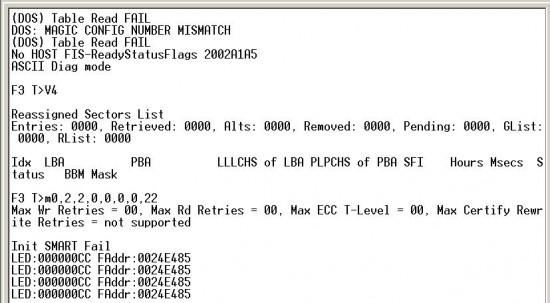

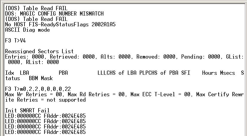

Location: Bogotá, D.C.
Please see image... hdd spin up but not show model and capacity.
Carlos

message error: INIT SMART FAIL in F3 1>N1

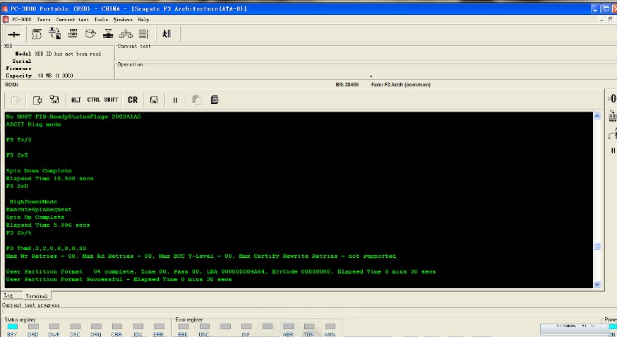

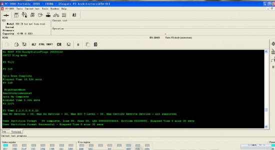

 Post subject: Re: Seagate 7200.12 ST3250318AS
PostPosted: November 10th, 2011, 0:15
Joined: May 15th, 2009, 3:27
Posts: 35
Location: China
Normal operation of my PC3000 Protable :(
