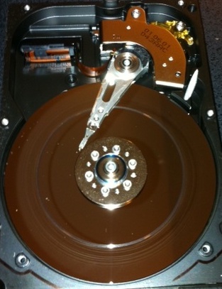

WD 40GB I saw with same symptoms 2 weeks ago.

@networks Wow. Mess.
@OP I agree with others, it's bad heads.
