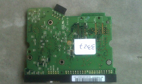

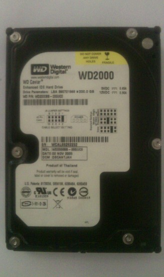

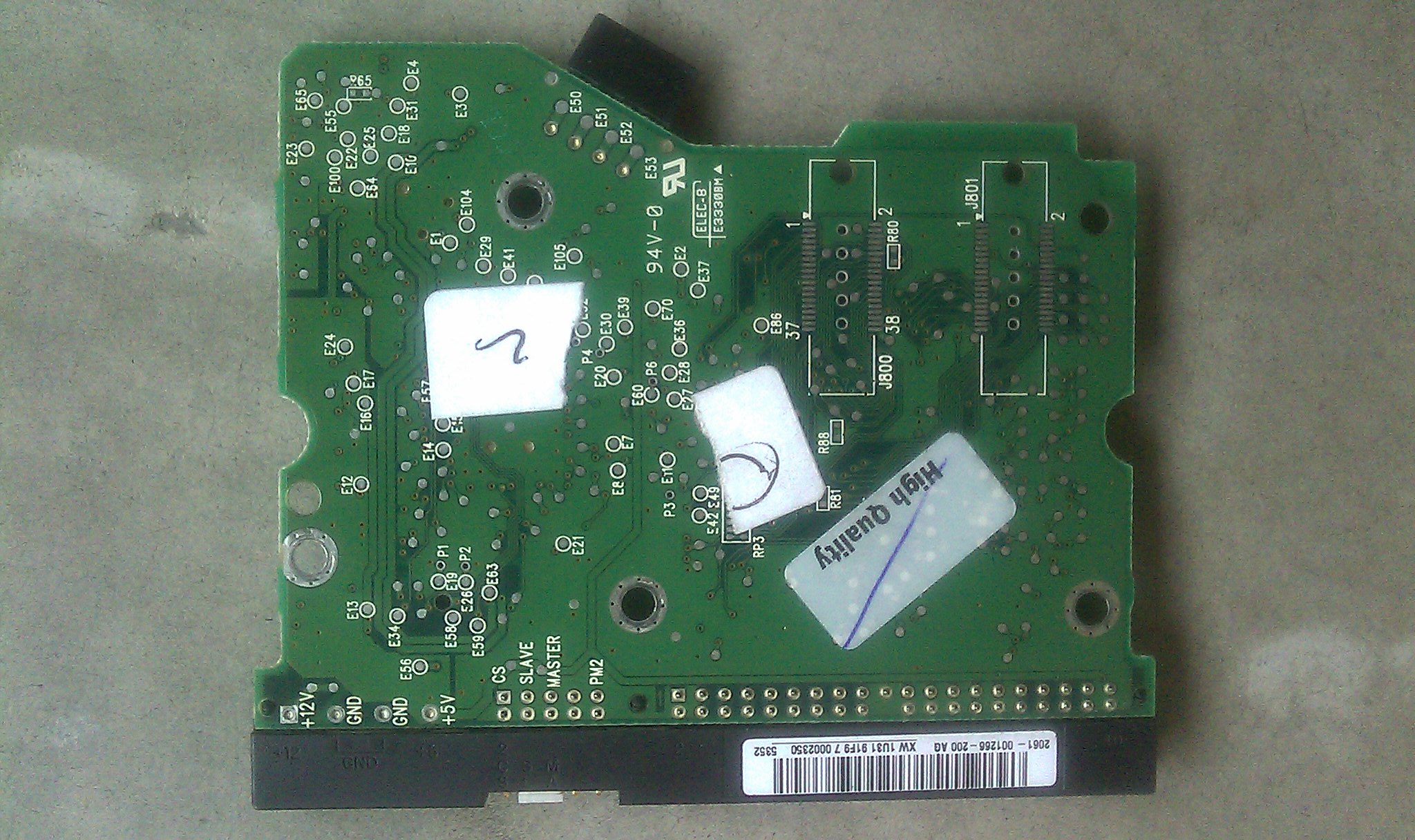

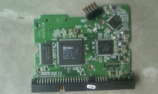

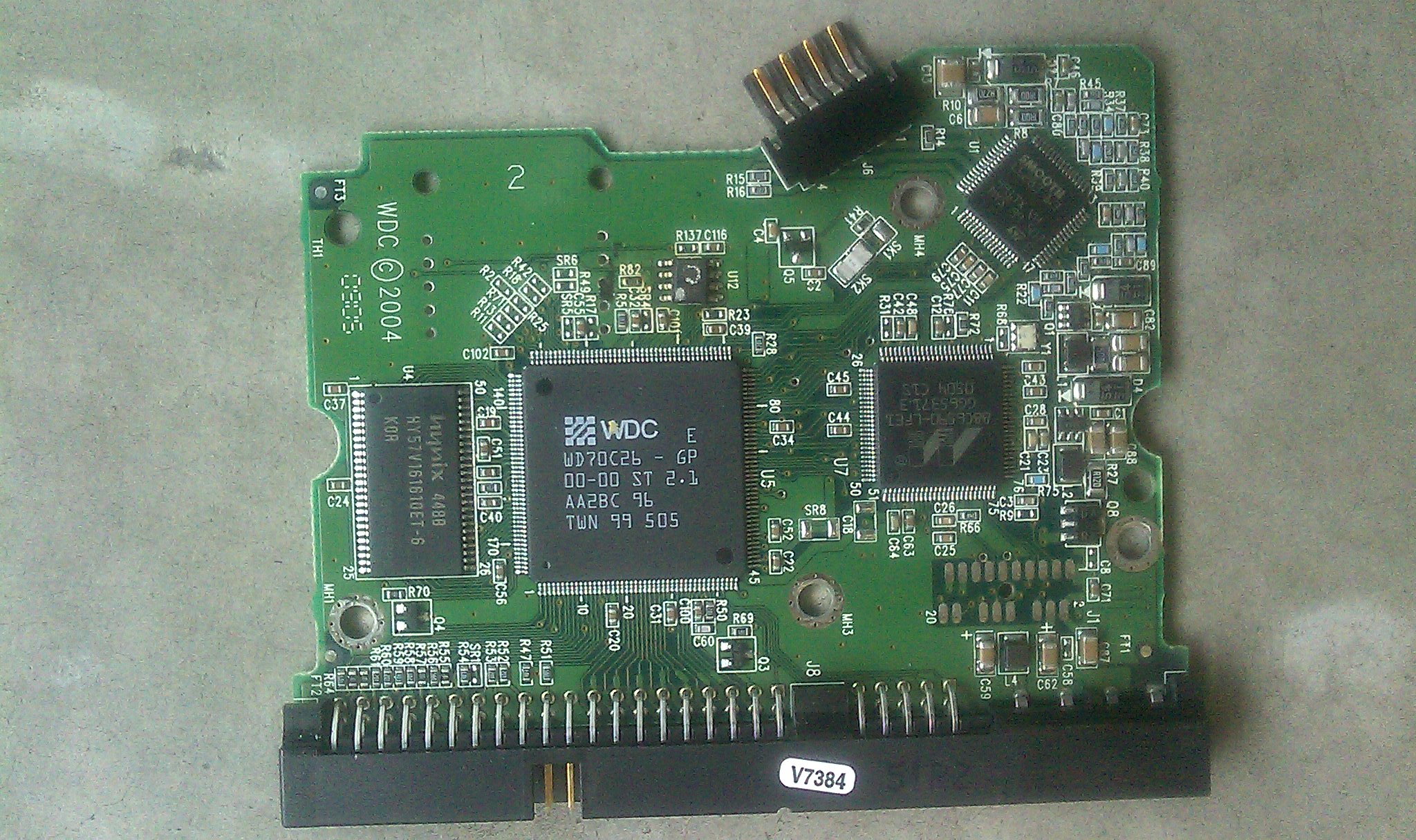

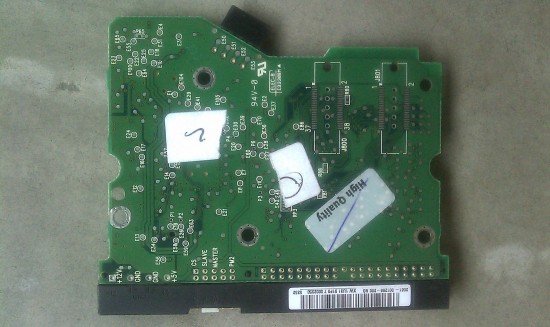

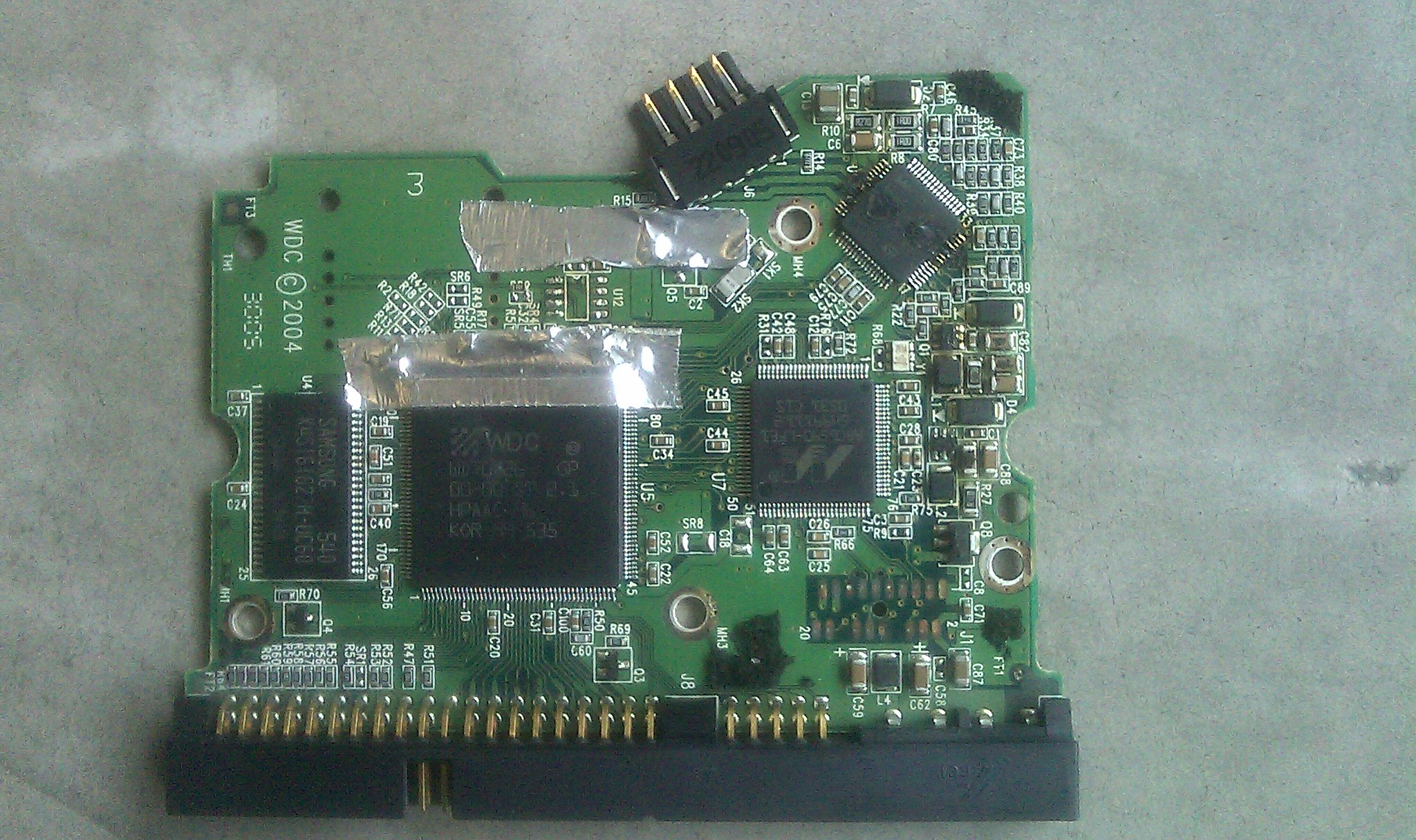

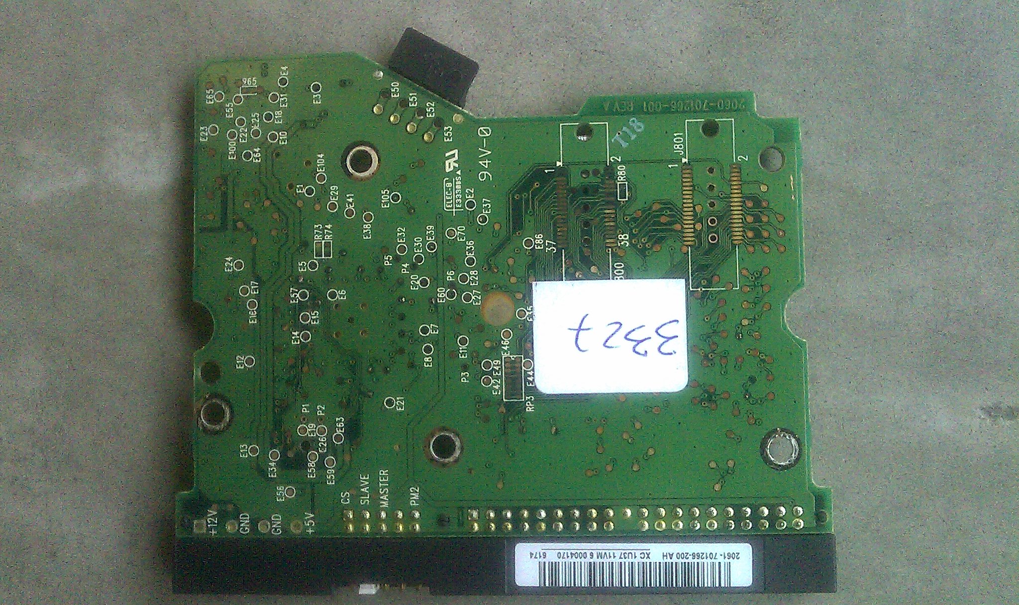

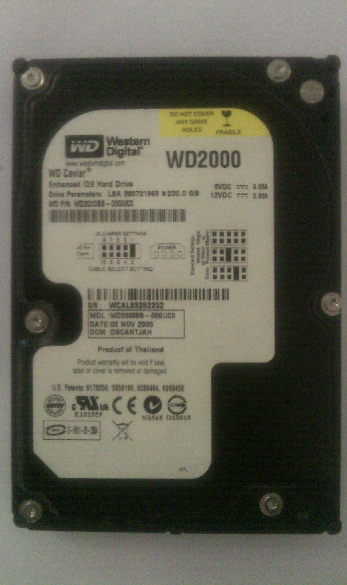

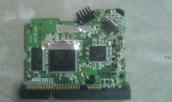

Many thanks for the replies. Attached are some pictures. Sorry if they are blurry, they were taken with a cellphone.
Fortunately, the ROM chip wasn't damaged, the guy did change it to the replacement board and the disk starts, but works as I described in original post i.e. partially, works via USB->IDE adapter but not in pure IDE, it delays reading, shows an LDM partition instead of NTFS. With surface tests it reads up to 75% of the disk and then it freezes and keeps retrying as if there are bad clusters.
To me, the problem is an incompatibility between the boards' models.
To the guy, the problem is on the heads/platters, due to the voltage peak they suffered.That was 'sniffy' to me, so that's why I ask the pros :)
Another possibility I'm shuffling is that the guy changed the partition type to LDM so that it would not mount under Windows... but this is just an speculation.
Thanks again!
File comment: Replacement board solder side
File comment: Replacement board comp side
File comment: Original board solder side
File comment: Original board comp side
File comment: The disk in question
Sorry no Flash Serial Chip "rom" on this board its contained within the large Chip "CPU" have to have Pro Tools to read the info and move to the new board. What is with the silver tape ? I hope thats not "conductive" it may have already "shorted" out the CPU
 Post subject: Re: Newbie on HDD world needs help with a WD2000 :)
PostPosted: March 6th, 2012, 12:13
Posts: 1749
Sorry, but I have to disagree with you. That the external flash ROM exist on this board. (U12). But anyway theres media damage beside burned PCB.
PostPosted: March 6th, 2012, 12:21
Posts: 260
Location: TN
My bad I was looking at the old board your correct I now see U12 on the new board
PostPosted: March 6th, 2012, 12:40
Joined: March 1st, 2012, 19:31
Posts: 9
Location: Buenos Aires
networks wrote:
The original board has the tape because it was used to protect the components to remove the ROM. The original board was not powered up anymore. The original ROM is on the replacement board.
@unknown: is it possible to get media damage after a burn like this?
I prefer to think that after such burning, it works or it doesn't. No mid-term, but maybe I'm wrong.
PostPosted: March 6th, 2012, 13:05
Posts: 1749
Yes its possible.
