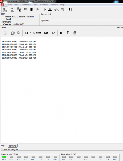

l'm working by pc3000 udma, continuous busy teminal. Help me :|
ST3000DM001
FW: CC4C
DATE: 12285
SİTE: SU

This HDD does not reach a suitable condition for repairs without intervention. You need to find a way to retain terminal access, only then you can attempt repair, assuming it is actually SA related.

yes the problem maybe SA, terminal busy continuous for l dont repear
