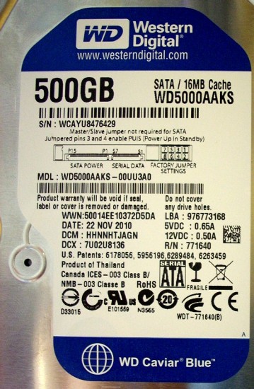

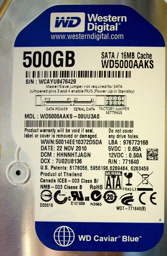

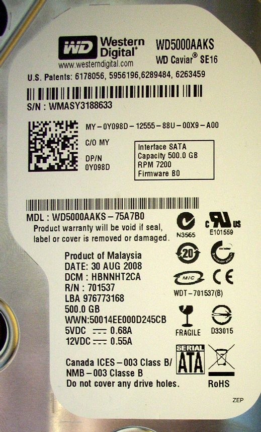

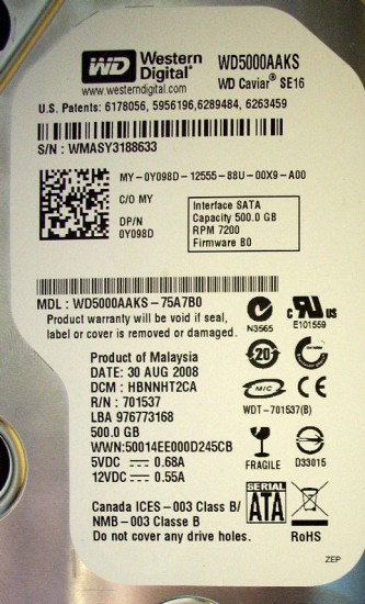

Since I am not sure just what info on the drives to provide, I am posting a pic of each drive's label.
The drive initially spin when plugged in, but stop after about 15 seconds. There is no clicking. The drives were not subjected to any drops, etc.

Both drives in the picture are of a different family...so, I don't think you can get the same PCB to work for both drives. As you say the drives spin, then spin down, you have eliminated the blown TVS out of the picture and are left with:
