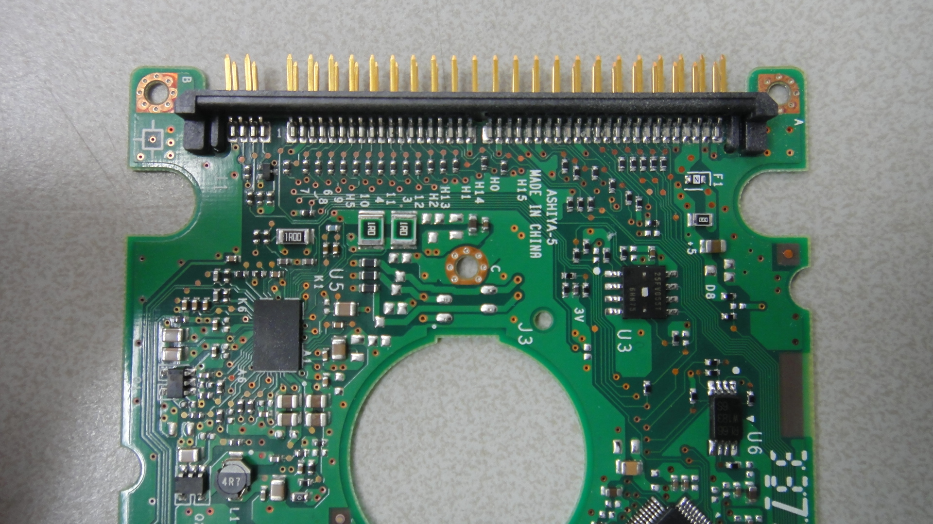

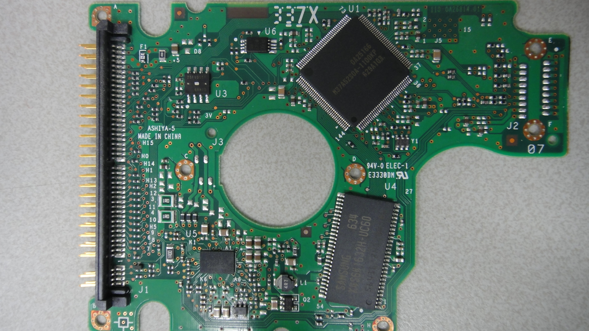

I have an Hitachi 2.5" IDE drive that is dead. The drive doesn't spin up when I attach it to the PC3000 or the Deepspar.
It is a HTS541212H9AT00 120GB MLC: DA1628.
I have trawled the usual sites looking for a donor drive, but cannot find one anywhere.
I haven't worked with one of these before, so have attached a couple of pictures of the PCB. Does anyone know if there is a fuse or TVS chip that I can remove/replace to get this working?
Any help would be much appreciated.

Check the fuse "F1" top right of first pic.
If that is OK then you need a new PCB, and move the NVRAM.
I almost certainly have a suitable PCB for this, PM me if interested.

Just to add to what has already been said, there appears to be no TVS diode (D8 is vacant). There is also a zero-ohm resistor below F1 that would be worth checking.

Thanks for the pointers. The fuse at F1 had blown, so I have ran some fuse wire across it to complete the circuit. The drive powers up and I am able to image it.
