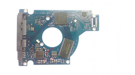

I have 2 disks Seagate Momentus 5400.6 160GB, model ST9160314AS. One of them working but second nothing happened after connecting to PC. I replace PCB with ROM chip between disks. And now I’m sure that problem is with PCB because after replace PCB working second disk but not working first.
I attached photo not working PCB. So I measured voltage in some points. In point 1 and 2 I have 5.05V. In point 3 I have 2.48V and in point 4 - 1.07V. In point 5 - 9.52V
All I measure one pin to the screw ring and send pin to point on the PCB.
Could you help me diagnose and repair PCB? What I should also check in the PCB?
Marcin

So, now you know, what's wrong with your HDD, it has something to do with the motor driver. Now you have to find out, why your voltage is lower.
 Post subject: Re: Repair PCB Seagate Momentus 5400.6 160GB, model ST916031
PostPosted: June 4th, 2016, 3:38
Posts: 17316
I'm not sure, but I think that test point #5 could be the boost voltage for the VCM. On a 3.5" drive this voltage is typically 18V or more, but I've never measured it on a 2.5" drive. In any case the voltage is higher than the 5V supply, so it seems to be working to some extent.
The other voltages appear to be Vcore (1.07V) and Vio (2.5V).

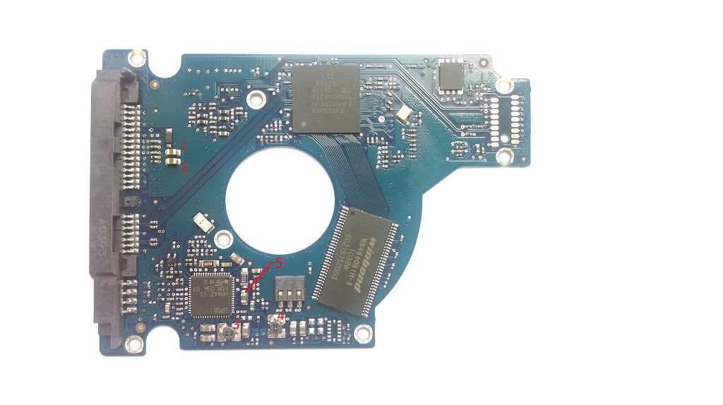

Try to measure the indicated test points when the PCB is on and off the drive. Compare with the good PCB. You will need to find the equivalent test points on the back of the PCB.

I measured this points. On the working disk with pcb on these 3 points I have 1.66V. But on the not working disk with pcb on these points I have 3.75V and these voltaga are changed.
PostPosted: June 6th, 2016, 16:55
Posts: 17316
If one of the terminal voltages had differed from the other two, then this would have pointed to a problem in one of the MOSFET drivers. This appears not to be the case.

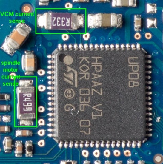

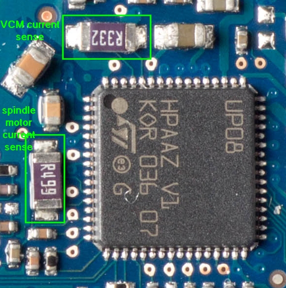

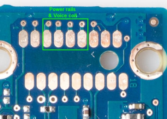

Thank you. Could you help me what I should check on my PCB? I uploaded photo my PCB with very high resolution. Maybe you can find me points and resistor which I should check.
PostPosted: June 7th, 2016, 16:55
Posts: 17316

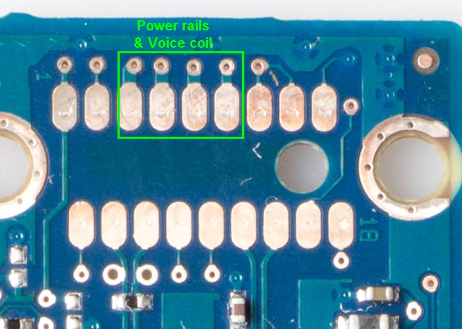

I suspect that R332 is an 0.33 ohm VCM current sense resistor and R499 is an 0.5 ohm spindle motor current sense resistor. If so, then R332 should be connected to the VCM pins of the HDA connector, and R499 should connect to ground. The pads adjacent to R499 should also connect to the motor terminals.
If you can confirm that R499 does indeed connect to ground, then you can measure the voltage across it when the drive is trying to start. This will tell us how much current the motor is drawing and whether the motor controller is trying to spin the motor.
If you confirm that the motor is trying to start, then try adding an 0.5 ohm resistor in parallel with R499. The combined resistance will then be 0.25 ohm.

I think at the beginning me recovery learning it is to hard for me:(
In my opinion resistor R499 isn't connected to ground. Also I replace resistor R499 from another PCB but drive still don't work.
Maybe I will star another learning case.
PostPosted: June 8th, 2016, 13:48
Posts: 17316
Sorry, if R499 is not grounded, then I don't understand its function. It would appear that the motor controller IC senses the motor current internally. I don't know where to go from here. :-(
If you wish to learn about the electronics, I would suggest an old Maxtor DiamondMax Plus 9. It has numerous test points which are labelled, plus it uses a well documented L7250 SMOOTH motor controller.
