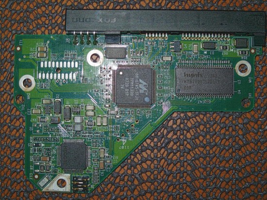

After ordering and receiving an exact PCB replacement
WD3200AAKS-00VYA0 model,
I swapped the PCBs and the HDD started to spin up....
Although the computer BIOS did detect "something" it does not give the correct size ( 0 Gb ) ...
It does not give and inidication of the "WD32xxxx" initial string nor any serial ...
Was it supposed to happen like this ?
What is the next step in order to "revitalize" the HDD ?
Do I need a TTL cable ?

You need to swap the ROM (U12 Chip) on your old PCB to the new one. Post a photo of your PCB and we can help you identify the right chip that you need to swap.
TTL cable won't work with Western Digital because it doesn't use terminal.

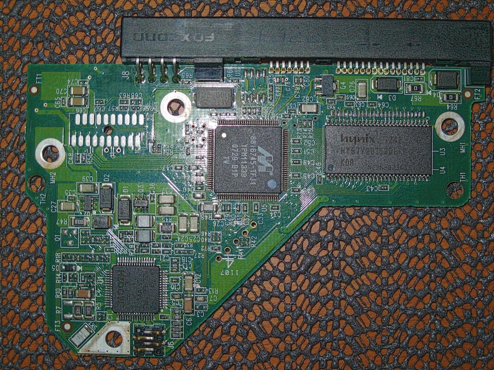

AS requested here is the "bad" PCB photo ...
Apparently there is no visible damage so what could be wrong ?
File comment: Bad PCB

ROM on this PCB is embended
measure diodes and 0 ohm resistor

It seems that the "D3" and "D4" diodes have different from 0.0 Ohm values ...
Were all of them supposed to have 0.0 Ohm ?
Any ideas are appreciated ...
 Post subject: Re: WD3200AAKS Dead
PostPosted: August 26th, 2016, 14:47
Easiest way is to select continuity mode on your MM, one that "beeps" on continuity.
R64 and R67 should beep, D3 and D4 should NOT beep.
