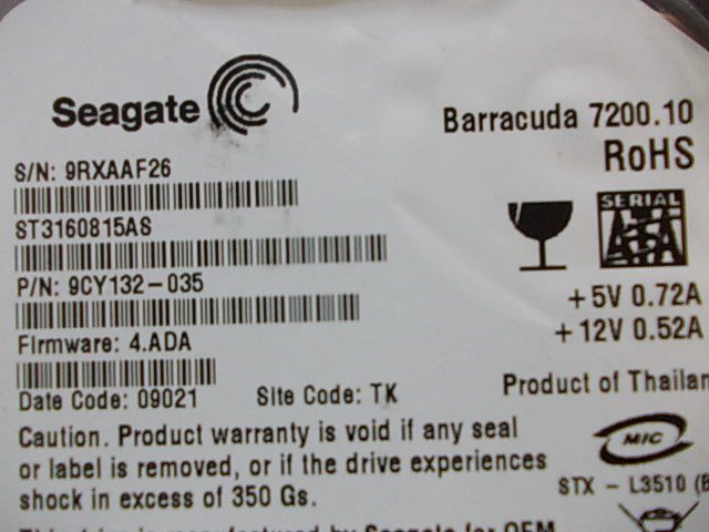

What to watch for if I want to swap the HDD platter?
example;

Well ... this is my hd.
motors run unstable, first slowly, sometimes stopping for a moment, if I jiggle or agency or shake at body hd it will spin faster. hd is not detect in the bios, can you analyze this event, thank you before

The only time a platter swap is needed is if the motor is bad.
The first thing to "watch for" is to make sure your diagnosis is correct. With Seagates the motors usually spin up or they are locked. I doubt you have a motor issue.

IMHO the starting point is to research on crafting together a way to connect to a machine so you can check the drive's terminal output. You can search here on the forum or Google it using keywords such as "seagate terminal" for example. Plenty of info available to guide you.
