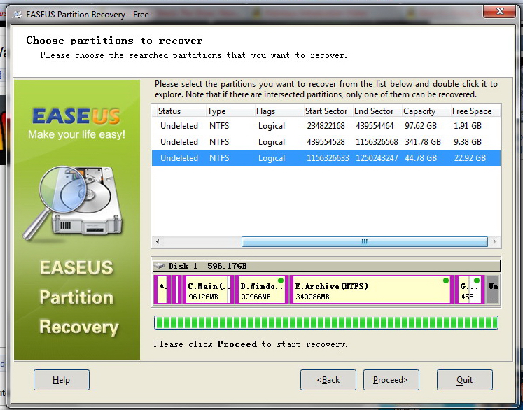

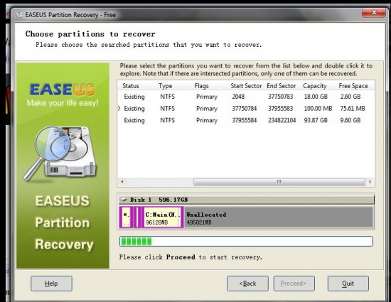

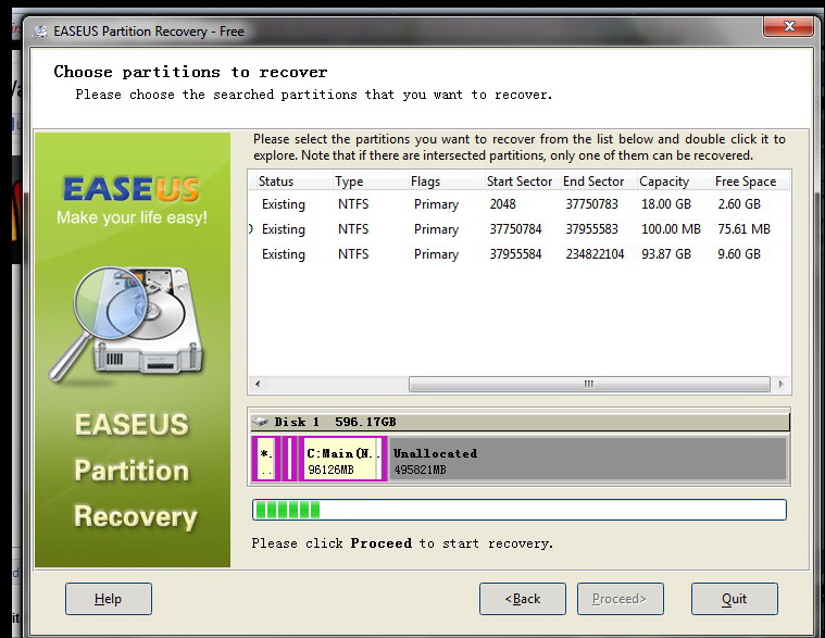

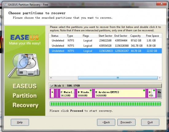

Anyway, I downloaded and tried two partition recovery utilities.
Active Partition Recovery instantly found all three partitions and stated they were recoverable. So, I bought the program and unlocked it but when I select recover from the highlighted partition, I get a message stating "unable to write sectors to the device" andcan go no further. I am still waiting to hear back from them. There are two other options in this program to use, one creates a typical MBR and the other is Fix Boot Sector. Both are irreversible and I am hesitant to use them.
The other program is Freeware - EASEUS Partition Recovery. It, like the Windows partition tool, scans the hard drive and sees the hidden paritions and calls them 'UnallocatedSpace". When I tell EASEUS to scan the allocated space for lost partitions, it too finds all three and says they are 'undeletable'. However, when I tell it to undelete them, it proceeds and returns a success message but upon reboot, the partition are still not there.
Both programs give me the option to browse the partitions that are recoverable and when I do, I can see ALL of the files are there and untouched. It's a 1 TB drive that is 80% full so I cannot salvage these files and reinstall the partition. I'm afraid to take a further step without expert advice as I know how fragile the MBR etc. is. I know I made a boot CDfor win7 after I bought it but I'll be damned if I can find it. I know I didn't make a repair CD (at least I cannot recall).

I'd recommend you the following:
1. Stop trying to recover the partitions "on-site", obviously that won't give you any good but further damage the data.
2. Get a large external USB disk, maybe borrow it from a friend for a couple of days.
3. Use R-Studio Startup disk and recover files from the partitions to the borrowed disk. This article will help you with this procedure: Emergency File Recovery Using R-Studio Emergency. Most likely, you'll be able to preserve the original folder tree.
4. Reinstall the system and other partitions from the system recover disk.
5. Copy the files back to their partitions.
6. Return the external hard disk to its owner, if necessary

Thanks to both of you. After spending far too much time already with this problem, I have already started backing up files.
Yesterday, I managed to find the starting and ending sector numbers for the partition and was convinced that it was simply a matter of writing this back into the MBR. The reason why is years ago, the identical problem happened to me and i found some guy on the internet from Sweden on a forum like this. He sent me a little DOS program that did something to see where the recoverable partitions were. I mailed him back the log and he wrote a batch file that took all of 3 seconds to run and voila!, everything back to normal. I was SO hoping that would happen here.
For the record, I have not been making any changes to the system, just passive scans. And, I have been using a back up laptop for internet work.
someone suggested a program called Testdisk and I've tried it. It comes back with something wonky for ONE of the partitions and through that, I noticed that the sector values I found had gaps between them. This - along with otheradvice was enough to convince me to back up the partitions. This is was laborious for me at the start since it required me to take to smaller backup external drives and shift data around but, if i had of done this 2 days ago, i'd have been done by now.

Ohhh, Vulcan, I am still very interested in your advice; there is no reason to believe this will never happen again.
I was basing my reply regarding the direction I am taking as the 'safest option'. Once I have backed up everything, I still intend to attempt some risky trial-and-error "learn the hard way" methods. Right now I am using EASEUS data recovery to save 500 G worth of data. Then, I'd like to see if I can still somehow restore the partitions without using a partition program to redefine new ones and copy data back. If you can provide direction, that would be much appreciated!
