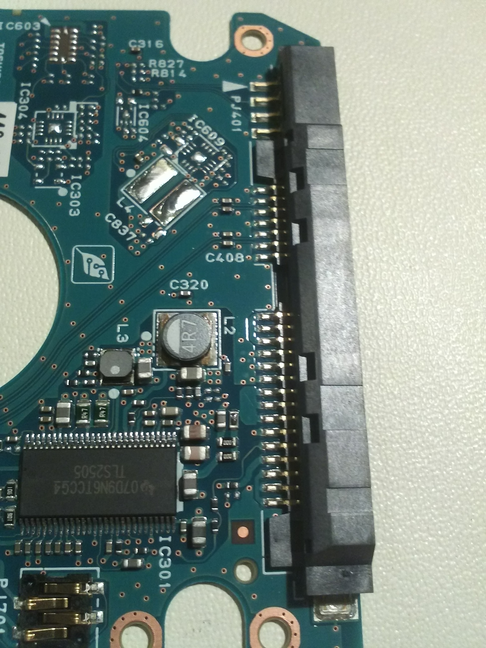

Hi all,
Could someone please assist with highlighting fuse/s on this PCB that can be tested before swapping over PCB and ROM, original PCB seems dead.

Nick_CT wrote:
Hi all,
Nick .
Have you tested that resistor above the two horizontal resistances you have in this pcb .I seem to sense its burned :mrgreen: .Might be it has not but increased the resistance
 Post subject: Re: Toshiba PCB fuse
PostPosted: March 19th, 2012, 18:15
Posts: 17262
That appears to be a fuse, not a resistor, probably 2A or 4A. If so, then its resistance would be either 0 ohms, or it may have increased to infinity.
@Nick_CT, as a general rule, the very first place to look for a fuse would be the +5V input. That's pins 7, 8, and 9 of the SATA power connector.
I would also check for a short circuit between the load side of each zero-ohm resistor and ground. Then measure the resistance between each coil and ground. The coils are the landmarks for the onboard supplies.

Thanks, will investigate.
