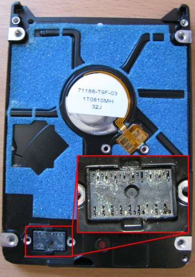

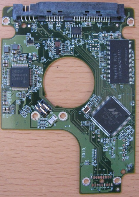

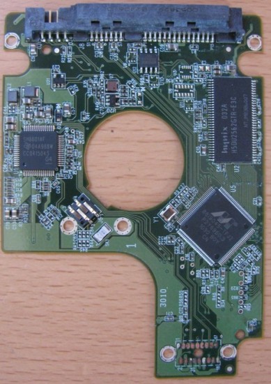

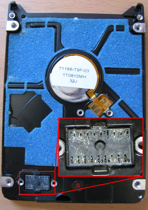

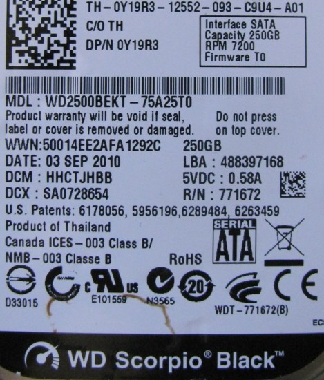

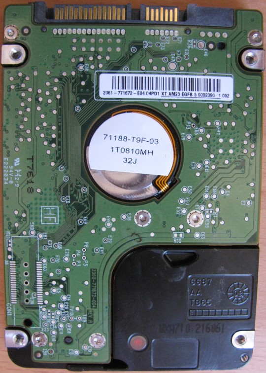

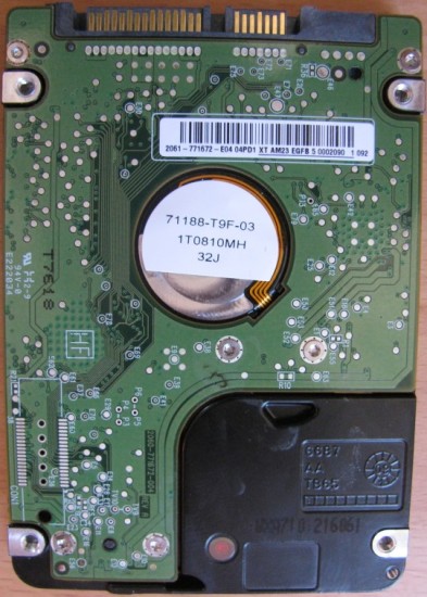

Liquid damaged WD Scorpio Black 250GB. Drive powers on but clicks. Heavy corrosion of the pins on the bottom of drive (see detailed pic attached). Any thoughts on the potential of cleaning the pins and doing a PCB swap?
File comment: Close up of corrosion
File comment: PCB
File comment: Bottom
File comment: Label

the pins go directly to your preamplifier and the heads, there is a pretty good chance that the head stack will have to be replaced.
 Post subject: Re: Liquid Damaged WD Scorpio Black
PostPosted: March 24th, 2012, 19:41
Posts: 17216
If you wish to try a PCB, then you will need to transfer the chip at U12 to your replacement board.
Otherwise try cleaning the preamp pads on the PCB with metal polish (eg Brasso) and a cotton bud. This works well with other electronic devices, but I have never tried it on a HDD PCB. Use isopropyl alcohol (audio/video tape head cleaner) and a toothbrush to clean up afterwards.
