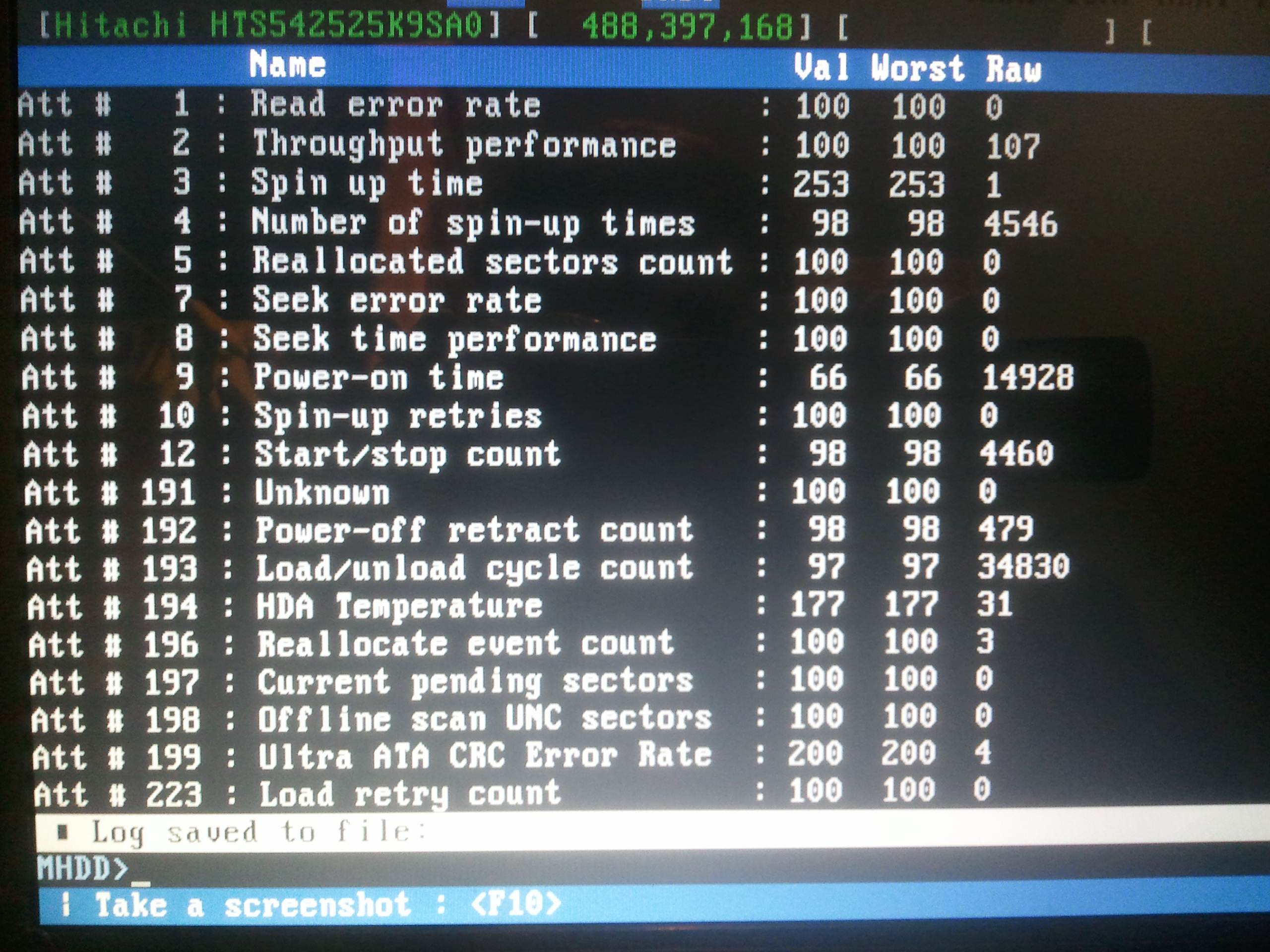

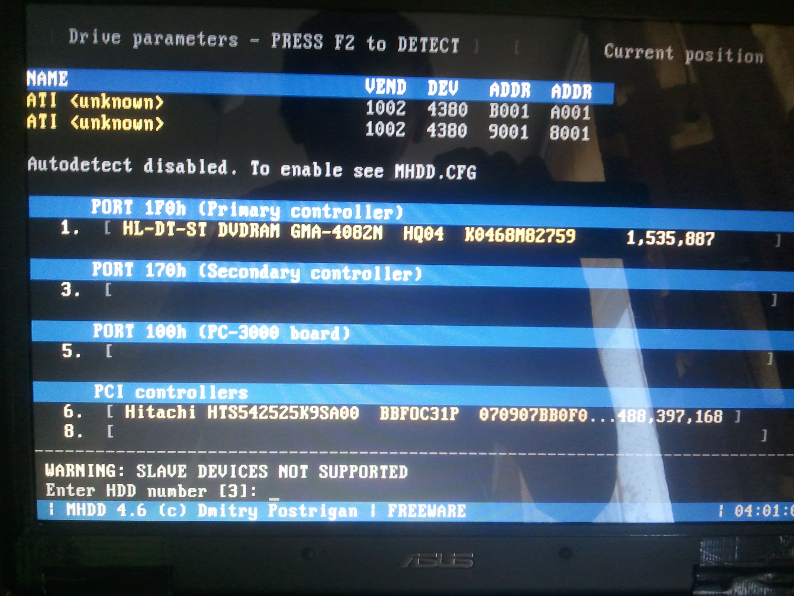

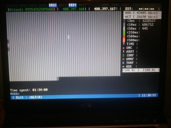

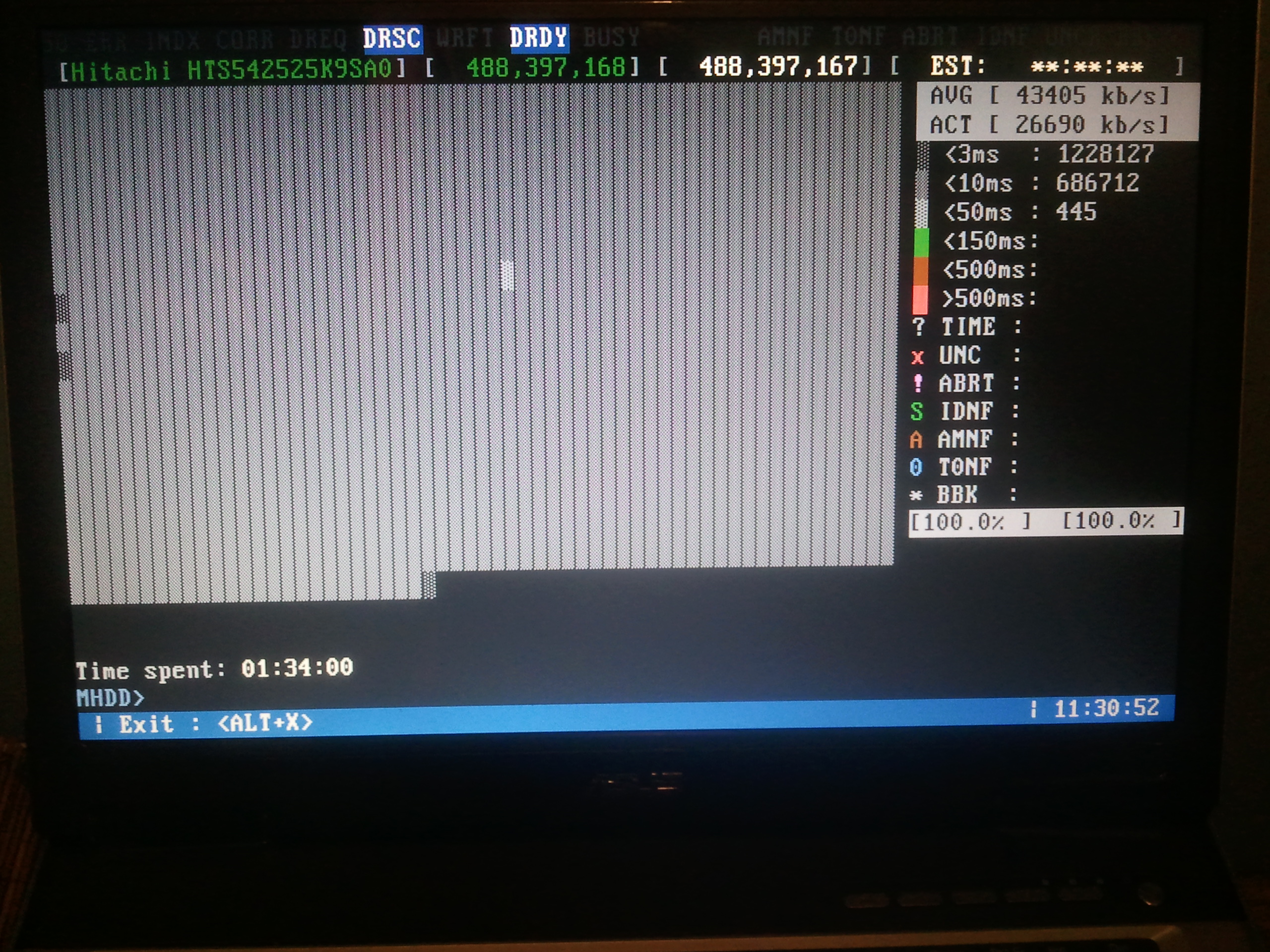

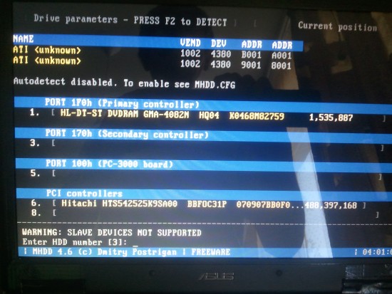

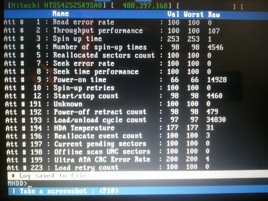

I tried MHDD and found it out working. But there is a wierd thing, I mean in the port selection, it show that HDD is on PCI port. Is that the same on Victoria? Well, this test was executed on same laptop because I don't have a PC to test it at the moment but I hope it will show something useful or whatever that can be worked on. Thank you for pointing me.

Thanks for the screenshots.
I think that means your laptop SATA controller is in AHCI mode. You are lucky, some SATA controllers in that mode can be used by MHDD. Some other SATA controller can only be used by MHDD when they are switched to IDE / legacy / compatibility mode in the BIOS.
The MHDD scan results show no unreadable sectors.
The SMART results show that there have been 3 previously unreadable sectors, but none were reallocated, and no sectors are known by the drive to be unreadable now.
Therefore I see no evidence of a fault with that disk drive. Based on this evidence you have given, your problems with OS installation etc. are likely to be caused by fault(s) elsewhere on the PC. When you can connect that disk to a known-good PC, then you can perform further tests, without worrying whether any problems are caused by the PC or not.
