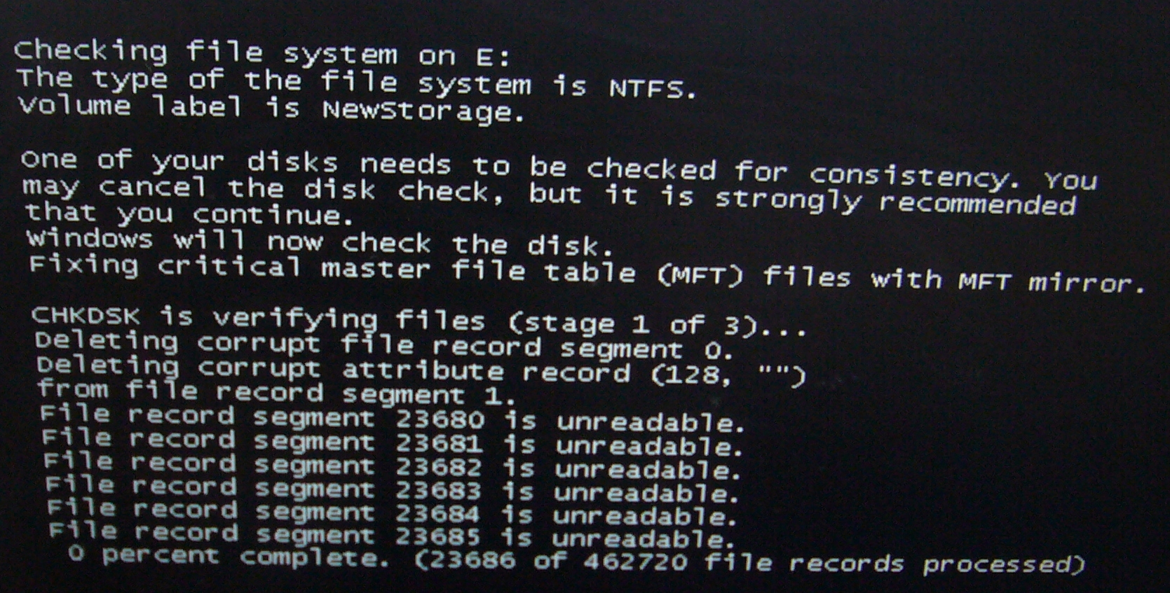

Hello all,
I have been watching the forum for a while, and now I need help with a problem of my own.
A second HD attached to the computer failed. After I restarted the computer, chkdsk started to run immediately. It shows some scary errors (see attachment):
File comment: HD failure
"Fixing critical master file table (MFT) files with MFT mirror.
Deleting corrupt file record segment
Deleting corrupt attribute record
File record segment * is unreadable"
The HD is a 2TB one with important data. If I knew that the HD was so bad I would not allow chkdsk to run.
I let chkdsk run because I do not want to make matters worse by cycling power. Chkdsk showed a very long listing of unreadable file record segments.
The file is not accessible. There are no clicking or grinding sounds.
Unfortunately, my funds are limited (isn't it always).
I have the followig questions for the knowledgeable folks on this forum:
1) What is the requirement for me to start sending PM's? I have a member who is close to me who I have in mind for this job.
2) How do you guys find out whether the problem is due to a logical or a hardware problem without opening up the HD?
3) Should I trust someone who can only do logical recovery, or should I go with a super-expensive solution like the "top" HD recovery firms who open up the drive?
4) Are sectors of this HD physically unreadable, or is chkdsk panicking?
5) What is the best way to clone this HD while trying to read data from the presumably bad sectors without doing more damage to the HD? Or should I let a specialist work on the original HD?
6) What experience do you have when an MFT mirror must be substituted?
I know enough about the subject to be dangerous. My plan is to:
1) If needed, create a clone HD
2) Determine if the HD has physical damage
3) Have a logical-recovery firm do data recovery.
My only problem is that I need a complete data recovery, and not a file signature-based one.
Thank you for your time.

I'll just answer a couple of your questions, and leave a few for other people :)
I believe you need to have 5 approved postings, although I'm not in charge of the board, so that number could have changed. If you know who you want to contact, you could place a posting in this thread, asking that member to send a PM to you with their contact details - but you're not far away from that number of postings, so you can test my theory soon :)
Based on those error messages, yes, there are unreadable sectors, when accessed with the Windows driver behaviour (timeout, retry count etc.).
IMHO whether your suggested plan is sensible depends on the value of the data to you, and your attitude to risk, especially if you attempt any parts of that plan yourself. Cloning a drive is not risk-free, and you now know that the drive (or, very unlikely, some other part of your PC) has hardware problems, causing sectors to be unreadable (as I mention above).
It's fine for that to be your target, but whether that is possible after whatever chkdsk has done as well as the problems with the drive, is a completely different question. :(

MKRD.info wrote:
the data is CRITICAL for me
OK, so no DIY :) That wasn't clear to me from your plan - it seemed like you were going to do steps 1 & 2, and only use a DR company for step 3.
MKRD.info wrote:
Another question then: is there a better program I should trust more than chkdsk and which does not act so carelessly with my data? I mean, as a general replacement for a chkdsk scan.
No - chkdsk does exactly what it is supposed to do, which is to make filesystem metadata internally consistent. If chkdsk wasn't there, and the filesystem metadata was corrupted (i.e. inconsistent, due to lost writes etc.), you might try to read file X, and get the contents of file Y - you don't want that, do you?!
IMHO your real problem is not with chkdsk - your problem is not having a backup, and then having a disk fail in such a way that caused Windows to believe the filesystem was not clean, so it ran chkdsk (actually autochk, which is the boot time equivalent of chkdsk, when I last looked into this).
MKRD.info wrote:
And another question: What is the difference in methods and software used between a local logical recovery firm and an expensive one like Ontrack and DriveSavers?
I'll leave that question for one of the DR pros, if they choose to answer you. Apart from the obvious differences (i.e. no physical work done by a "logical recovery firm"), you don't specify which "methods and software" are being used by the "local logical recovery firm". Therefore personally I think you are asking a hypothetical question which is impossible to answer accurately, because you're not providing all of the necessary information to make a comparison.
