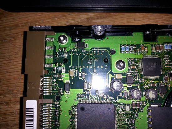

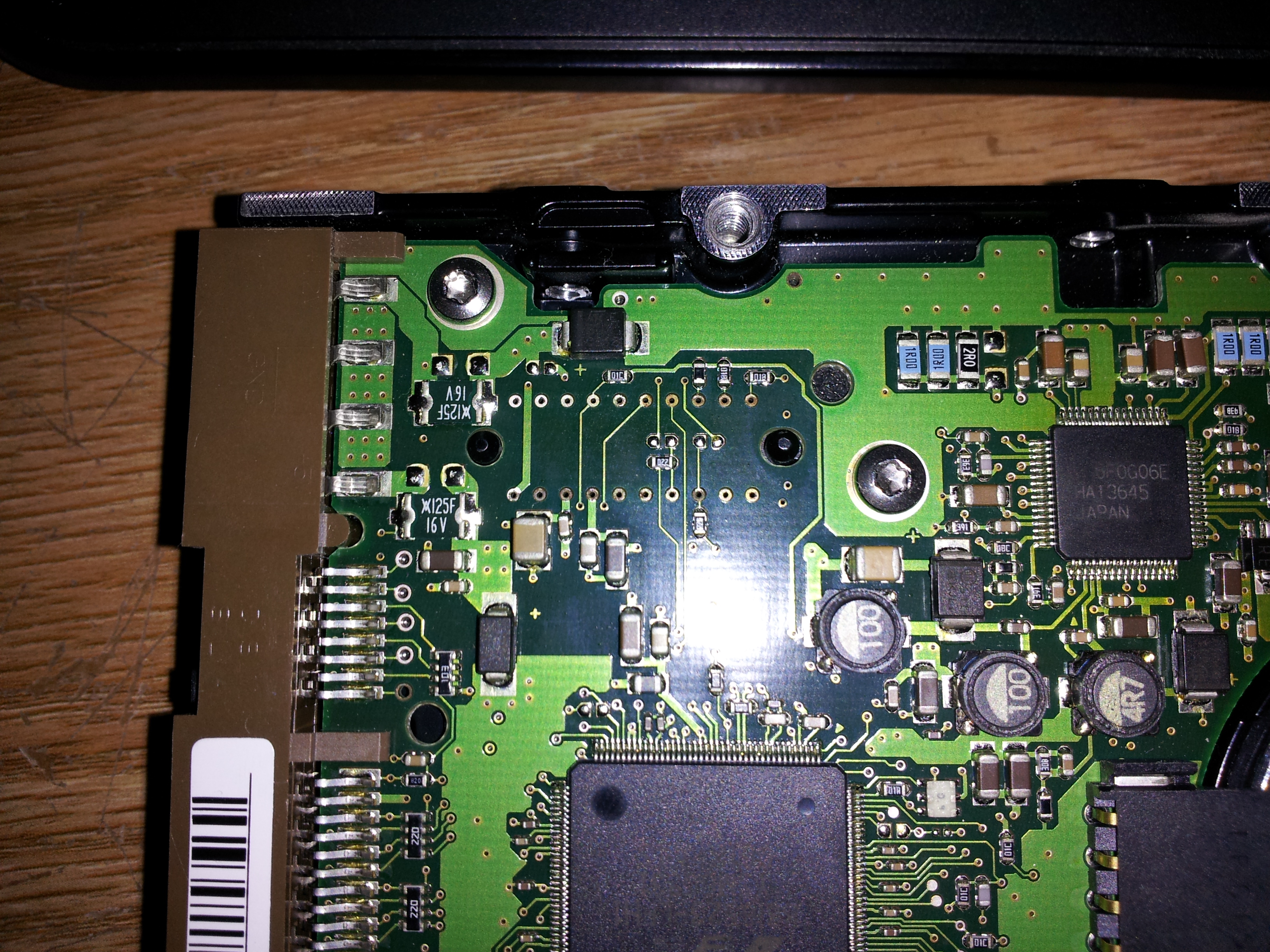

Thanks for the good info. I'm looking back and my kids may have plugged the laptop power cord into the enclosure. I looked at the drive but see no physical damage. When I search online most show physical damage (Burn marks), Is it possible that the TVS tripped with no visual sign of it tripping? I'm attaching images of the disk.
Thanks,
BlueKalel

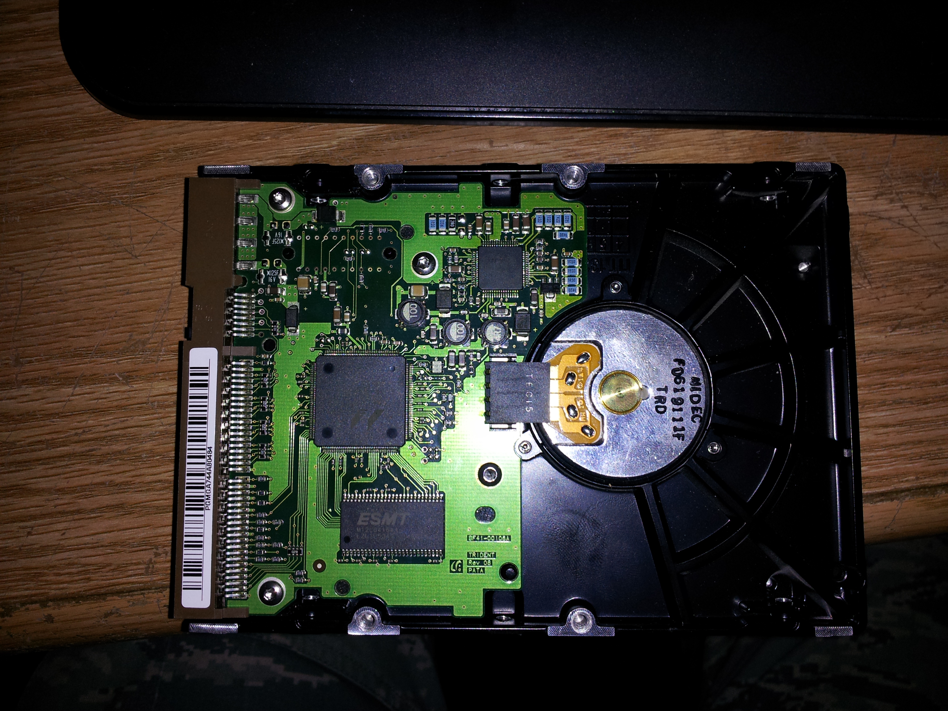

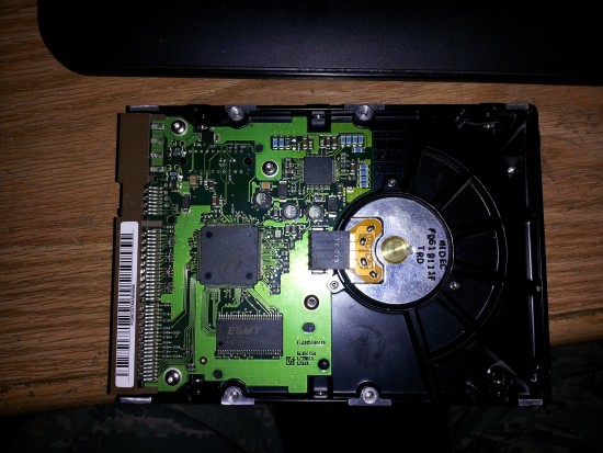

File comment: TVS location
File comment: Picture of full drive

Yes, it's certainly possible.
check with volt meter and if it is bad remove it and see if it can spin up again if not the motor controller could be bad or even the preamp. Try the volt meter first to see what your readings are
Iorana Haraharaini
 Post subject: Re: Samsung dead HELP!
PostPosted: January 5th, 2012, 4:45
Posts: 17213
The 125F devices are polyswitches. They behave like resettable fuses. If either TVS is shorted, then the associated polyswitch goes open when power is applied.
miniSMDC125F/16, 1.25Amp, PolySwitch, Raychem Circuit Protection:
http://www1.futureelectronics.com/doc/R ... __16-2.pdf
http://www.anglia.com/raychem/datasheets/187_216.pdf

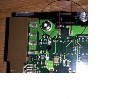

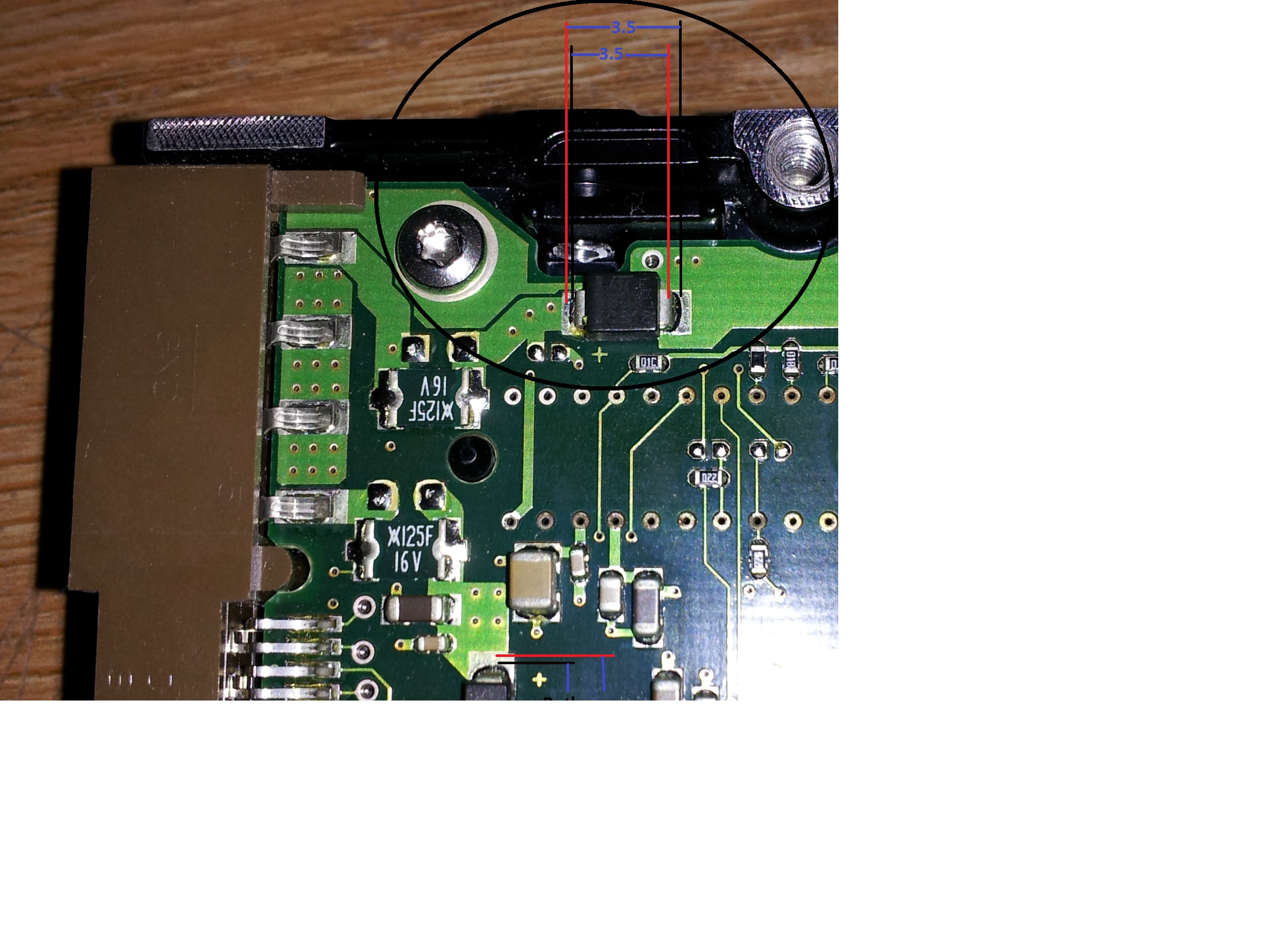

OK so I went to the store today and got a digital multimeter. I attached 2 pics that show what I measured.
First I measured the bigger TVS black on + and got 3.5 back. I reversed and (red on +) and got 3.5.
Next I measured the smaller TVS black on + and got 1 (not .1 or 1.0). I reversed and got 1 again.
I went ahead and did the same for the X125F both are reading .5 both directions.
I followed the directions in the TVS FAQ. Set the OHM to 200 and these are the numbers I got.
So what do you guys think. Does the 1 mean its open, no continuity?
Thanks,
BlueKalel
File comment: Smaller TVS
File comment: Larger TVS
PostPosted: January 6th, 2012, 15:42
Posts: 17213
The large TVS is shorted. Remove it and you should be OK, provided that there is no other damage. Just be absolutely certain your PSU is OK, as you will no longer have any overvoltage protection on the +12V supply.

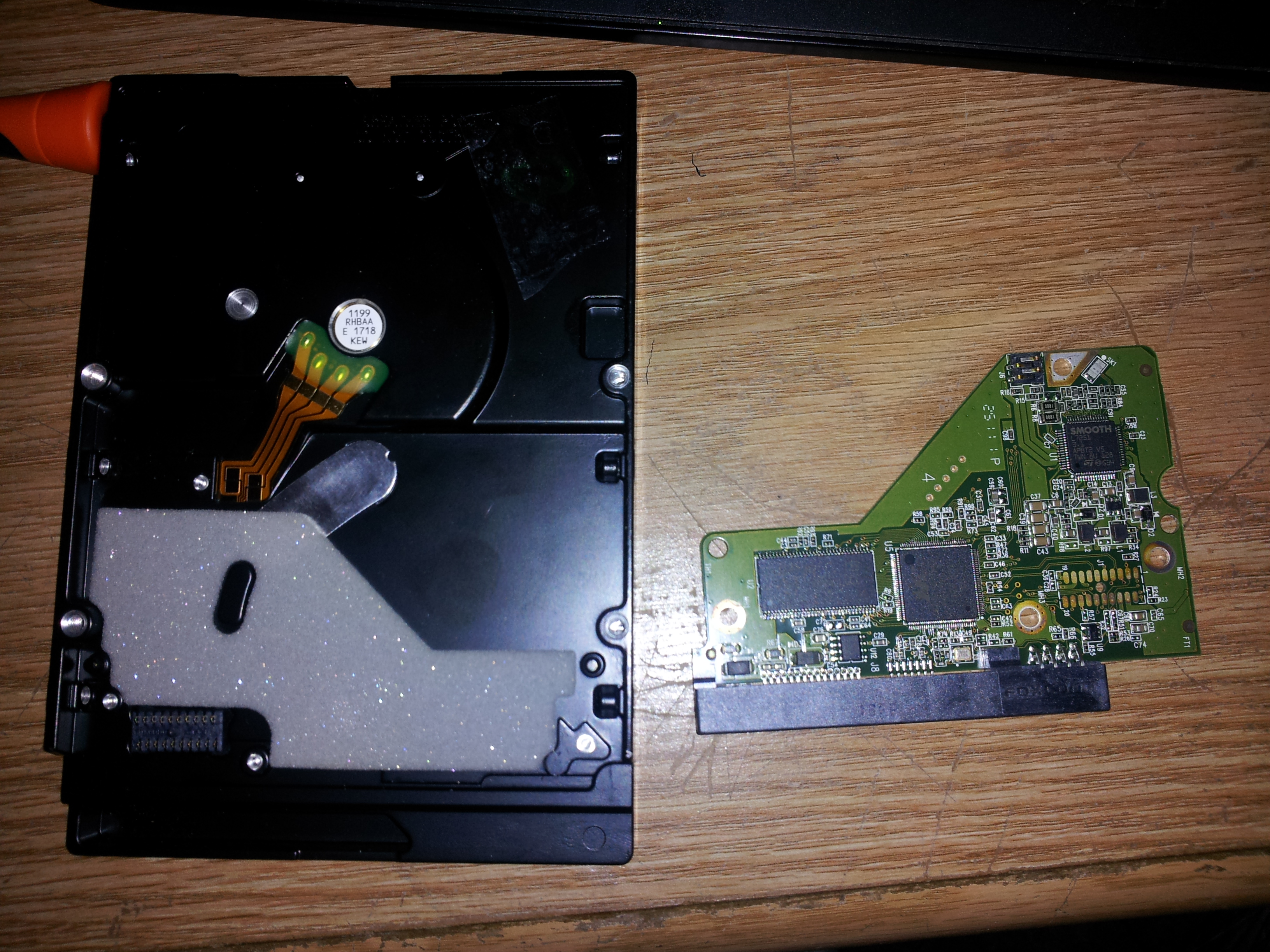

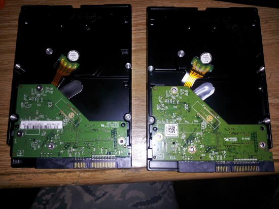

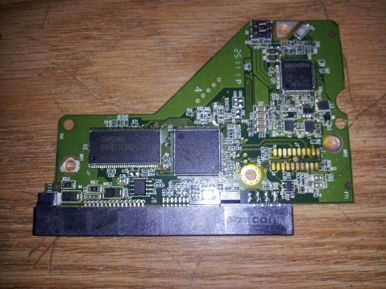

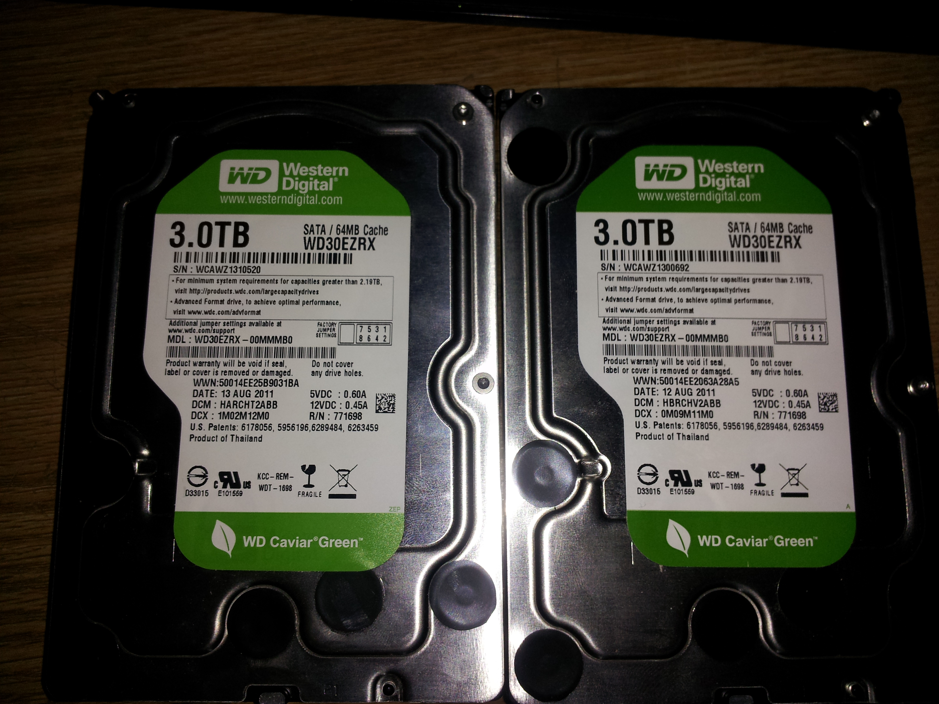

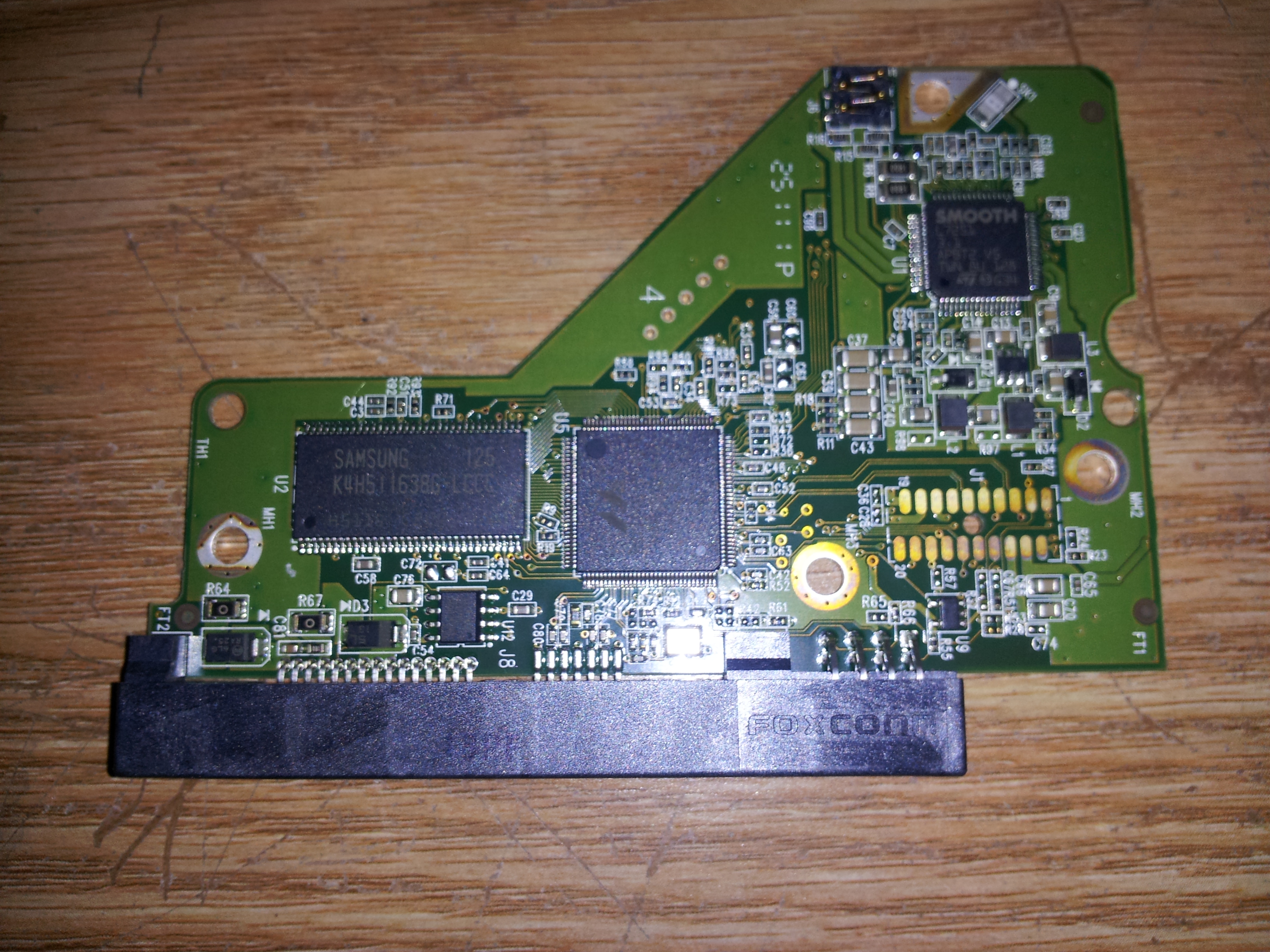

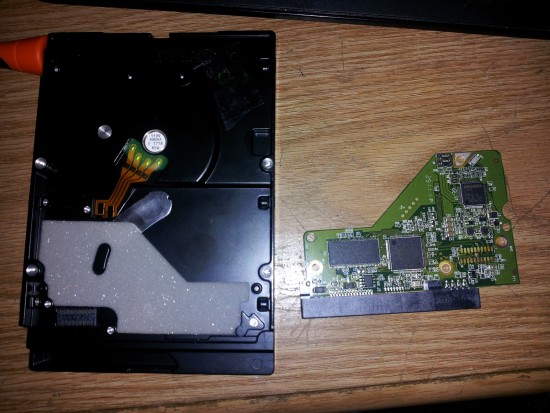

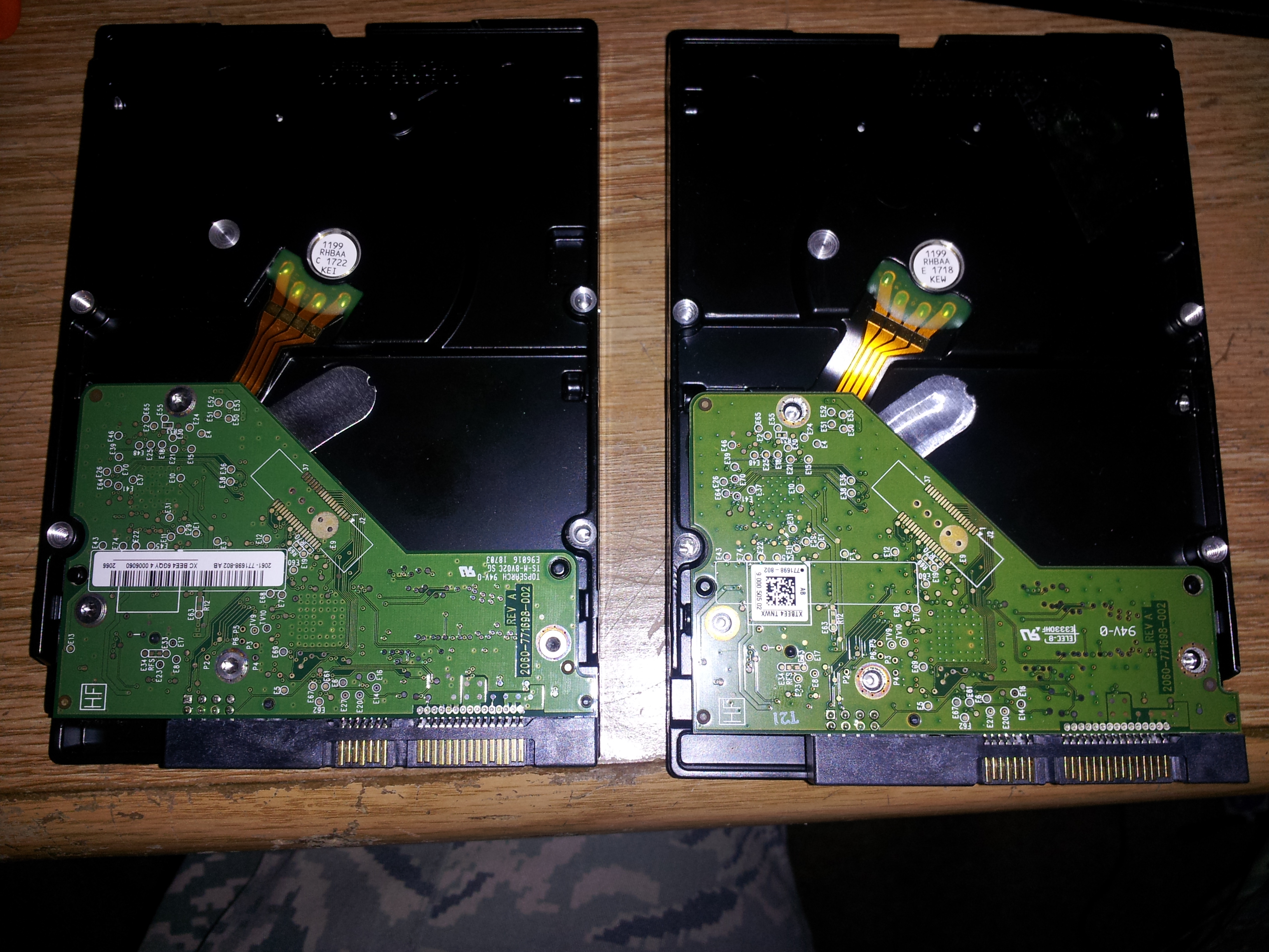

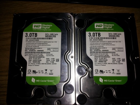

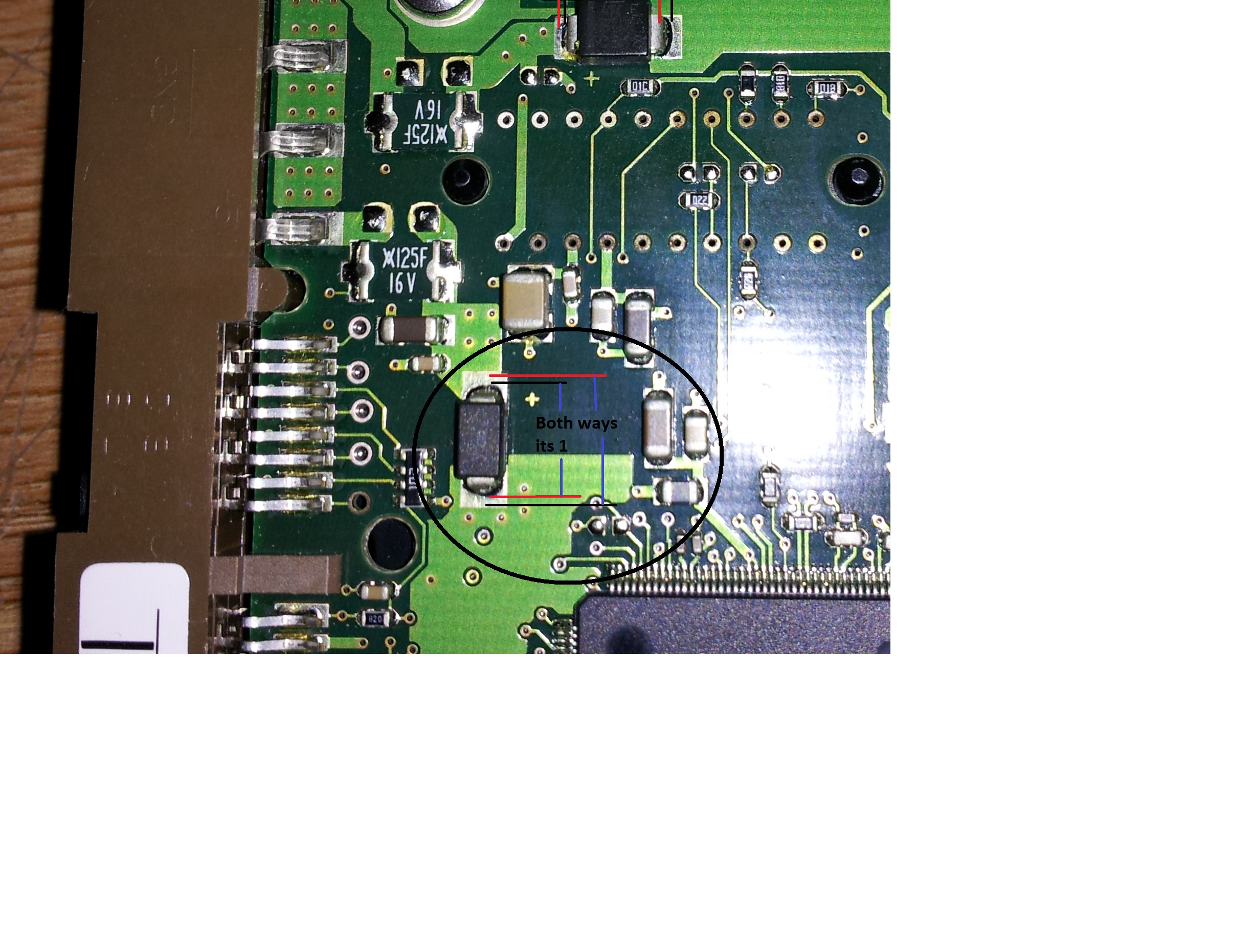

Now I have a new problem that's related to this, and I hope someone can help. Last night we had a major storm and knocked out the power 2 times back to back. This morning I checked one of my hard drives, a My Book Essential 3TB drive. It just continues to blink and never spins up, no noise nothing. I checked what I believe is the 5V TVS on the PCB and my meter shows a "1". I can't find the 12V though. Also I have 2 identical drives bought at the same time, pics below. Can I swap the PCB? If so what should I look for?
Thanks,
BlueKalel
PostPosted: March 20th, 2012, 21:50
Would try to clean the oxidized HDA contacts. Search on the forum to see how.
PostPosted: March 20th, 2012, 21:55
Posts: 17213
The 12V TVS diode is at the bottom left corner of the last photo, adjacent to resistor R64.
In the worst case, if you need to replace the board, then transfer the chip at U12 from patient to donor.
PostPosted: March 20th, 2012, 22:00
Joined: December 31st, 2011, 21:58
Posts: 17

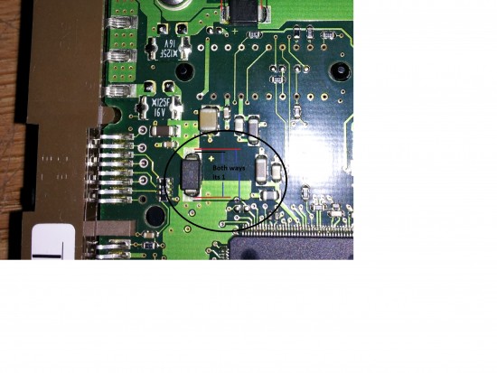

If both 12V and 5V show "1" on the multimeter does that mean its not a blown TVS?
BlueKalel
