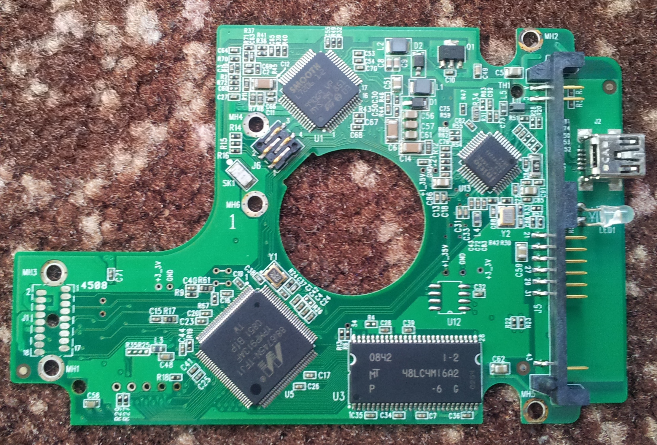

I have western digital 320 GB hard usb 2.0(Thailand made ) .When I connect this to the port it gives me error usb device not recognized .I have another drive similar to this older then this but made in Malaysia swap the logic board and found out the drive is ok detecting by the pc but no data is recognized I believe i need also to change the bios chip from faulty WD .
For my faulty logic board I suspect my TVS diode has sacrifice itself can any one help me on this to trouble shoot my logic board TVS diode replacement .

You could check whether the USB-SATA bridge chip is functioning properly by carefully desoldering and lifting the clock or data pin of its associated flash memory chip. I believe this flash chip will be the IC adjacent to U12. It stores the bridge firmware. If the bridge can't find its firmware, then it reverts to identifying itself with its factory Product and Vendor IDs, ie Initio Default Controller. You should then see something in UVCView.

Hi fzabkar Thank you very much I have already check the continuty as far as cable and connector are concern they are working correctly but I suspect this Initio INIC-1608 which i have might be damage but how to check this I am in UK can i replace this .
any suggestions will be welcome.

Your pcb has imbedded rom at u5 that is unique to the drive + it has the initio encryption chip.
Sorry but DIY is not an option as you dont have the specialist tools or experience. Changing the usb to a sata using the info on this forum will give you access to image the drive but it will be encrypted data as you would be bypassing the initio chip.

AIUI, Initio's INIC-1608 does not incorporate hardware encryption.
http://www.si-tech.co.jp/search.php?key ... or&seq=ASC
http://www.initio.com/Html/Doc/INIC-160 ... 0Brief.pdf
Unless there is a chip on the reverse side of the board, it does not appear that the INIC-1608 has an external EEPROM IC, in which case my suggestion regarding the lifting of its clock and data pins does not apply.
I don't think there's much more you could do except to measure the voltages at the +3.3V and +1.35V test points on the PCB. You can find them near the vacant location at U12, near the 12-pin header. If the problem turns out to be a faulty bridge IC, then you should be able to access your data by tapping into the SATA Tx/Rx signal pairs and converting your drive to SATA mode. You will need to remove four capacitors (C13, C18, C31, C33).
BTW, I believe that pins 27, 29 and 31 of the header provide access to the serial diagnostic console. However you would need to purchase a tool such as WD HD Pro or WDR-UDMA (serial version) in order to gain access to this diagnostic port. With this tool, you should be able to transfer the "ROM" data to a donor PCB, but that's not a DIY job.

I took it to my friend who is a plc engineer he replaced the TVS that is diode d1,2 Here in my case .
And I have got my hard disk back
Congratulations.
However, diodes D1 and D2 are Schottky rectifiers that function as flywheel diodes in switchmode power supplies. They are not TVS diodes. :?
