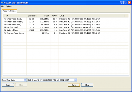

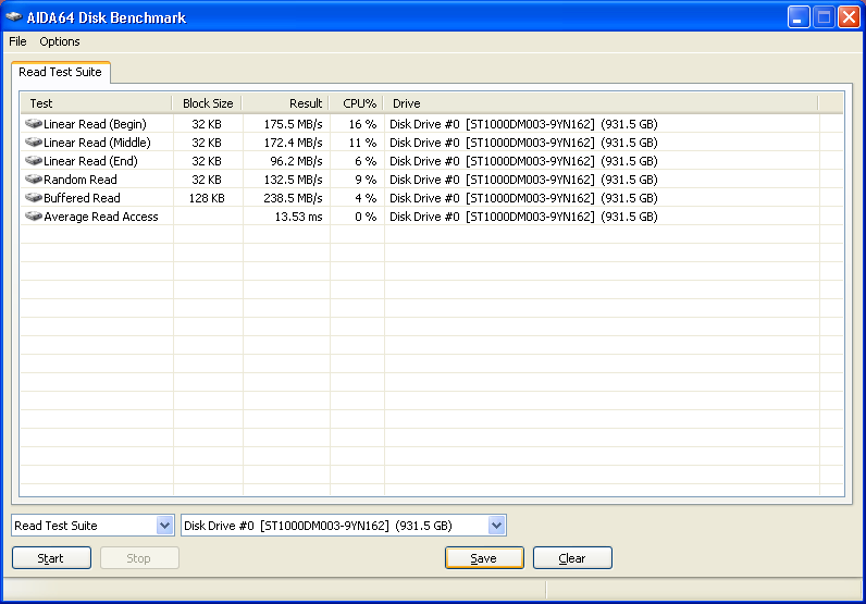

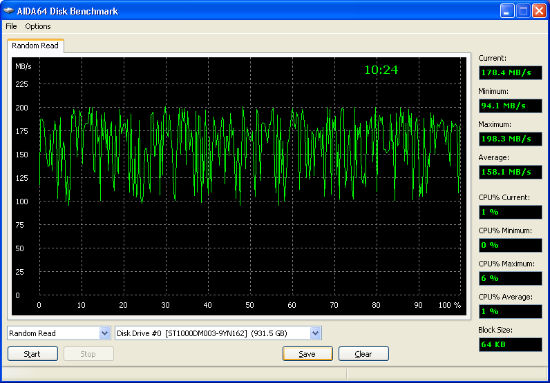

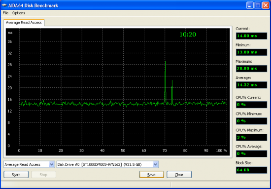

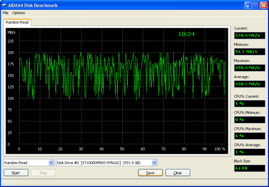

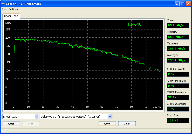

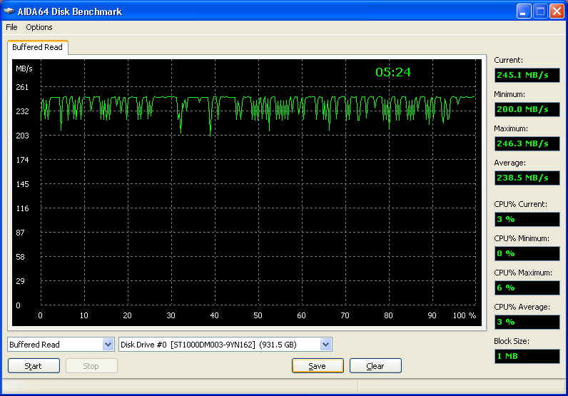

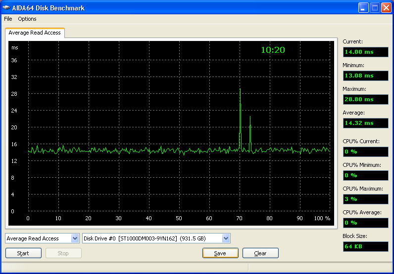

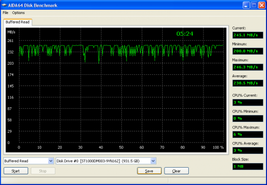

Hello , I recently bought a used seagate ST1000DM003 for cheap price , i ran some test to it using Aida64 , so i want to know if the hard disk have any problems , any help am grateful
I'm not familiar with that benchmark, to be able to compare all your results with other ones... At least the linear read graph looks approximately as I would expect.
I suggest reviewing the detailed SMART data from the disk (not only checking for pass/fail).
P.S. After collecting the full (raw) SMART data from that disk, then run a long SMART self test , gather the full (raw) SMART data again, and compare.
P.P.S. Re-run the "average read access" test and see if you get the same peak at approx 70%
