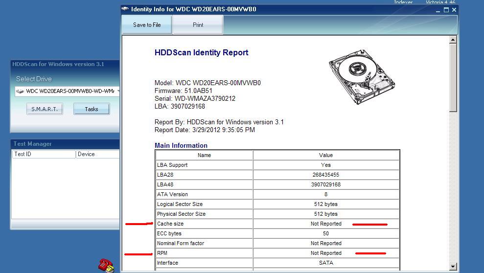

Dear guys
anyone knows why hddscan reports NOT REPORTED for this hdd?
i checked all modules/SA are OK but for few hdd`s i have here i got the same problem
which i dono WHY really
btw, the hdd works perfect condition but still dono why is it like that
Image Attached, any clues here?
thnx

Umm, it's because the drive doesn't report those values. Refer to the ATA spec.
Clue #1:
The cache size "problem" has been explained numerous times in various user forums. It is also explained in a Seagate Knowledge Base article. Search and you will find.
Clue #2:
The RPM is not reported because WD prefers to obfuscate this specification with its IntelliPower marketingspeak. You can easily determine the actual speed, using tools available to the end user, if you understand what "access time" means. Once again this has been explained in several user forums.

The cache/RPM reporting "problem" has nothing whatsoever to do with modules, G-list, or any other exotic explanation. The answer is far simpler than that. All will be revealed if you provide Vulcan with his requested information. If you are unable to retrieve the Identify Device data, please let us know and one of us will help you.
As for the WD20EARS drive in your HDDScan report, it has a cache size of 64MB. If you examine the ATA spec, then you will understand why it is impossible for a drive to report this value, at least in ATA-8. Otherwise, there is that Seagate article ...
As for the RPM, the drive is an "IntelliPower" model which doesn't report its speed.
In short, the drive doesn't report its cache size because it can't, and it doesn't report its RPM because WD has chosen not to.
If the drive has performance issues, then that's a completely unrelated problem.

HDDScan gets its info from the same place that all HDD utilities, and BIOS, get their info, and that is via the ATA Identify Device command.
We don't need any more screenshots, we just need the raw Identify Device data.

Here is the fields of ATA ID command buffer used by HDDScan
Word 21 - cache
pNode.Attributes['Name'] :='Cache size';
if IDEID.RETIRED_21<>0 then
pNode.Attributes['Value'] := IntToStr(IDEID.RETIRED_21 div 2)+' KB'
else pNode.Attributes['Value'] := 'Not Reported';
Word 168 - form factor
pNode := iNode.AddChild('Main');
pNode.Attributes['Name'] :='Nominal Form factor';
case (IDEID.DEVICE_FORM_FACTOR_168 and $F) of
0: pNode.Attributes['Value'] := 'Not Reported';
1: pNode.Attributes['Value'] := '5.25"';
2: pNode.Attributes['Value'] := '3.25"';
3: pNode.Attributes['Value'] := '2.5"';
4: pNode.Attributes['Value'] := '1.8"';
5: pNode.Attributes['Value'] := '<1.8"';
end;
Word 217 - RPM
pNode.Attributes['Name'] :='RPM';
case (IDEID.RPM_217) of
//0: pNode.Attributes['Value'] := 'Not Reported';
1: pNode.Attributes['Value'] := 'Solid State Media';
$401..$FFFF:pNode.Attributes['Value'] := IntToStr(IDEID.RPM_217);
end;
Agreed. :good: My one comment is that reporting the normal cache size has long since been retired in the ATA spec, so WD could choose not to report it for any other reason (and still be compliant with the recent versions of the spec). In the specific case of the one drive mentioned by einstein9 so far, with its 64MB cache, that size couldn't be reported using the originally designed algorithm even if WD wanted to, exactly as you said. :)
@Doomer:
Thanks, that's exactly what I was expecting. It really has to be like that - HDDScan can't display something useful, if the drive's Identify Device response doesn't include valid information for an item, which is exactly why I highlighted this previously. :) There are "invalid" values which could be reported by the drive for each of those items, and which you have chosen HDDScan to display as "Not Reported" when the drive returns an invalid / useless value. My switch statements, when I wrote something in C for another OS, were similar :) (although I displayed "Unknown" for invalid reported values from the drive / RAID array - just my personal preference).
When we see the raw Identify Device responses from the "affected" drives, we will see how they cause "Not Reported" to be displayed by HDDScan.

If the OP had done his research (as he is fond of telling others to do), then he would have found the following article:
Detecting Buffer or Cache Size in ATA Hard Disk Drives:
http://knowledge.seagate.com/articles/e ... uage=en_GB
He would also have found the following Identify Device data:
http://www.users.on.net/~fzabkar/HDD/WD ... 0MVWB0.TXT
Alternatively, if he had asked for an answer rather than a clue (as is the manner in which he is accustomed to responding to others), then I would have provided the above information at the outset. That's the point I was making.
