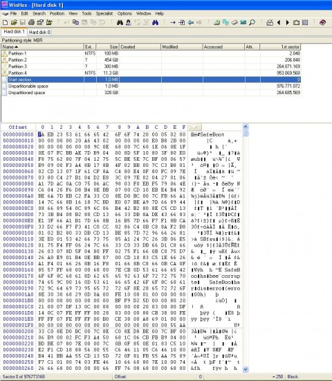

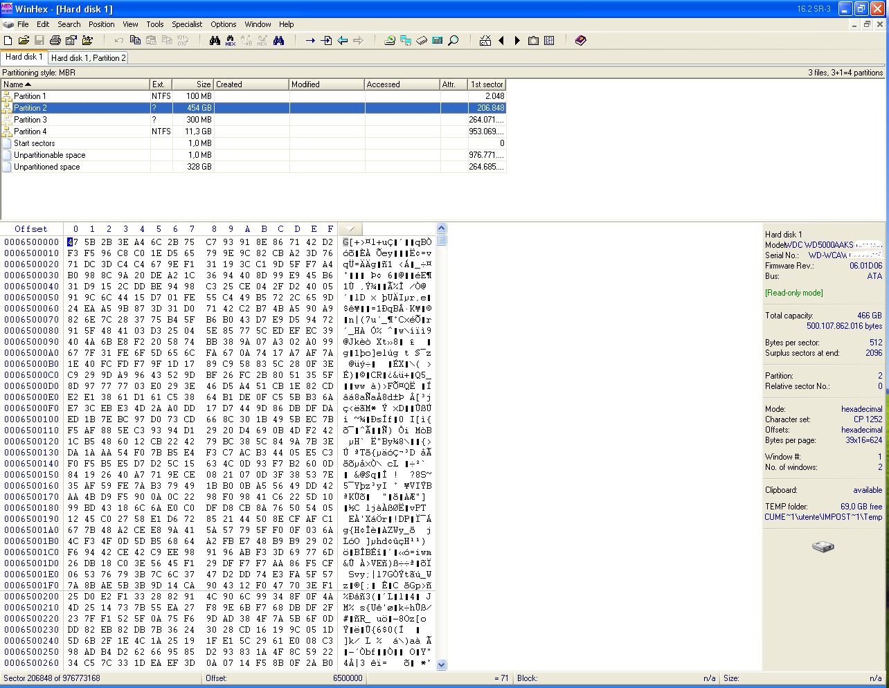

I am wondering to understand how it happened.
A customer bring me a 500GB WD with no phisical demages,no bad sectors,no demages in SA.
Analyzing the hard drive with hexeditor, it appears FULL FULL of datas.
BUT no softwares can recover anything, even in RAW!
i have tryed also to regenerate translator from plist, but no results still.
it is a system hard-drive from a computer with NTFS, the partition 2 is the one interesting.

Several of your comments fit with expected results for an encrypted partition. I suggest further investigation of that possibility. Many approaches are possible - but first, ask the customer perhaps?

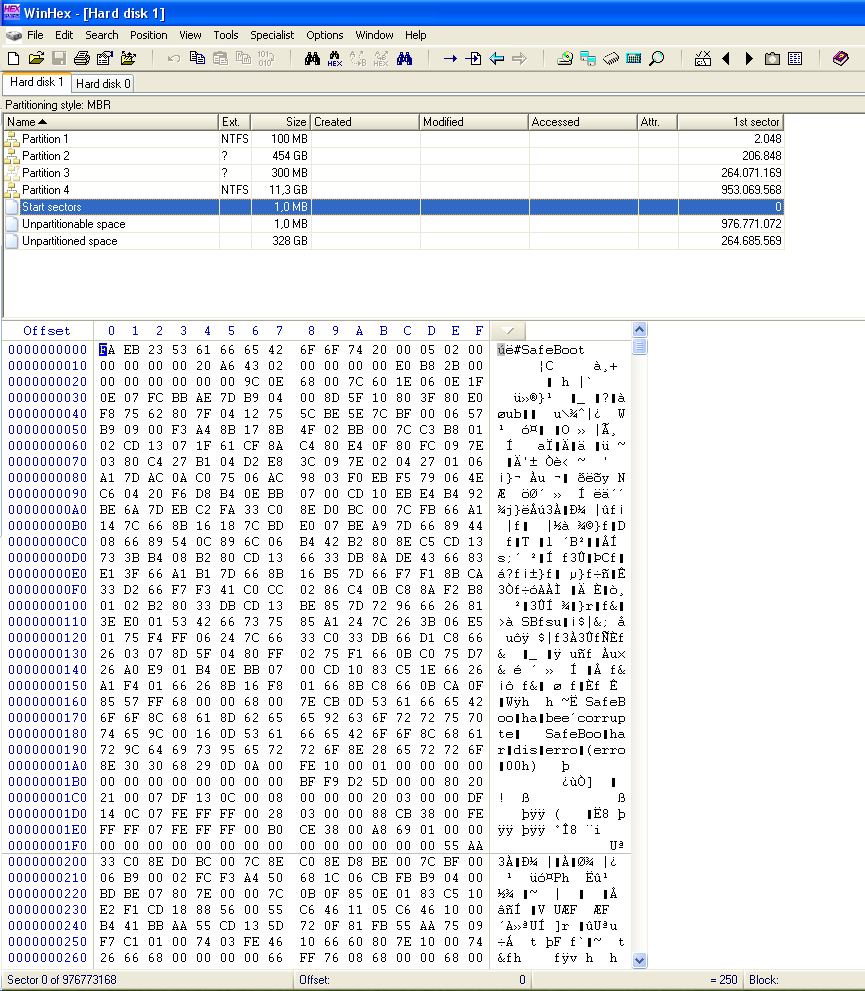

Could we see the partition table? Perhaps the partition ID bytes might give us a clue.
Partition types: List of partition identifiers for PCs:
http://www.win.tue.nl/~aeb/partitions/p ... pes-1.html

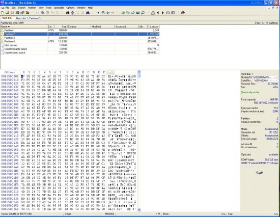

This is definitely encrypted. Maybe Bitlocker or something similar (Safeboot crap?).

If I remember correctly some HP pc's and laptops come with an HP security package. Partition encryption is one of the options and can be too easily activated by a user with administrative rights. Can't remember which one it is. Maybe like Mcafee Endpoint?
 Post subject: Re: Hdd full of data, but no data recoverable
PostPosted: April 12th, 2012, 4:05
Posts: 927
Location: uk
Yep thats the one!
PostPosted: April 12th, 2012, 4:28
Posts: 3551
Safeboot.
PostPosted: April 12th, 2012, 4:34
Posts: 872
Location: Dublin
Yep, it's clearly safeboot. A lot of HP machines come with it installed.
