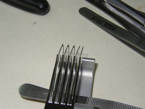

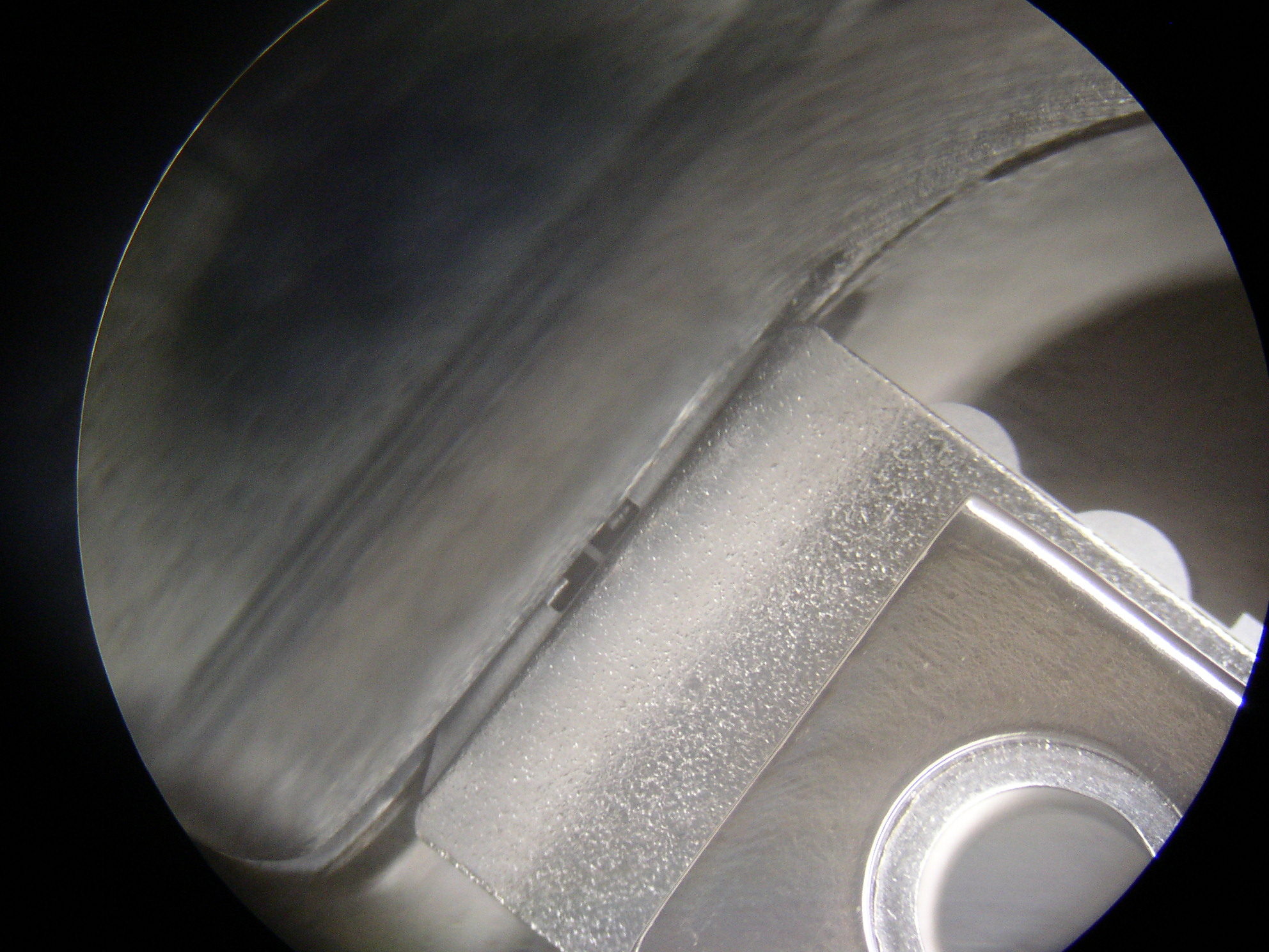

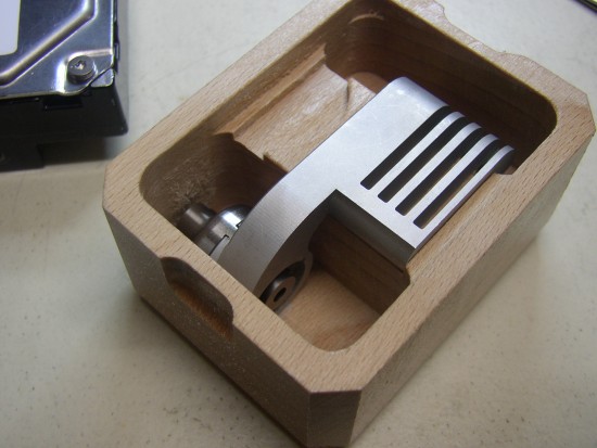

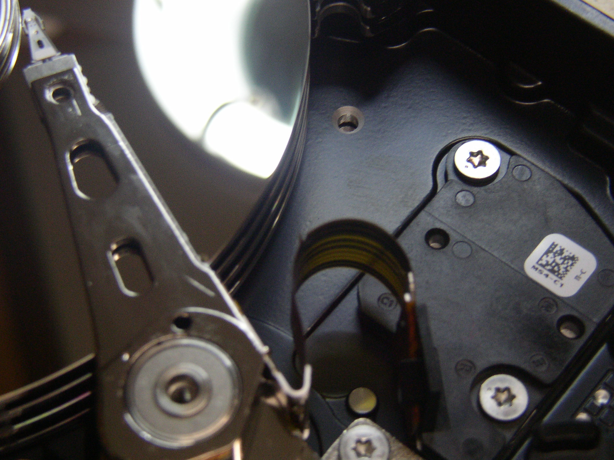

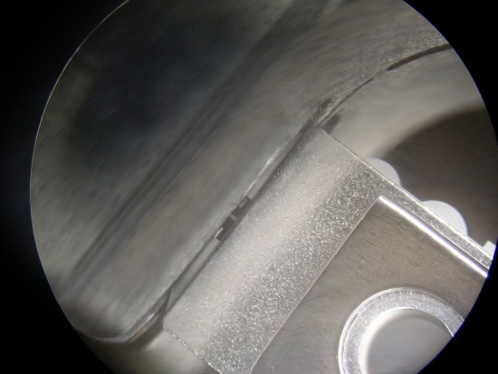

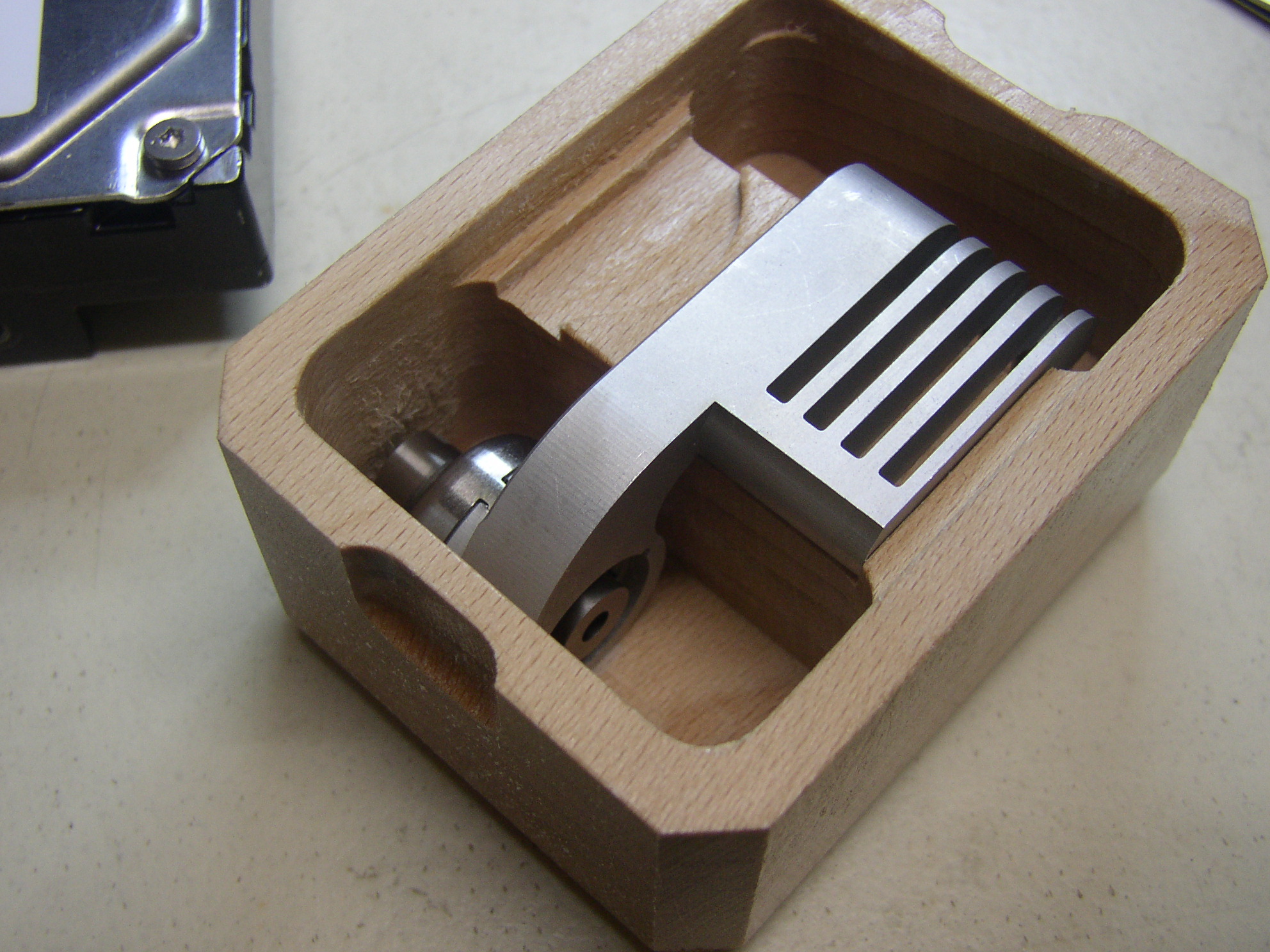

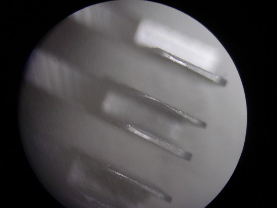

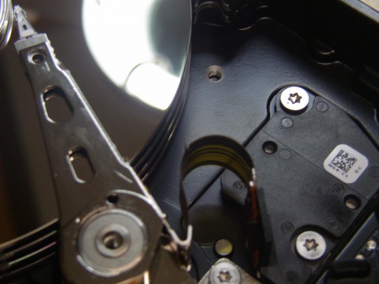

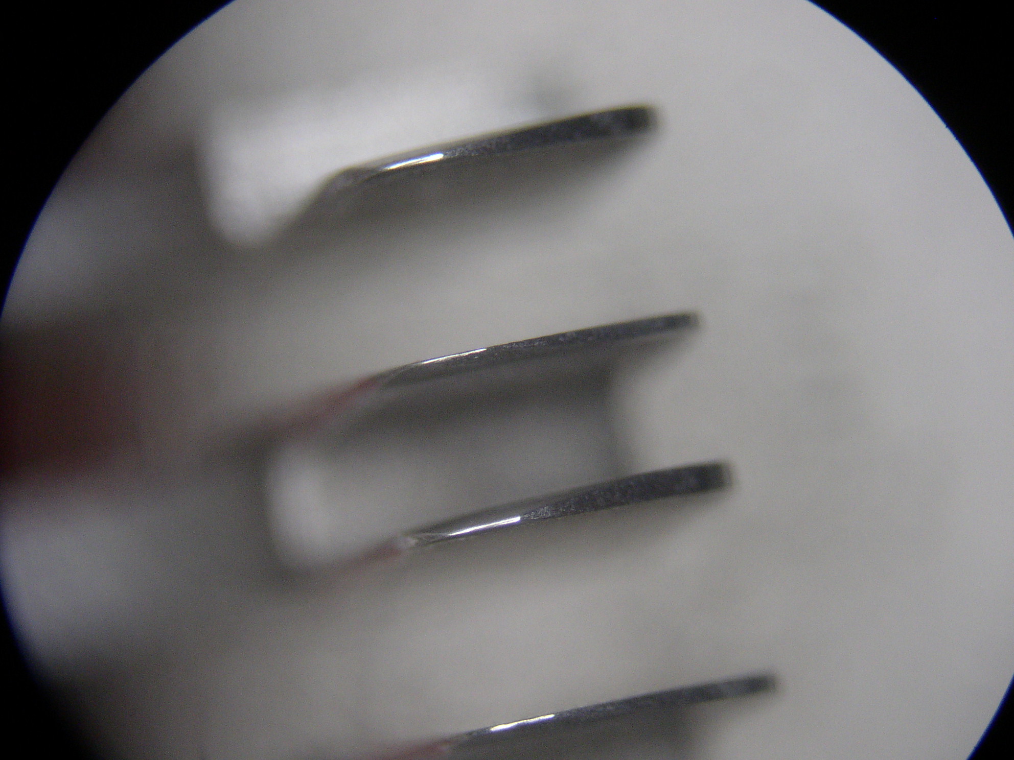

I've downloaded pictures provided by Tomset and added translation
I also must say that the tools which I've seen from couple years ago doesn't have the problems described below. And the quality of the tools I've seen was decent
Pictures provided by Tomset, description taken from Russian Acelab forum posted by Tomset
Original blades are uneven

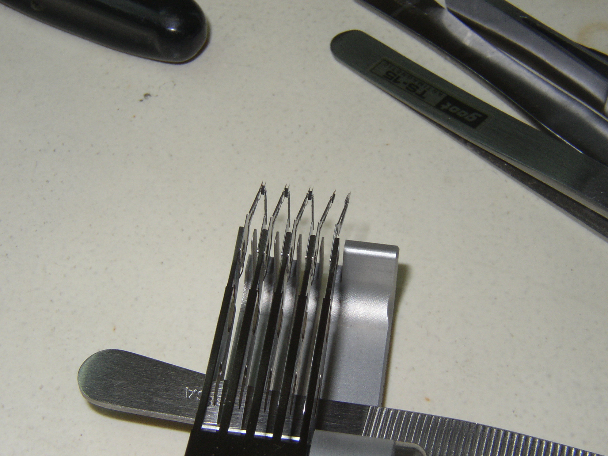

Original blades had to be tweaked manually to provide somewhat better quality

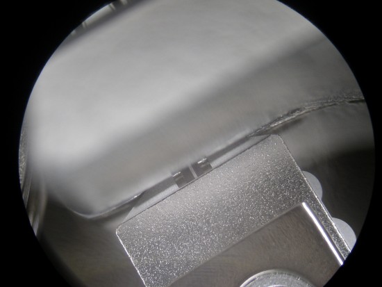

Original blades are poorly designed and placed too close to the arm of HSA
3-original blades are too close to the arm of HSA.JPG [ 672.98 KiB | Viewed 12720 times ]

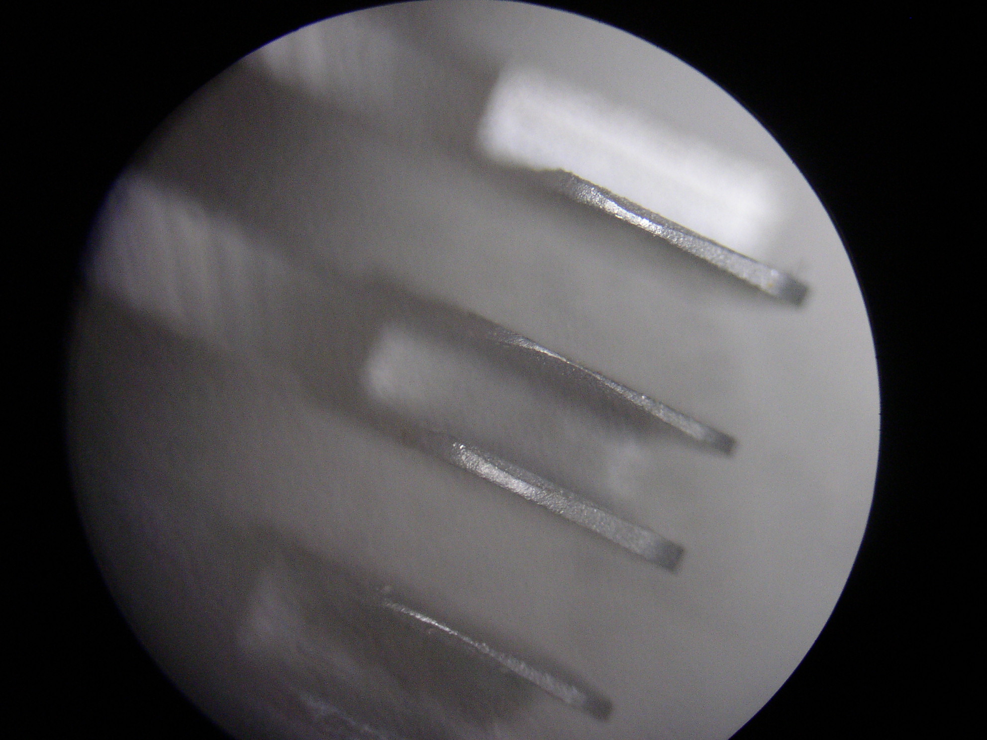

Because of the design the tool may damage the HSA
Damaged HSA

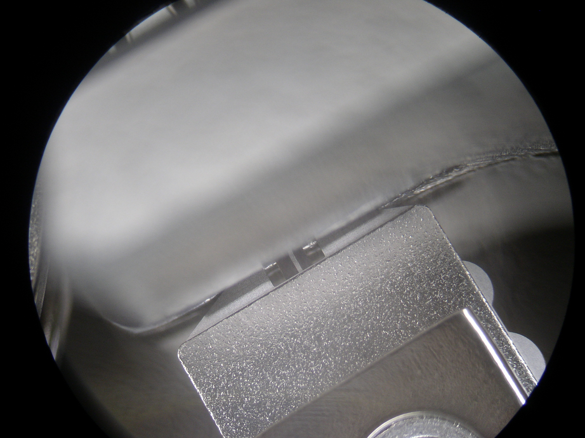

Blades after manual filing, not so close to the arm now

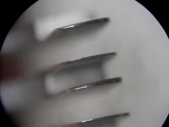

Original tool has very sharp corners
And this may cause ribbon cable cutting

@doomer.
If problem is not knowing English he could write them to me on Russian, I would understand.
1. Pictures One and Two
The point that You want to show here is completly wrong one. That shows that You do not have understanding how things work.
The reason why You have that problem is "tweeking of good tool" i presume.
You are wrong because You think that heads are lifted by the edge of the tool feather. The sloape You show here on these pictures
is not responsibile for lifting heads. Heads are lifted with the curve of the head comp. If it was not curved if it had a slope only it would punch into heads and it would not be able to lift them. The radius on the end of the head comb provides lifting . It always have only one contact with the heads. The radious of it is designed , altering it can cose damage to the heads.
2. Picture Three
of course they are close, it is all so tiny, we are talking here about one hundred part of a mm
3. picture Four
it is clear by the position of feathers that tool is not mounted good. I assume it was just for making pictures.
The fixating screw was not set.
4. other pictures show that he messed up with the tools i hope not it was some mill or something since he could
damage the geometry of very thing feathers.
Damage coused on the flat cable shows that instruction was not folowed and that he mounted the tool withouth taking the flat cable off.
Wich is described at VIDEO, ANIMATION and PDF manual.

I have consulted colleagues here, we all agree that he did not moved the flat cable out of the hdd which coused
tool not to sit down on its place and that could damage the head...I do not see other scenario...

I never doubted for a second that I would blame myself.
It was immediately clear to the first letter from the seller, after I had made ​​claims.
Especially after what I had straightened tool.
Now, the more everyone will say that I had ruined everything.
And useless to prove anything.
Even the photos are not able to convince anyone either.
In the first photo, we see the traces of which are coupled to the suspension arm.
The tool came under the head, only with considerable effort.
 Post subject: Re: HDDS WDC 3.5" Ramp p4 - New tool from HddSurgery
PostPosted: April 12th, 2012, 5:40
Posts: 709
Location: Belgrade
It seems that Your english is good enough.
Plz read what i wrote. Only thing is i do not understand why You spit on someones work withouth asking me what could be the problem?
Is it possibile that tool is bad. Of course, they even get opened in customs, because when they see HddSurgery they think it is some doctors tools ...expecialy with Russian customs . Sometimes they do not want to alow it to cross customs.
If You done something wrong this could happen, but instead of contacting us You decided to act on Your own and modify the tool. We were just mail away.
I am not a seller, i am a collage. We also do datarecovery , and I was user of this forum long time we even started HDDSURgery. I was on Mhdd long time ago. We do not sell our tools like Sd or Ace, we do not have guys pulling your hand to buy it. We have collages , friends and then customers.
We all have same problems same drives same clients. I menaged not to make any enemies or not satisfied customers
and I am sad because You did not even come to me.
First I am sure We could help You solve Your problem.
Second i am sure You done something wrong that coused that problem.
And third even if You realy have a foulty tool for some reson, we would compensate you and we still will.
Puting this on the forum, withouth asking us show this is atack not a complaint and I do not see a reason for it.
Hope You will come back to us so we can sort this like gentelmans.
