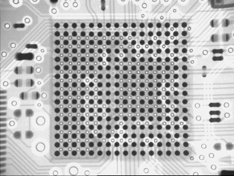

I have access to a electronics rework lab (full-scale measuring), X-Ray machine, several BGA rework machines, deep but narrow knowledge about mobile devices etc... but not HDD :(

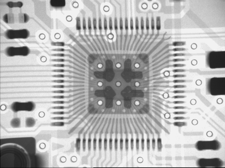

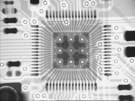

Been analyzing the PWB :
1. Both trancient Zeners OK, on both rails
2. Oscillator dead (supplied by MCU itself ?)
3. Oxidation relatively low, both sides of PWB
4. No DC-DC activity seen, step-down or SMPS (combined MCU & EM ASIC / PMIC ?)
5. Nothing warms up
6. Froze the drive to -15 degrees celsius, nothing
7. Rose it to +50 degrees celsius, nothing
8. Heated MCU stack, motor driver (SH6125B), diodes & ST MOSFET with Heat Gun, using common sense. No help

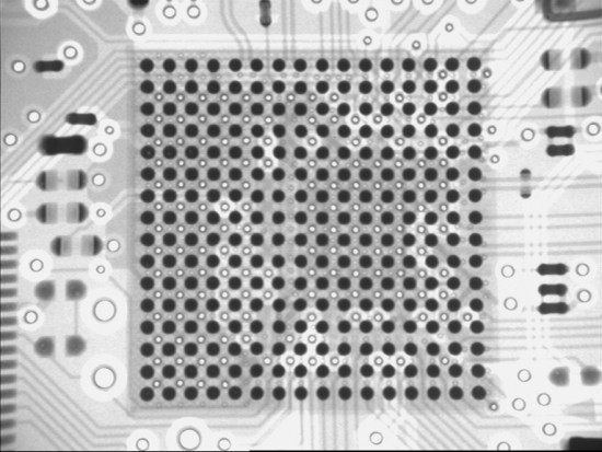

9. Did a triple visual check of solders & X-Ray analysis
10. Zero ohm resistor OK
Nothing !
This is frustrating without scematics & lay-out.
MCU / PMU dead ?

If this is your PCB ...
http://farm8.staticflickr.com/7053/6921 ... 9e0e_z.jpg
... then the two 4R7 coils would be the inductors in the Vcore and Vio buck regulators that supply the MCU. The 5 plated through-holes would be the respective test points. The MOSFET choppers and Schottky flywheel diodes would be internal to the motor controller.
The anode of the diode adjacent to the 1R2 coil would be the test point for the -5V supply for the preamp. The STJ009 IC would be the PWM controller for this inverting buck regulator.
I realise that you have stated that there was no PWM activity in these areas, so that would suggest that either the motor controller is dead or is not receiving its correct supply voltages. You may wish to probe around the heavier traces for +12V and +5V.

Thanks for you're reply fzabkar !
That is the board, yes.
I know now more about the board.
No activity seen of any kind. I first probed the coils. VIO & VCORE definedly WON't rise, haven't measured if the VCM controller supply is OK.

HDA's PreAmp is unpowered at all times :
"The anode of the diode adjacent to the 1R2 coil would be the test point for the -5V supply for the preamp" (flat) !
So,
I should find
- preAmp feed from 1R2 coil = zero
- VCORE for Marvell's nightmare from 4R7 coil = zero
- VIO for digital IO from another 4R7 coil = zero
No activity near any of those 3 bigger coils. These leads to conclusion that SH6125B is not breathing. It's start-up logic is also a mystery what does it need the wake ? +5 at least (to generate VIO & VCORE, clock?, +12V), some other wake up signal.... ?
I got to trust that this part is changeable and not a security component with AGAIN memory.
Actually the only +5V I measured / found was from the capacitor next to DIP MOSFET.
Trying to understand but I need the scematics & lay-out of this board to even figure out is the SH6125B itself powered.
What are the pins ? :shock: Left my dear microscope at work so it's kinda hard now when I'm home. Well, another day tomorrow and my donor drive should be in mail by now.
Good side is that this seems to indicate a PCB failure (holding my breath). Changing the SH6125B from the other board is not a problem. I understand that this component can withstand high temperatures during it's own operations. So maybe it can take the heat from FineTech's PICO without damage when I change the sucker :lol: The middle ground is possibly hard to detach but it will come out.
Should I first try a direct PCB swap OR maybe change SH6125B or MOSFET... I think I will try luck with swap. But the amount of opions about the people who are positive that this can damage the HDA. But others say, hey, no problem man just do it !
Cannot even try to figure out how to copy a part of ROM from a dead MCU stack's flash. But first I need POWER and it obviously isn't generated ! Neither is the oscillator buzzing :?
I gotta admit that I don't exactly understand what is the DIP MOSFETs role here (AMP ?) but found +5V near it so I might to study it also.
BTW +5V rail resistance to GND seems very low. Just measured it : ~2.25 kohms.
+12V to GND is ~270 kohms
+5 to +12V about 275 kohms.

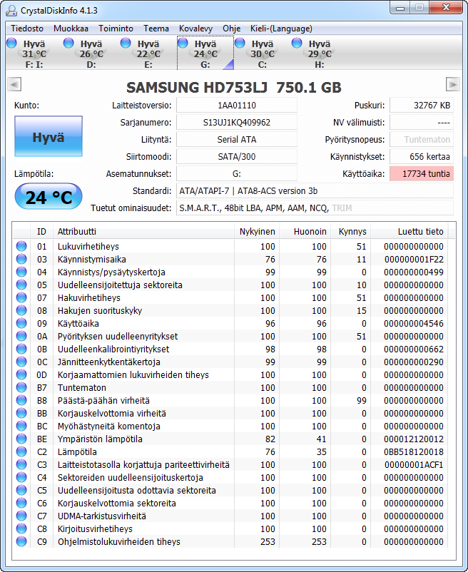

Success, all data recovered and drive works "normally" again :D
Thanks for the help !!
AND learned a LOT !

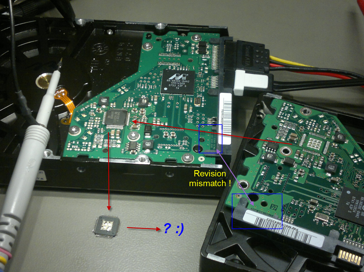

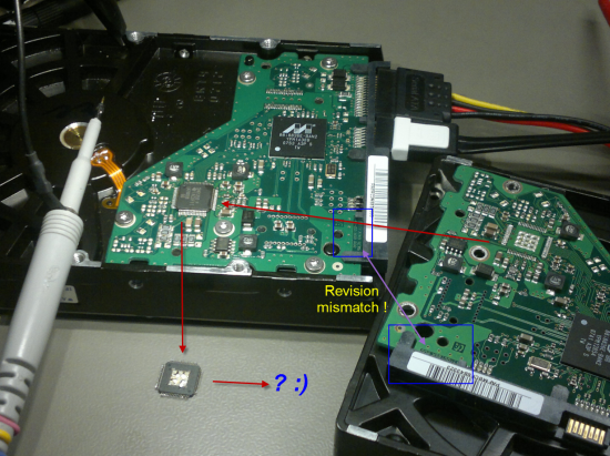

Straight PCB SWAP failed but heard that the motor woke up from the dead and fault left to PCB.
Wrong PCB(!) revision. Dates on drive(!) : 2008.01 (new), 2008.4 (original)
Revisions 004 and 005. If I remember correctly.
Out again and heat gun on !
Swapped VCM controller and no-problems on repaired one anymore, IC was simply dead.
PreAmp got -5V now and VIO & VCORE jumped up. Found eventually life from those coils. No hassle after the chip change except that it was quite a thrill even for me who has changed thous... a lot of uBGA & LGA components. Not really a novice in that area despite the ugly looking change :wink:

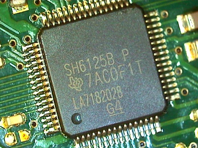

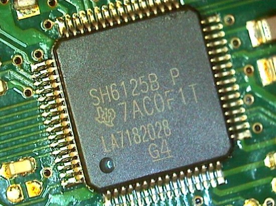

My original was TI SH6125B got replaced by SH6125B_P (only difference I found near P ending version was that new ASIC's two lines were jumpered together with SMT jumper).
Two bottom solder terminals (adjacent), one 0 ohm resistor which was forming a triangle of three jumpers with other two. A solder bridge would have resulted the same :?
Measured ~2.5 V during operation when attached, big difference without (don't remember). No idea what lines those were (even the SH6125B_H version, works without it though) !

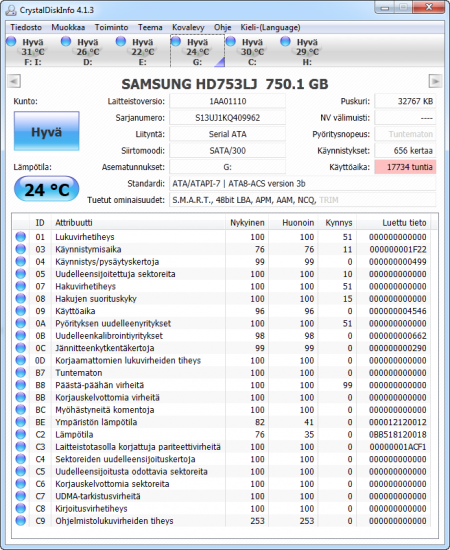

File comment: Got a finnish version of CrystalDiskInfo... "Hyvä" is "Good" :) sorry about that. Sure has served some hours also :o

For non-critical work ? Indeed !! Now the sentimentally valuable data is stored optically and to another, new drive.
Actually still curious will the drive actually last and work on long run but as far as I can tell the chip change succeeded.
But of course, the chip I used is old ALSO. But the heat needed for soldering was immerse (bottom plate soldering).
So definedly nothing critical goes to that drive.
Does the pictures of old girl friends count ?? 8)
What it comes to measuring the oscillators I have also witnessed same behavior before with mobile phone oscillator's also. Many times the measuring attempt of systemClk or sleepClk has crashed the phone HW also.
Some times seen wave, sometimes a crash :wink:
Given that my probe has seen a lot of use and served me long and mark can be irrelevant. Serves it's purpose.
Happy ending here and studying the HDD was also interesting in some weird way. Can't deny this.
