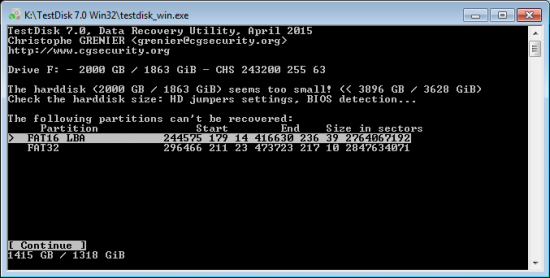

I have a 2TB HDD, with one NTFS partition, almost full of data, which is no longer recognized by Windows (Windows 7 Pro 64bit). The drive letter appears but not the partition size, and there's a request to format it. In Windows storage manager, it appears as “RAW”. CHKDSK gives up analyzing it right away, with an error message saying that it's unable to determine the version and the state of the volume.
Yet, if I open that drive with R-Studio, the partition appears right away with its correct size (no scanning is even required), I can open it and access all the files that were there the last time I used it normally, with the whole directory tree, and the files' contents seem 100% correct as far as I can see. Likewise, if I open the whole drive with WinHex, it correctly recognizes the partition, and displays the files / folders with their correct contents. (If I open directly the “F:” partition, it says “incorrect parameter”, but then proceeds to open the filetree anyway.)

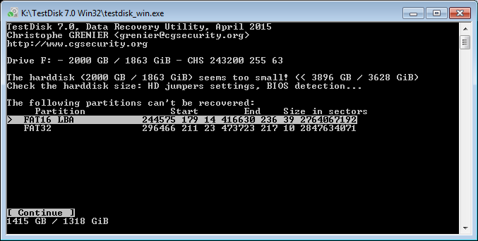

I thought that the partition table could have been corrupted somehow, ran TestDisk to try and fix it, but after opening the drive it gave me this :
    Partition       Start          End            Size in sectors
1 * DiskSecure MB   13578 105 19   13310 178 61   1920221962
Bad relative sector.
2 * Sys=74          33885 131 23   153418 150 44  1920298864
3 * Linux Swap      14043 1 25     47914 125 15   544145418
4 * SpeedStor       171841 203 21  171845 2 60    51637
Yet I don't remember using that drive on a Linux system, let alone tampering with the partitioning / formatting. And then, if I run the “Quick Search”, it's analyzing the whole surface (normally it should be much quicker), without finding anything relevant. It just finished scanning and displayed this :
The drive is a ST2000DM001 – I know that these have a bad reputation here, but I don't see how this could have any bearing on what appears as a strictly logical issue, and a not-so-severe one if I can still access the files flawlessly with R-Studio / WinHex. It should also be noted that a few weeks ago that drive fell on the floor from a relatively low height while unplugged; it doesn't seem to have affected its physical integrity whatsoever : HD Sentinel displays a 100% health status, with no bad sector or other critical flaw. Yet the Ultra ATA CRC Error Count has risen from 0 to 237 since November, and I get this warning :
Problems occurred between the communication of the disk and the host 237 times. In case of sudden system crash, reboot, blue-screen-of-death, inaccessible file(s)/folder(s), it is recommended to verify data and power cables, connections – and if possible try different cables to prevent further problems.
More information: http://www.hdsentinel.com/hard_disk_cas ... _error.php
(The drive is currently connected through a hot-swap cage, directly plugged with a SATA cable to the motherboard, but the last time I plugged it, when this issue appeared, it was connected through an external enclosure, in eSATA, so it may have been a bit flimsy.)
So what is going on here ? And how can I regain direct access to the drive's contents, short of extracting everything with R-Studio ? (Actually the contents are mostly a recovery from another drive, a 3TB one, which I still have and haven't used since, so I could still extract the files again from that one, it's just that I've done quite a lot of work to sort out the files, remove duplicates or corrupted ones, I don't want to start all over again.)

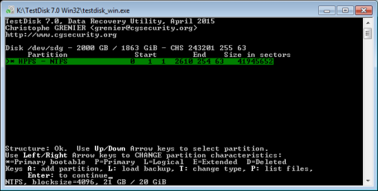

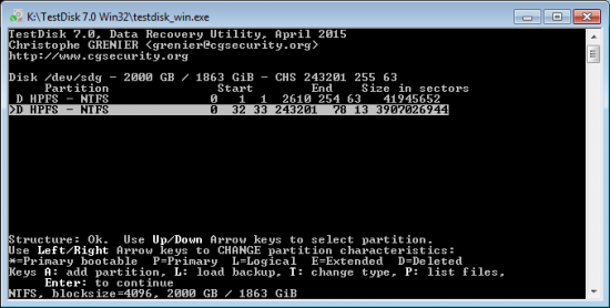

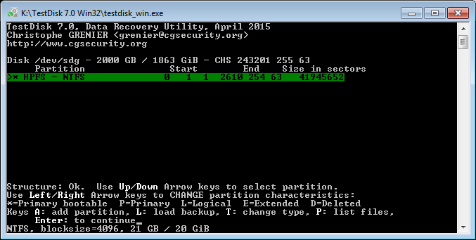

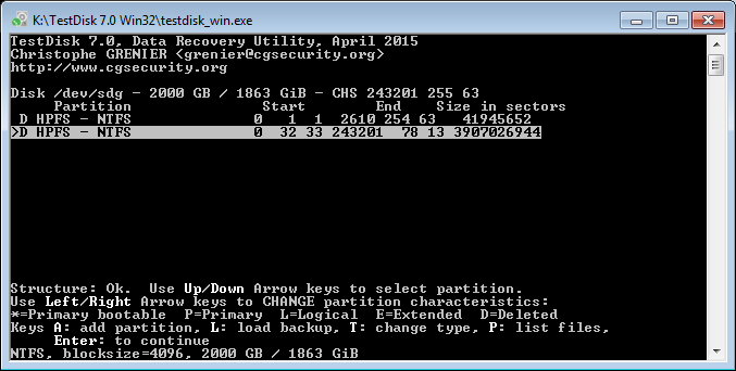

I tried TestDisk again : after a “Quick Search”, it finds a partition at “0 1 1” (sector 64 if I'm not mistaken), but with a size of only 41945652 sectors / 20GB. If I run the “Deeper search”, it finds another, at “0 32 33” (that would be sector 2049 ?), with a correct size of 3907026944 sectors / 1863GB. If I list the files for that second partition, I get the expected contents. But the partition start should be at sector 64, according to R-Studio or WinHex (or 63 counting from 0), so I don't know where this other value comes from.

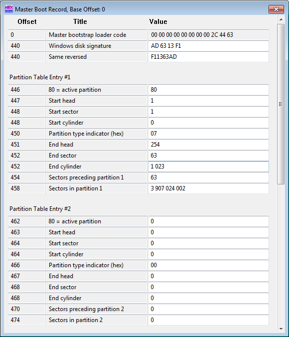

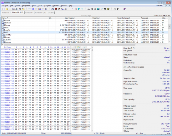

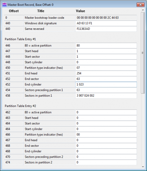

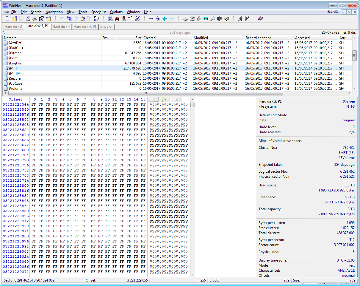

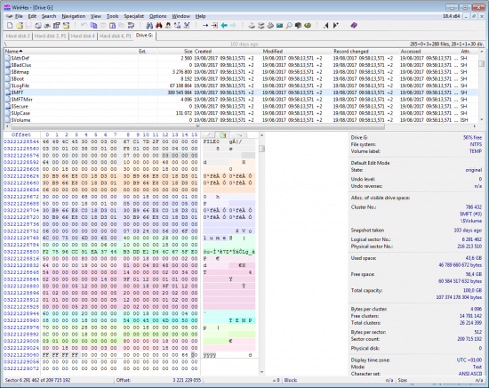

In WinHex, “Partition table (template)” shows this :
ST2000DM001 Z4Z0T7LY WinHex Partition table (template).png [ 35.21 KiB | Viewed 35687 times ]
I'm not familiar with partition table analysis, but there seems to be an inconsistency : the C/H/S values should be much higher, right ? Also, they're different from those of the erroneous partition found by TestDisk : “1023 254 63” / “2610 254 63”.

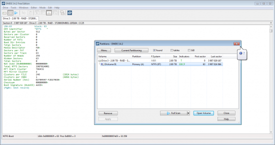

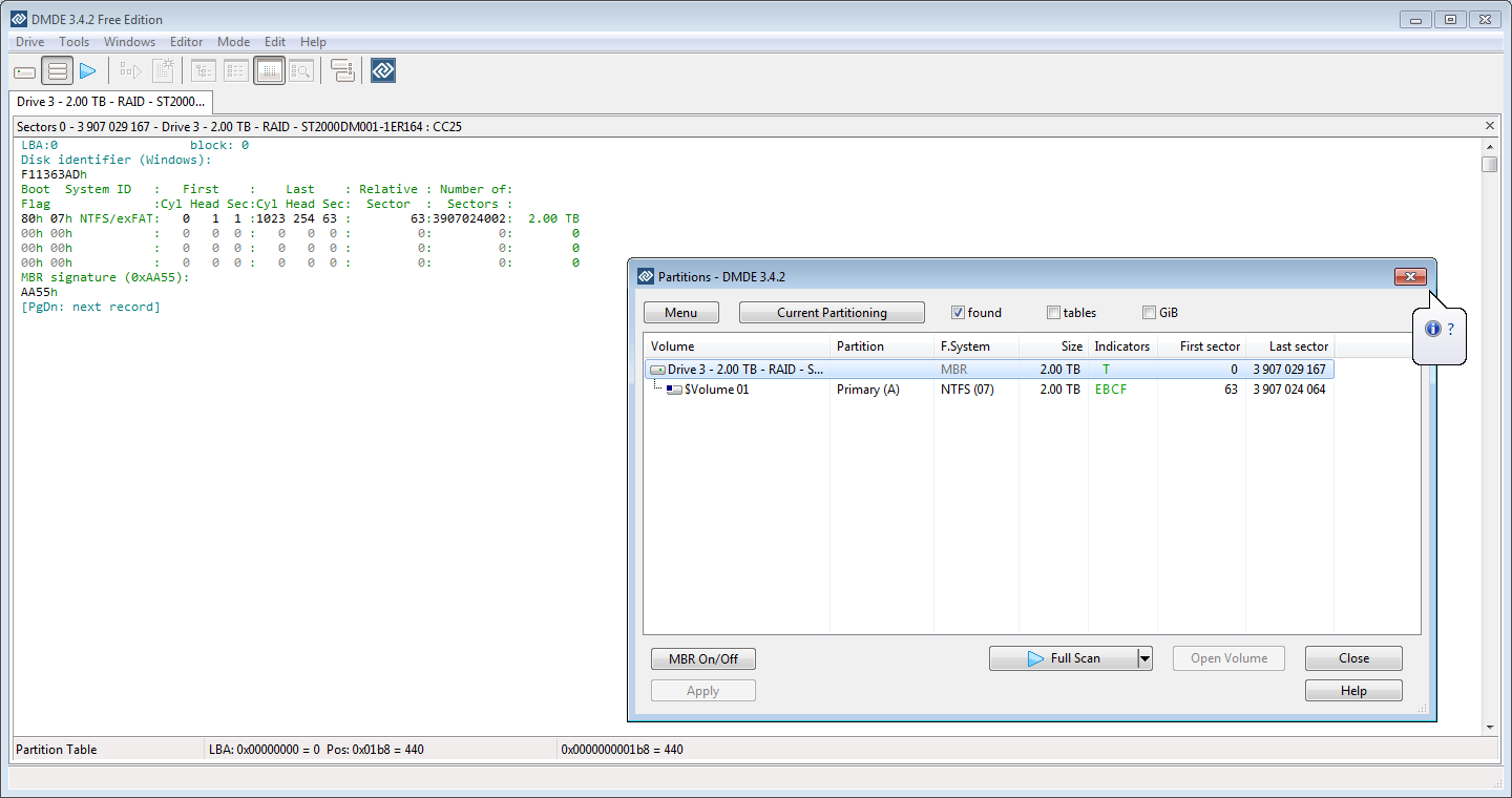

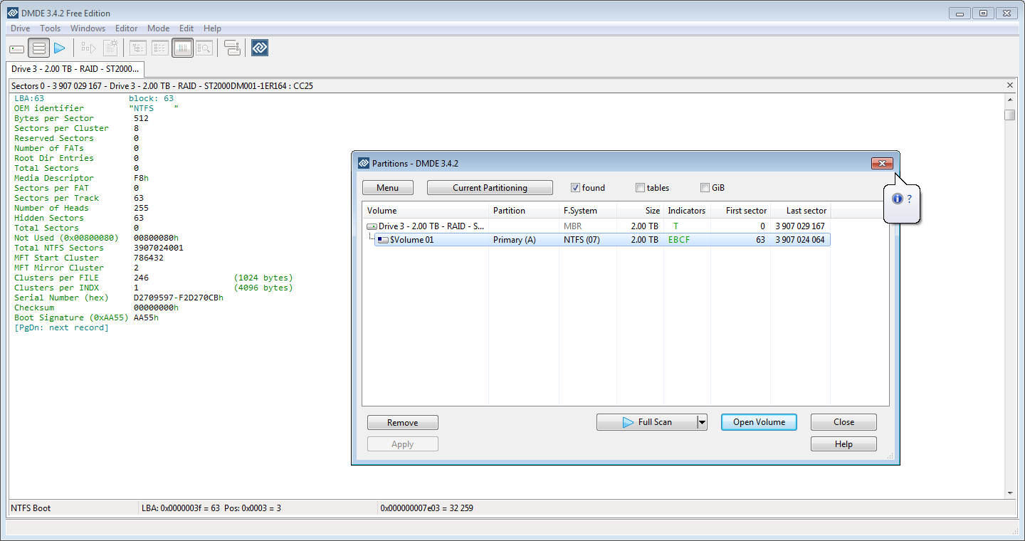

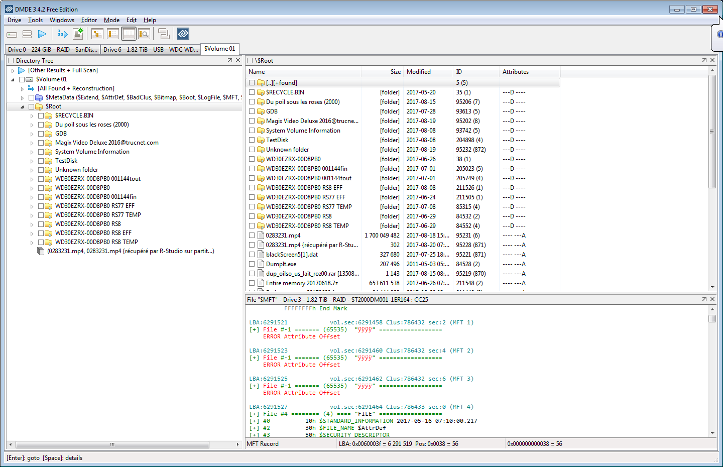

And DMDE shows this, if that's the window you requested (I've used this software only once and more than a year ago, seemed powerful but tricky to use) :

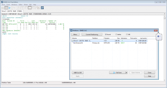

Or maybe this can help too :
 Post subject: Re: Weird logical issue (“RAW” NTFS partition)
PostPosted: June 19th, 2018, 3:16
Posts: 17217
AISI, the partition table and NTFS boot sector seem OK. I don't know where TestDisk is getting its information from. :?
Isn't the “Last Cyl 1023” value erroneous ? If I'm counting correctly, it corresponds to 16450560 sectors, or about 8GB...
How would you explain that some softwares (R-Studio, WinHex, MyDefrag, DMDE) deal with it fine, while others (Windows Explorer, CHKDSK, Defraggler) choke on it ?

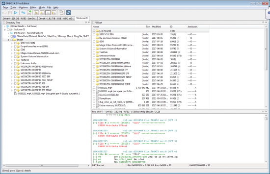

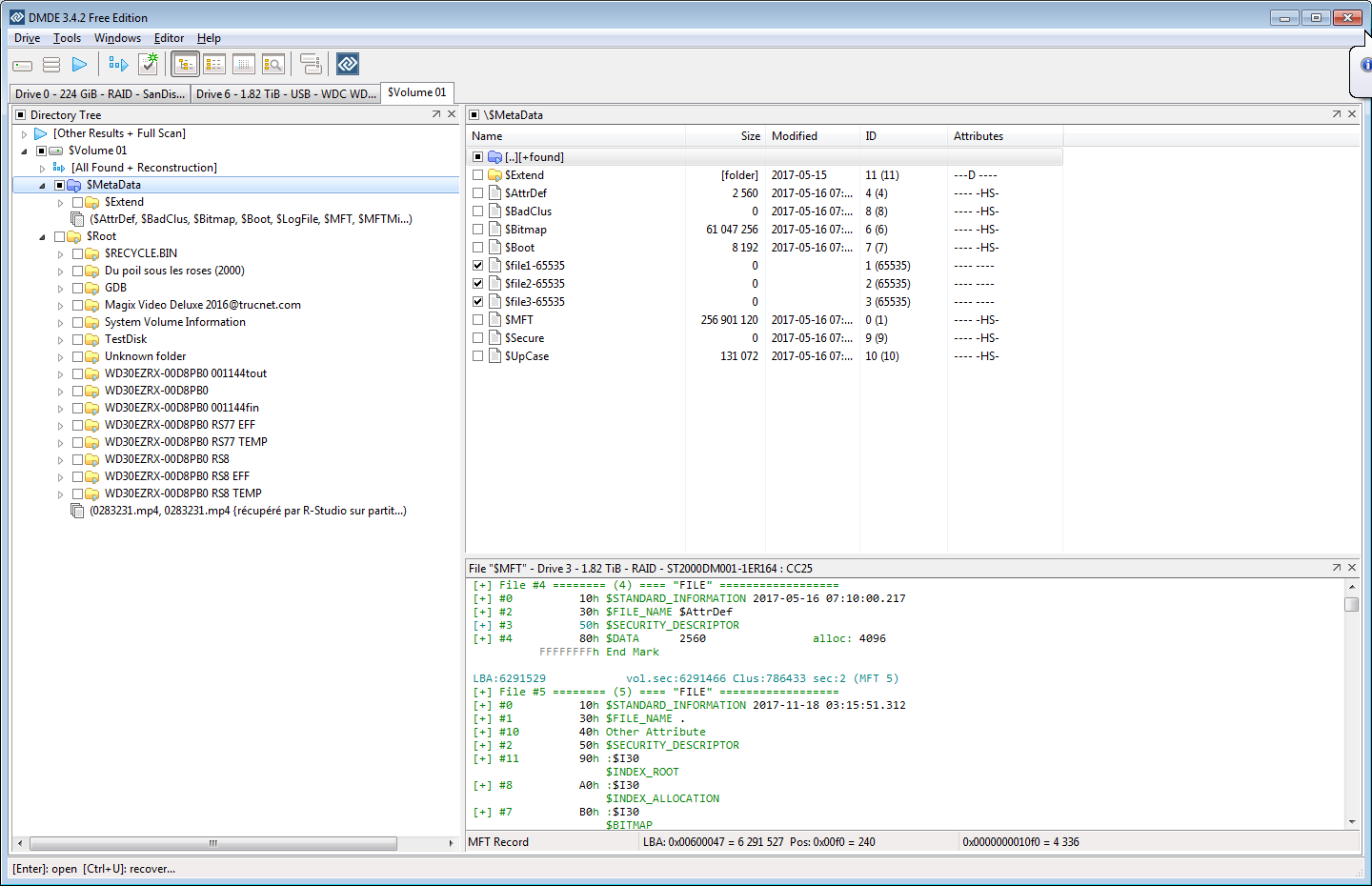

DMDE can also display the whole file tree instantly, but reports an error for (at least) 3 MFT entries, saying “ERROR Attribute Offset” :

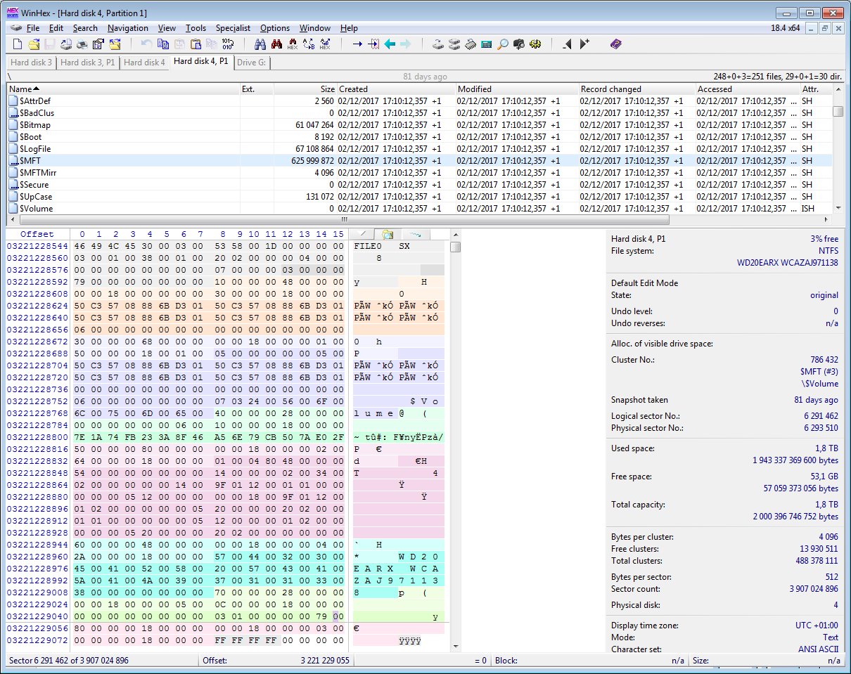

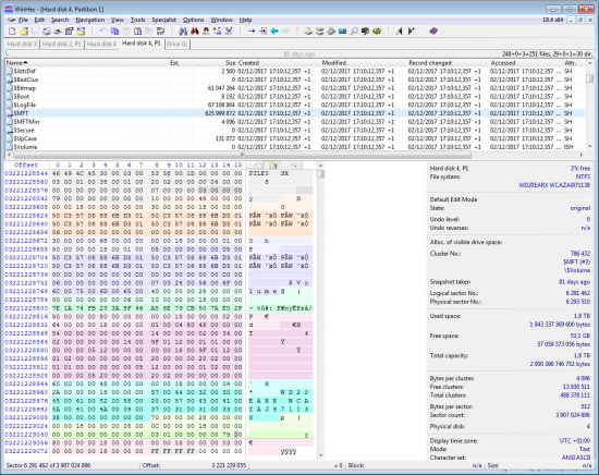

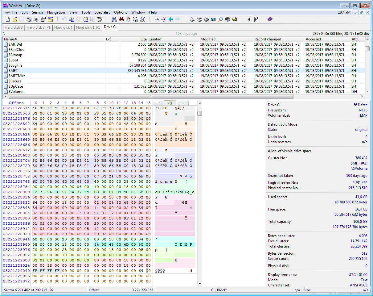

In this case (the current issue with the 2TB HDD), when examined with WinHex, the MFT seems to be at the right place (6291456 + 63), but what should be MFT records for $MFTMirr, $LogFile and $Volume (respectively MFT records 1, 2, 3 – just the ones for which DMDE reports an error) are filled with “FF” values (“ÿ” in ANSI), there are 3072 “FF” bytes, then MFT record 4 is fine ; MFTMirr (located at sector 16 relative to the partition's start) looks just the same (first record fine, then three corrupted). What does it mean, how could it happen, and how can it be fixed “cleanly” ? How come CHKDSK can't deal with just three corrupted MFT records ? Perhaps it precisely needs to access those three particular system files and can't, since they're no longer correctly referenced ? How can WinHex / R-Studio / DMDE locate those files and display their metadata accurately without the correct data from the MFT ? What is likely to happen if I just copy MFT records 1-3 from another drive ? (Some values won't match but maybe CHKDSK will be able to fix them... it's not that “clean” though, I'd prefer to know exactly what I'm doing ! :) )

Update :

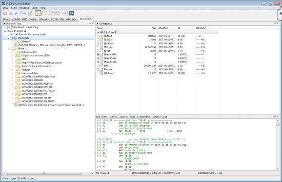

Actually, R-Studio does not locate $MFTMirr, $LogFile and $Volume (they don't appear in the “Metafiles” folder, where they should be, I verified by opening another NTFS partition). WinHex does locate them, but using a volume snapshot made about a year ago, when the partition was still accessible (if I take a new volume snapshot they will probably disappear there as well) ; so at least, if required, I can get the correct offset values for those three files, their correct timestamps (which are exactly the same as those of the other system files), and their correct sizes if they haven't changed since then ($MFTMirr is always 4KB, $Volume is resident in the MFT, $LogFile doesn't appear to have changed in size as there is a valid directory right after its supposed boundary).
DMDE in the “$MetaData” directory displays three files with unknown names and attributes :
Now, how can I fix / recreate those three corrupted MFT records ?
PostPosted: June 19th, 2018, 17:21
Posts: 17217
CHS mode assigns 10 bits for the cylinder number, resulting in a limit of 1024 cylinders (0 - 1023). In CHS mode, sector numbers count from 1, not 0 (seems crazy, but that's the way it is).
This site should tell you everything you want to know about partition tables:
MBR/EBR Partition Tables:
http://thestarman.pcministry.com/asm/mbr/PartTables.htm
Misalignment of the partition to the physical sector size results in a performance penalty during writing (due to the additional rotation required for a read-modify-write cycle). There should be no other anomaly. In fact Seagate touts SmartAlign to transparently address misalignments in legacy OS-es.

Here are two valid $Volume MFT records from other NTFS partitions, and the corrupted one :
Again, can I rebuild the third one by assembling static bits from the two others and replacing the changing values with the correct informations about each file ?
Should the Volume ID be exactly the same, or can it be randomly defined, so long as it doesn't conflict with another ? Does the system store those IDs somewhere, even for the drives which are not currently connected ?

@abolibibelot, ISTM that you should take this opportunity to learn about NTFS metafiles. I could watch you and learn something as well. :-)
This seems to be a good resource:
http://dubeyko.com/development/FileSystems/NTFS/ntfsdoc.pdf
If you can find it, here is another good resource:
NTFS Forensics: A Programmers View of Raw Filesystem Data Extraction (Jason Medeiros, Grayscale Research 2008).
BTW, DMDE can display all the metadata attributes, eg ...
LBA:70021380           vol.sec:6291462 Clus:786432 sec:6 (MFT 3)
[-] File #3 ======== (3) ====        ==================
     magic ("FILE"):            FILE
     fixups offset:               30h
     fixups count:                 3
     LSNlo:                 022F0095h
     LSNHi:                 00000000h
     seq. number:                  3
     hlink number:                 1
     attrs offset:                38h
     flags:                        1h
     used size:                  1F0h      496
     record size:                400h     1024
     basefileref:                  0
     0x24:                         0h
     basefileref seq.:             0
     next attribute #:             7
     0x2A:                         0h
     file #:                       3
     fixup:                     0045h
[-] #0              $STANDARD_INFORMATION
       Attr. type:                      10h
       Attr. length:                    48h         72
       Non-resident:                     0
       Attrname len:                     0
       Attrname ofs:                    18h
       Flags:                            0h  -- --
       Attr. number:                     0
       Data Size:                       30h         48
       Data Offset:                     18h
              created:          2015-05-26 08:59:04.501
              modified:         2015-05-26 08:59:04.501
              changed:          2015-05-26 08:59:04.501
              accessed:         2015-05-26 08:59:04.501
              attrs:            -HS------------- ----------------
              Max versions:     0
              Version:          0
              Class Id:         0
[-] #1              $FILE_NAME
       Attr. type:                      30h
       Attr. length:                    68h        104
       Non-resident:                     0
       Attrname len:                     0
       Attrname ofs:                    18h
       Flags:                            0h  -- --
       Attr. number:                     1
       Data Size:                       50h         80
       Data Offset:                     18h
              directory:        5           (5    )
              allocated:        0
              reparse:          0
              name len:         7
              posix:            3
[-] #6              Other Attribute
       Attr. type:                      40h
       Attr. length:                    28h         40
       Non-resident:                     0
       Attrname len:                     0
       Attrname ofs:                     0h
       Flags:                            0h  -- --
       Attr. number:                     6
       Data Size:                       10h         16
       Data Offset:                     18h
       Hex:
       000: DE 28 17 04 10 10 A5 4B B9 35 E0 07 C6 36 F3 9E  Þ(....Â¥K¹5à.Æ6óž
[-] #2              $SECURITY_DESCRIPTOR
       Attr. type:                      50h
       Attr. length:                    80h        128
       Non-resident:                     0
       Attrname len:                     0
       Attrname ofs:                    18h
       Flags:                            0h  -- --
       Attr. number:                     2
       Data Size:                       68h        104
       Data Offset:                     18h
       Hex:
       000: 01 00 04 80 48 00 00 00 58 00 00 00 00 00 00 00  ...€H...X.......
       010: 14 00 00 00 02 00 34 00 02 00 00 00 00 00 14 00  ......4.........
       020: 9F 01 12 00 01 01 00 00 00 00 00 05 12 00 00 00  Ÿ...............
       030: 00 00 18 00 9F 01 12 00 01 02 00 00 00 00 00 05  ....Ÿ...........
       040: 20 00 00 00 20 02 00 00 01 02 00 00 00 00 00 05   ... ...........
       050: 20 00 00 00 20 02 00 00 01 02 00 00 00 00 00 05   ... ...........
       060: 20 00 00 00 20 02 00 00                           ... ...
[-] #4              $VOLUME_NAME
       Attr. type:                      60h
       Attr. length:                    18h         24
       Non-resident:                     0
       Attrname len:                     0
       Attrname ofs:                    18h
       Flags:                            0h  -- --
       Attr. number:                     4
       Data Size:                        0h          0
       Data Offset:                     18h
              Volume Name:      ?
[-] #5              $VOLUME_INFORMATION
       Attr. type:                      70h
       Non-resident:                     0
       Attrname len:                     0
       Attrname ofs:                    18h
       Flags:                            0h  -- --
       Attr. number:                     5
       Data Size:                        Ch         12
       Data Offset:                     18h
       Hex:
       000: 00 00 00 00 00 00 00 00 03 01 00 00 00 00 00 00  ............
[-] #3              $DATA
       Attr. type:                      80h
       Non-resident:                     0
       Attrname len:                     0
       Attrname ofs:                    18h
       Flags:                            0h  -- --
       Attr. number:                     3
       Data Size:                        0h          0
       Data Offset:                     18h
           FFFFFFFFh End Mark
That's what I'm trying to do indeed...
Wow, that one is thorough... Very good starting point.
It might be helpful to decipher the structure of a MFT record. What I want to do is the opposite, put the right hex values to the right fields, based on the informations I have. All I can recognize for sure so far are the timestamps (which are translated by WinHex when hovered over) ; also, for the $Volume file, the partition's name obviously, and what seems to be the partition's ID. I can't yet locate the field for the file size or the allocated clusters. With the precise template provided in the document you linked I may be able to find the others important fields. File size should be part of the $FILE_NAME attribute, right after the timestamps, but I find nothing there. I tried to convert the size of the MFT to hexadecimal, and search those values in MFT record #0, to no avail...
No, apparently the size information is in the pink area called “Data” in WinHex, but that doesn't correspond to what is called the “$DATA attribute” in the PDF, that's confusing... But it's there anyway : for a partition which has a MFT with a size of 625999872 bytes, in MFT record #0 there are two fields with 00 00 50 25, it's written in “little endian”, and 25500000 (hex) = 625999872 (dec).
Other things I know :
– $MFTMirr : has always a size of 4096 bytes, is apparently always located at sector 16
– $LogFile : has a size of 67108864 bytes (according to WinHex, and it's the same size on other partitions), is located at cluster 5910056 (according to WinHex with the old volume snapshot – it would have been tricky to find it otherwise)
– $Volume : is resident in the MFT
– The timestamps are the same for all system files so they can be copied from MFT record 0 ; there are two sets, one in StdInfo (colored in orange by WinHex), one in FileName (colored in blue by WinHex) ; looking at the MFT records of regular files, it appears that the actual file's timestamps are the first ones, in StdInfo, I don't know what the other set is about, apparently for most files the four timestamps are identical in that second set (perhaps they're updated each time the name itself is changed ?).
– Between two valid $MFTMirr MFT records, only the timestamps and two other bytes are different (those two bytes are identical, I don't know what they are yet, apparently it's called “fixup” in DMDE).
– Between two valid $LogFile MFT records, two other values are different, which apparently correspond to the first cluster's LBA (DE 7C 0B = B7CDE = 752862 or sector 6022896 / C5 45 0B = B45C5 = 738757 or sector 5910056 => same value as on the partition I'm trying to fix).
– Between two valid $Volume MFT records, the volume's name and ID are different, plus the “fixup” byte, and a few other bytes at the begining ; in DMDE I can see that the first field which varies is “LSNlo”, which must be “Logical Sector Number low”, for a 2TB partition it's 53 58 00 1D, or 1D005853, 486561875 in decimal, and for a 100GB partition it's 67 C1 7D 2F, or 2F7DC167, 796770663 in decimal... I can't see what to make of it... In the PDF there's no mention of “LSNlo”, but “LSN” in fact stands for “Logical Sequence Number” or “LogFile Sequence Number”. Even the document's author doesn't seem to know what this is exactly : “The purpose of the various LSNs is unclear. It appears that the data around offset 3C deal with the clear/dirty state of the volume, too.” The other varying field below seems to be the “used size”, apparently the portion of the MFT record which is actually in use.
– Regarding the volume's ID, I remember being in a situation where I cloned a drive to another with ddrescue, plugged both at the same time on Windows, and there was a conflict, I found out that it was due to the fact that both volumes had the exact same ID, and found a command to change it, don't remember the details, I must have kept some information about the procedure but can't find it in the huge mess of my main HDD... but the bottom line is : if it can be changed, it's probably not necessary to put the original one. I guess that it has to match some kind of pattern though... Perhaps I can just copy the ID from another partition and change one byte to avoid a conflict ?
That's all I could get so far... :? Tomorrow I'm gonna make a backup of the first few GB, then try to apply this with some “educated guesses” to fill the blanks, and see how it goes...
