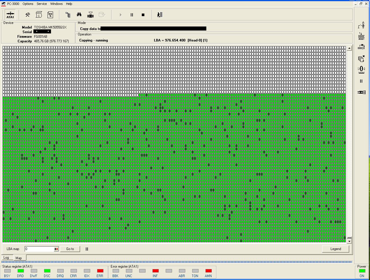

TOSHIBA 5055GSX with a head stiction, after head swap was extremely slow and full of ecc sectors.
Glist not read and not possible to clear it.
Than i swapped secont time, no differences.
THIS behaviour is not localized in a part of the drive, but is the same everywere.

I vote for servo troubles. Dropped drive most probably, I would move the pack (and heads) to WORKING chassis, but I would be EXTRA careful. Further investigation may help....

I've seen this behaviour many times with Toshiba drives, that same pattern on 3K. If you have a ddi then stick it on there, with the right setting it will make light work of it.
On 3K, try setting it to udma 33 and hit the play button to start the copy process. When it starts, power the drive off and back on again with the task still running. Sometimes this is all it needs.

i have tryed Nick_CT smart solution, and it is working - but my drive, that was dropped down, has got too many bad sectors and i have to restart the procedure manually many times - will be a long attended recovery without ddi.
Anyway should be interesting to ask ace support the fixing and the reason..
