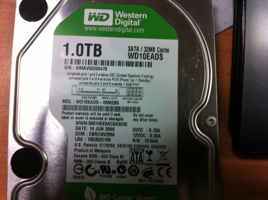

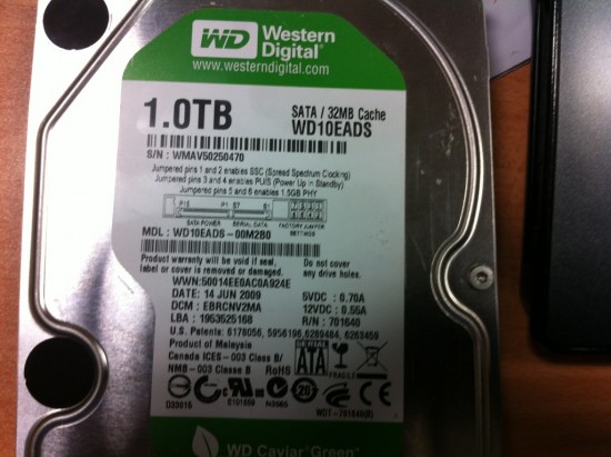

Hi, My WD 1TB HDD Model No.WD10EADS-00M2B0 is failed to start.I have very important data in it and want to recover immediately.Upon showing it to a Data Recovery company,they told me they need same model hard drive in order to replace its head with faulty one and to read the data.
I can see the files in the HDD but unable to copy. Pls urgent help needed and highly appreciate your quick response.

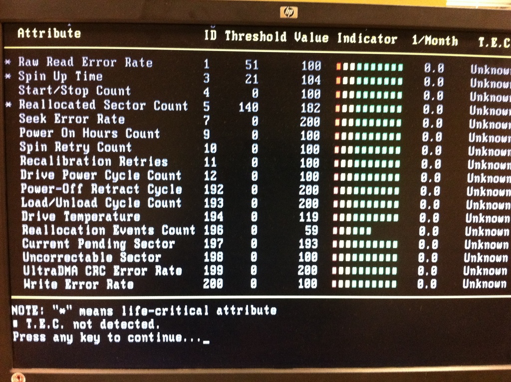

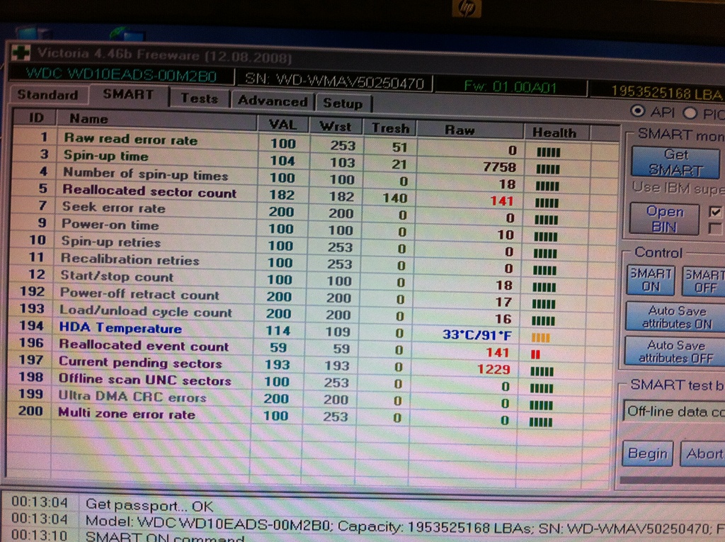

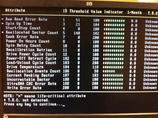

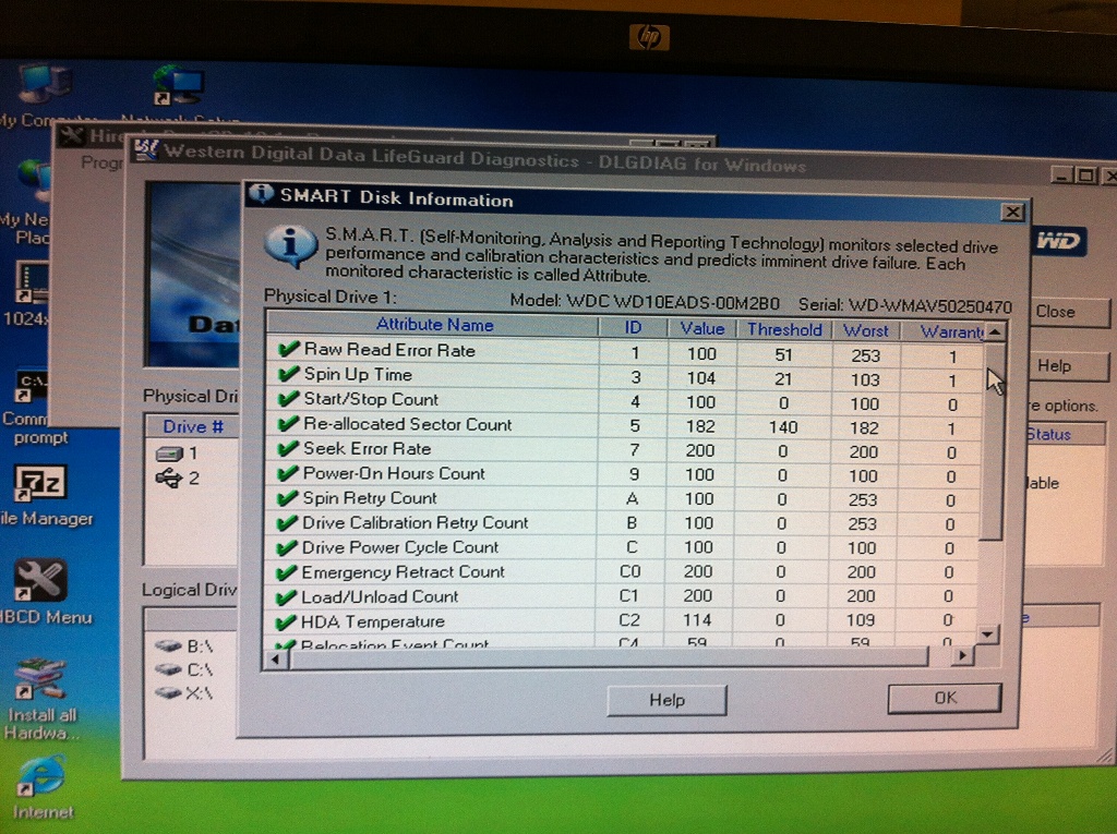

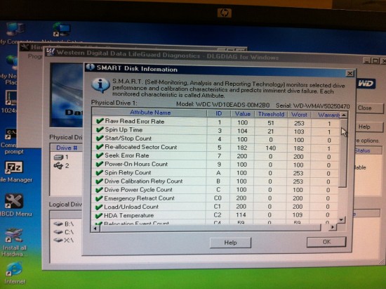

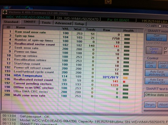

Hi All,Thanks for your contribution.As per fzabkar suggestion, I am attaching the SMART report of the HDD taken through different software.
Pls you can understand it and advice the chances of recovery? Appreciate your support.

Your drive has 141 reallocated sectors and 1229 that are unreadable and are awaiting reallocation. Your only DIY hope is to clone the drive, sector by sector, using a tool such as ddrescue which understands how to work around bad media.
Otherwise, if your drive needs a head swap, then expect to pay a maximum of US$800 plus parts.
That said, try cleaning up the preamp contacts on the PCB with a soft white pencil eraser.
