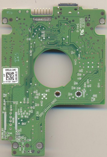

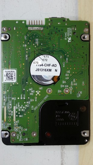

Hello

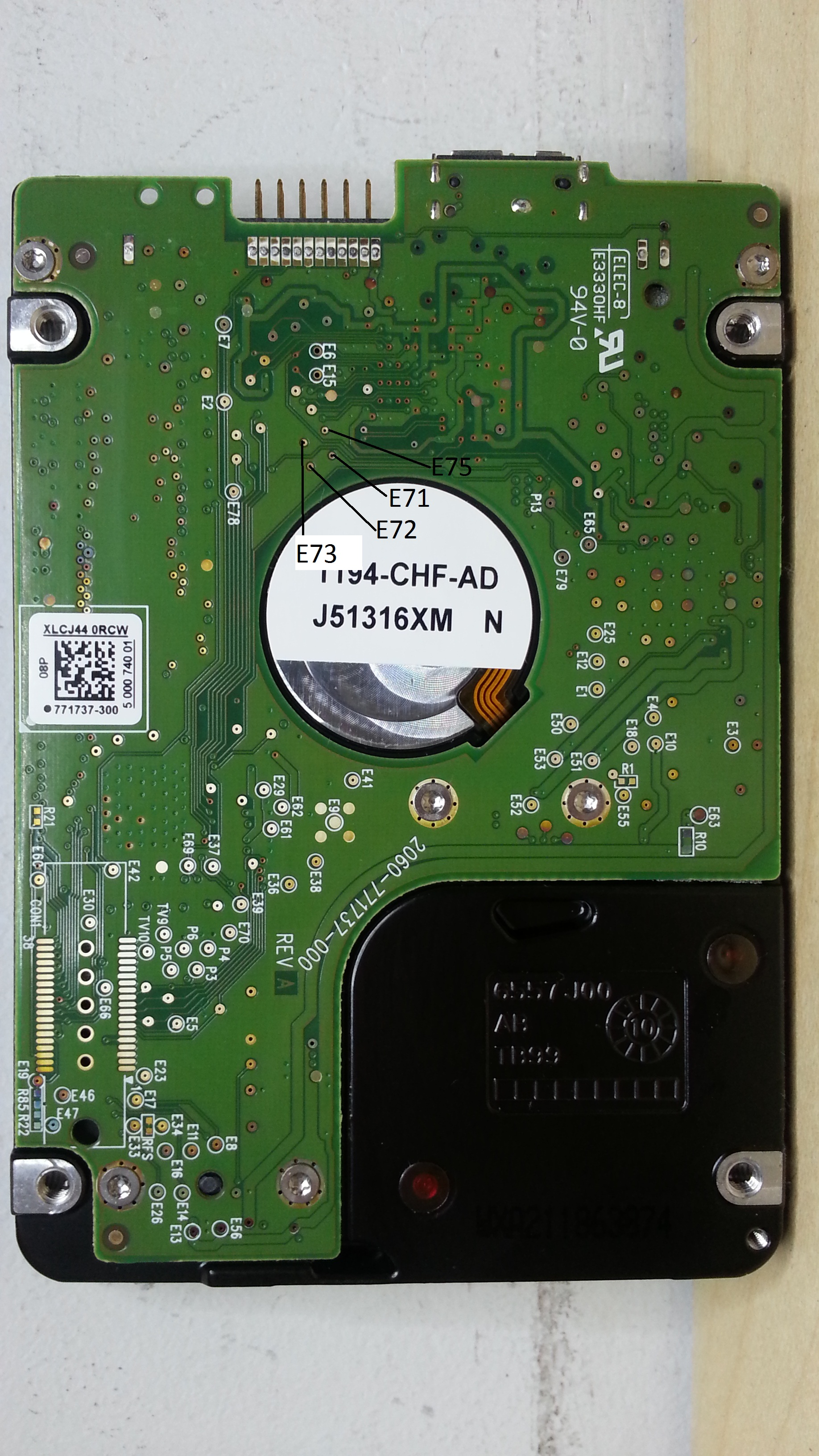

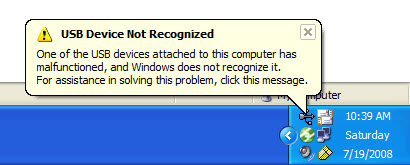

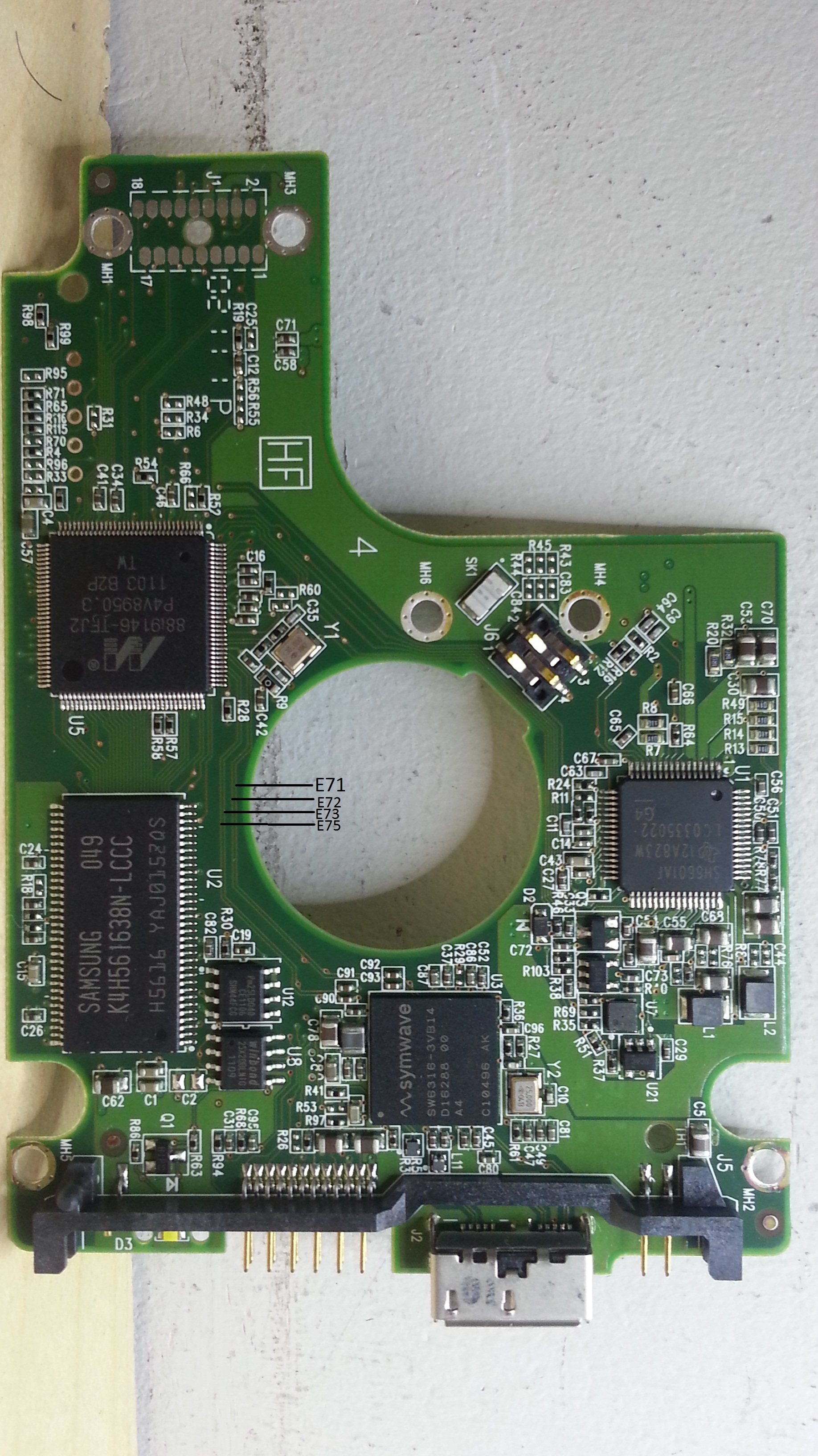

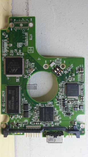

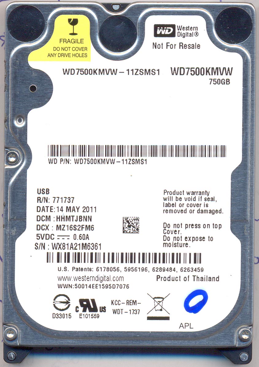

Every Time I,m Connect Western Digital 2.5" My Passport Essential External Display This Error :
And I,m Needed Data On This Hark Disk , How Can i Fix This Problem Or Connect Sata Port For Extract Data ON This Hard Disk , I,m Not Found E71,E72,E73 Connector For Sata Connected .
All Parts Picture :
Thank You For Every Thing .
And Excuse Me For My Bad Write Text , My English Language Is Very Bad . :oops: :(

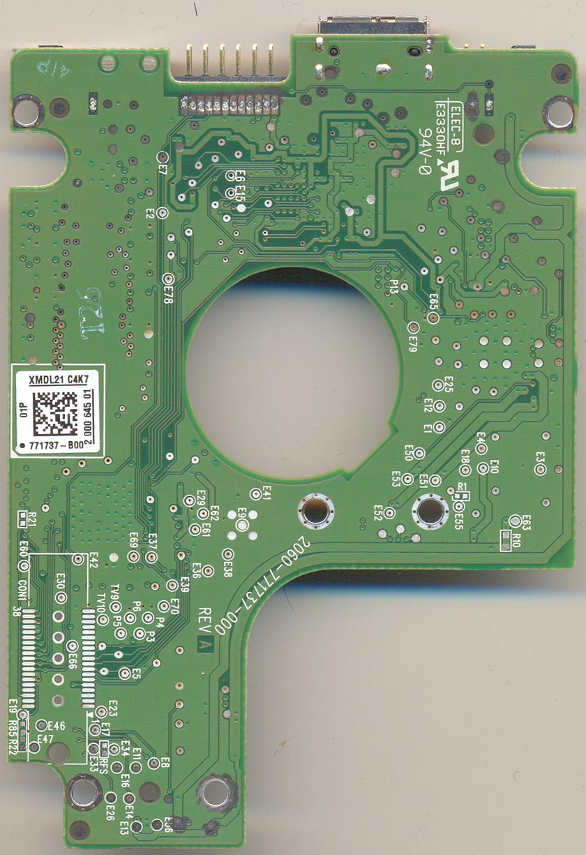

Firstly connecting a sata connection to the pcb will allow you to image the drive but the image / data will be encrypted still as you will be bypassing the encryption chip so this really wont help you too much.
Anyway for info the capacitors you would need to remove are c90, c91, c92 & c93
What you need to do is find & fit a compatible usb pcb & solder the rom at u12 from your old pcb to the donor pcb.
Match the 2060-771737-000 on the back pcb. Try contacting donordrives.com or eric_lee8341@hotmail.com to see if they have one in stock.
Remember DIY comes with risks

The capacitors are C90-C93, and there are 4 plated thruholes on the MCU side of the capacitors.

I can't be sure of the SATA pinout, but it stands to reason that the traces would most likely go directly to the SATA connector without crossing over each other. So just imagine placing a SATA data connector across the Tx/Rx traces ...
Alternatively, locate a SATA PCB with the same MCU chip and follow its SATA traces from MCU to SATA connector. You could apply the same principles to every PCB.

See the SATA Tx/Rx pairs for the following board:
http://pcb-hdd.com/images/WD7500BPVT-60 ... V%20P1.JPG
It has the same MCU as the 771737 PCB. Now follow the same Tx/Rx pairs from the MCU on your PCB to the 4 capacitors near the bridge IC.

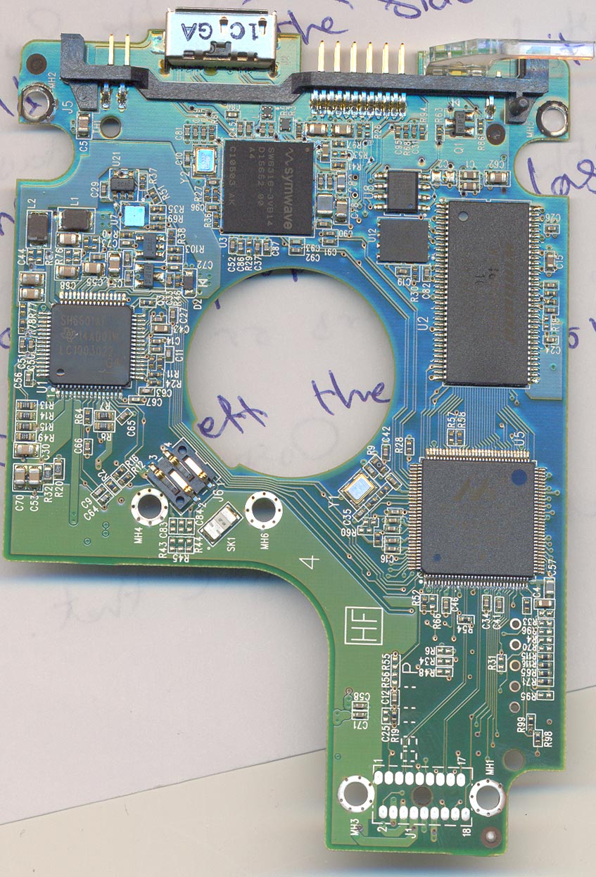

This may help you.
