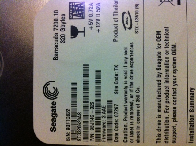

I have a 320GB Seagate Barracuda 7200.10 that has failed on me and I would very much like to try and recover the data on it. I have attached a picture of the drive which includes the model number, firmware version, etc.
I purchased a Nokia CA-42 cable which I was able to use to connect to the serial interface on the back of the drive and get into the diagnostic/firmware terminal. I was hoping someone could help me with commands to run to figure out what exactly is wrong and perhaps if there is a way I could fix it myself.

As you can see I learned some commands from some basic internet research but I was hoping I could get some feedback before trying all sorts of weird things. The other two things I tried were resetting the G-list (T>i4,1,22) and clearing SMART area (1>N1) -- I know what SMART is, I think, but not G-list. Neither of these changed anything. The drive spins up and sounds fine, no weird noises.
I don't think I can afford a data recovery service, but I guess I would consider it. The most critical things are a password safe and some past tax returns/financial documents.
Thanks in advance for any help someone can provide.

Well if you consider professional service, you should STOP sending commands through terminal, especially since you don't have a clue what commands you're sending in.
A one-letter command can kill your drive instantly with zero chances of recovery. Clearing G-List and SMART is not a very good idea and there is chance you have made things worse. If you value your data, stop now. If not, then, well... your data your choice.
After these warnings, I think your drive could still have a lot of chances of recovery, but i'm afraid there aren't many things you can do on your own. Does drive detect on BIOS? I highly doubt it after looking at the terminal output, but just in case.
If it does and you don't want to go to a pro and you accept risks of DIY (ie. loosing all data for ever), then you could try imaging using some non-windows utility like ddrescue and then go from there. Again (and AGAIN and AGAIN) this is very dangerous and you could end up with a non-recoverable drive (or much more expensive to recover).
If you want to go to a pro, i could look at it but i'm too far away, you can contact members jono-ats and thatdellguy they should be able to help.
At this point it shouldnt cost you an arm and a leg.
Whatever you choose, good luck.

This is a common problem, and no there is not anything you can do to fix it through terminal commands.

Modifying the drive's firmware to prevent it from doing what is causing it to not init successfully
Possibly also replacing heads

The firmware in question is not on the PCB, it is on the platters. So a PCB swap would be futile.
There is nothing you can do without the proper (expensive) tools and know how on this case I'm afraid.
Shouldnt be mega bucks for pro help on this one AT THIS STAGE, assuming it's not diy'd to death!
