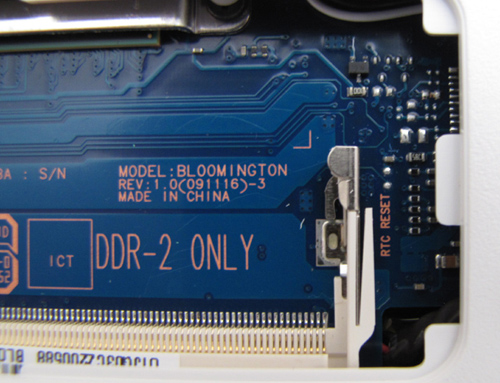

If you can get access to where the RAM is, does it say RTC Reset.
If it does you can try to briefly short out the RTC Reset pins with the tip of a screwdriver. Then enter the bios with [F2] and save bios defaults.
Not sure if you will then be able to remove the HDD password

& Loki
what you mentioned applies to Bios Pass not HDD (just to clarify my dear) :wink:
Yeah I noticed, So I edited the last bit while you were typing your reply.
