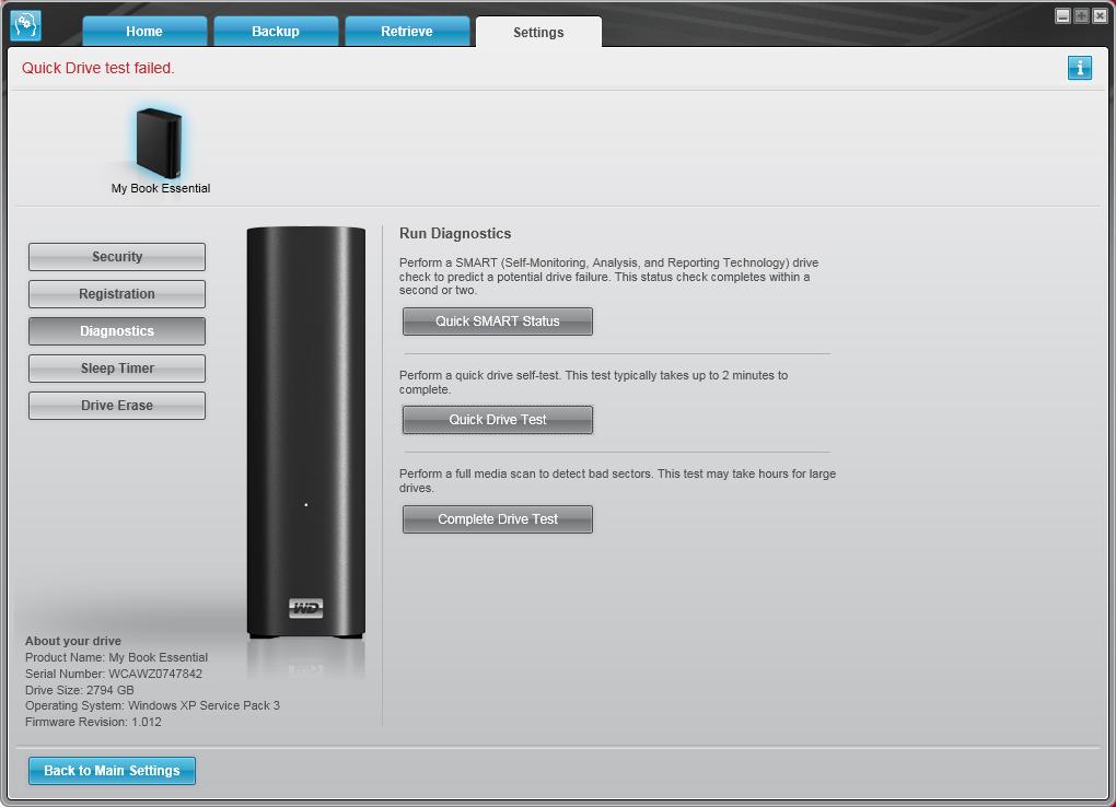

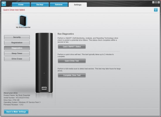

While running the WD (WesternDigital) SmartWare “Complete Drive Test” diagnostic on my 3TB My Book Essential (WDBACW0030HBK-NESN ) the following error popped up:
“Windows – Delayed Write Failed : Windows was unable to save all the data for the file H:\$Mft. The data has been lost. This error may be caused by a failure of your computer hardware or network connection. Please try to save this file elsewhere.”
After this neither my computer, nor any other computer recognizes my USB drive as a volume. It’s as if it has no formatting, no partition, nothing. Is my data toast? If not is it possible to recover it myself? If not can a pro do it?
History:
I’m running Win XP SP3.
I’ve had the drive just under a year. I use it moderately, maybe a few times per week to move/transfer/store data. When I’m not using it I keep it disconnected from my computer. About a week ago it started making a “clicking” noise, not the same as the sound of the head. I could even feel the “thump” through the plastic case. The noise was not present while the drive was being accessed, but only when idle for more than a minute, or so. I plugged it into a different computer with same results. I figured it was time to run a diagnostic, and then send the drive in to WD for a replacement.
I installed the accompanying WD SmartWare software, which said that my hdd firmware was outdated, so I updated it. Then it suggested I update the software since it was old, which in tern said I had to have “Microsoft .NET Framework 4 or higher” as well as “Internet Explorer 7 or higher” so I installed those as well, even though after decades of computing I've never needed these applications.
“Quick SMART Status” in the WD SmartWare diagnostic utility showed as all normal. Next I ran the “Quick Drive Test.” Result was “FAIL”. (see attached image)
File comment: WD SmartWare diag utility: Quick Drive Test (FAIL)
Ok. Failed what? After starting the last offered test “Complete Drive Test” I realized these diag utilities aren’t going to tell my anything except if it passes, or fails. While the test was running I read about the “Data Lifeguard Diagnostics (WinDLG)” utility, decided to download it and use this instead since it at least offers a log file. I attempted to cancel the “Complete Drive Test” in the WD SmartWare diag utility by clicking the “cancel” button. It said “canceling” in the status window and stayed like that, but it still seemed that the drive was being accessed, so I left it alone. More than an hour later the test was still “canceling” and the application seemed to have hung. I lost patience and ended the WD application and process from Win Task Manager. That’s when the “Delayed Write Failed” error popped up. After that my drive is no longer recognized as a volume. Win Device Manager shows it as “WD My Book 1140 USB Device”, but no volumes exist, no drive letter, etc. (see attached image)

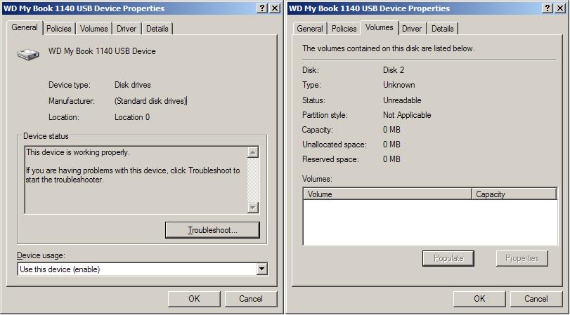

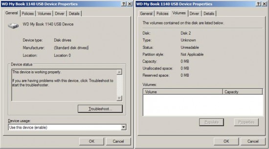

File comment: Device manager status for the USB drive after error.
Win Explorer does not see the drive at all. WD SmartWare sees the drive as blank, but it’s grayed out and unable to do anything with it. The drive, when plugged in, spins-up fine, no weird noises. I can eject it as a "USB mass storage device". As far as hardware, I think it’s still ok. I’m pretty sure the drive is corrupted only.

Actually, instead of running a diagnostic, this was the best time (if you were going to take the risks of DIY) to get your data off the drive, before things got worse - which they unfortunately have done. :(
From the rest of your story, the drive seems to have been "diagnosed to death" (i.e. the time when it was "limping along but dying" was spent running diags, until it failed even more severely), since Windows Device Manager no longer recognises the drive correctly. Further checks could be done, but seeing that things have already degraded, I suggest you stop here to avoid making the situation even worse by trying to do yet more diagnosis.
I politely disagree. If this was only (user data) corruption, then the drive itself would still be reported correctly in Device Manager. The "clicking" that you reported also does not fit with the problem being corruption. Based on the reported symptoms, there is an internal drive problem and therefore any software recovery tools, like the one you mentioned, will be useless.

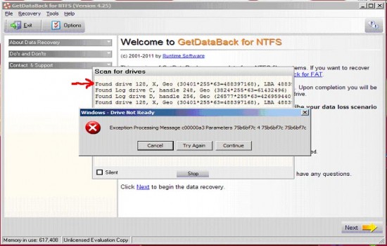

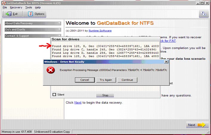

Yep. I think the worse-case is confirmed after I confirmed that the BIOS is not seeing the drive and GetDataBack indicates that a "drive is not ready" and shows an exception error message. I'm assuming that's my USB external drive. I've tried the same checks on two different computers.
File comment: GetDataBack (drive not ready)

The drive marked with a red arrow on GDB screenshot shows 250GB of space, not 3TB.
 Post subject: Re: WD External Hdd Currupted After “Win – Delayed Write Fai
PostPosted: May 24th, 2012, 22:25
Joined: May 18th, 2012, 4:00
Location: California
Northwind:
Roger that. Must be my internal hdd, and its two partitions (C and D). Not even seeing the 3TB, which confirms it all the more.
