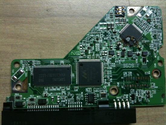

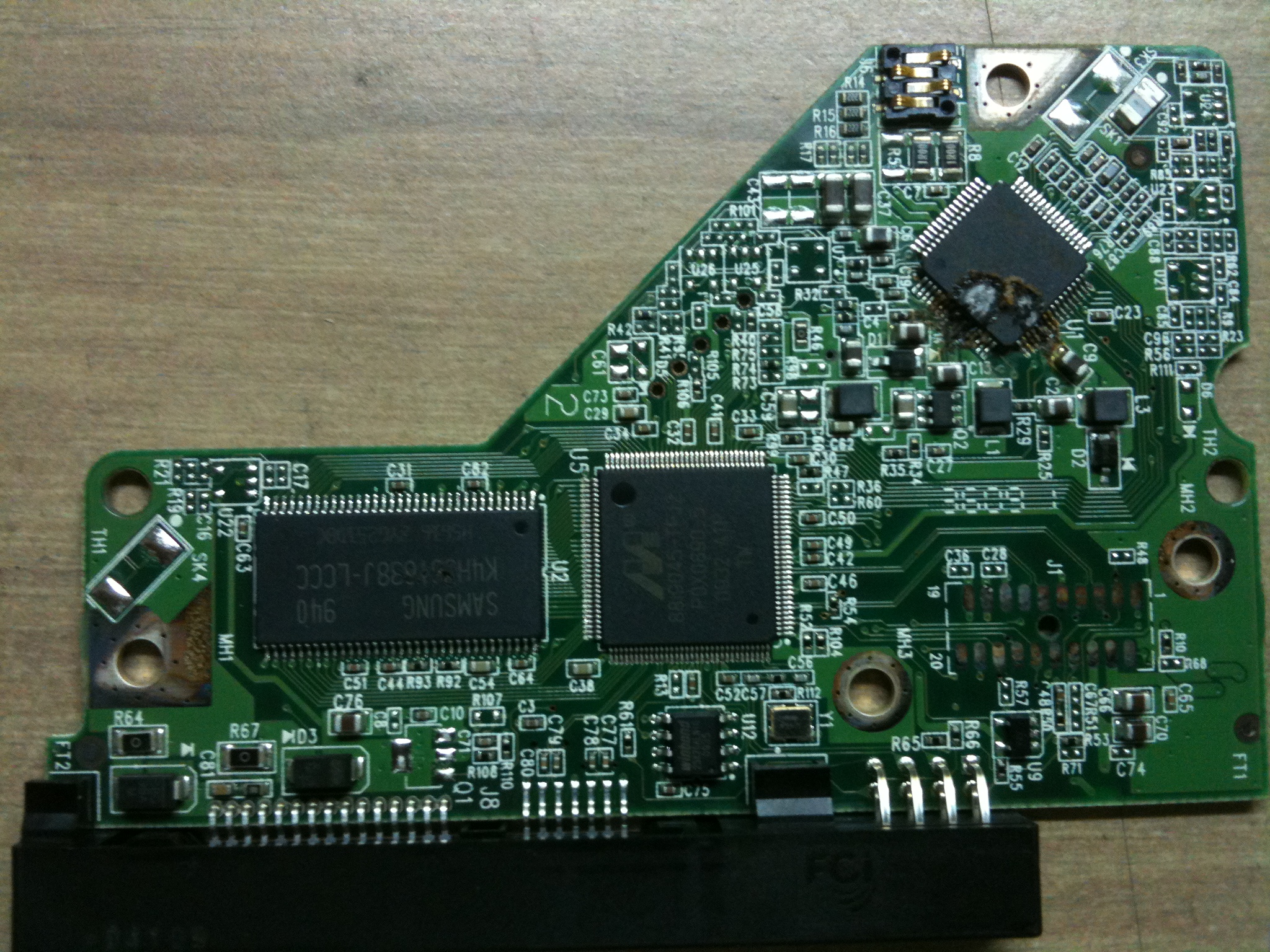

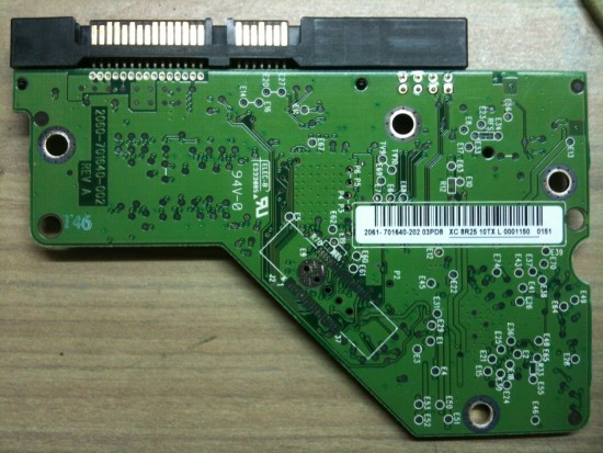

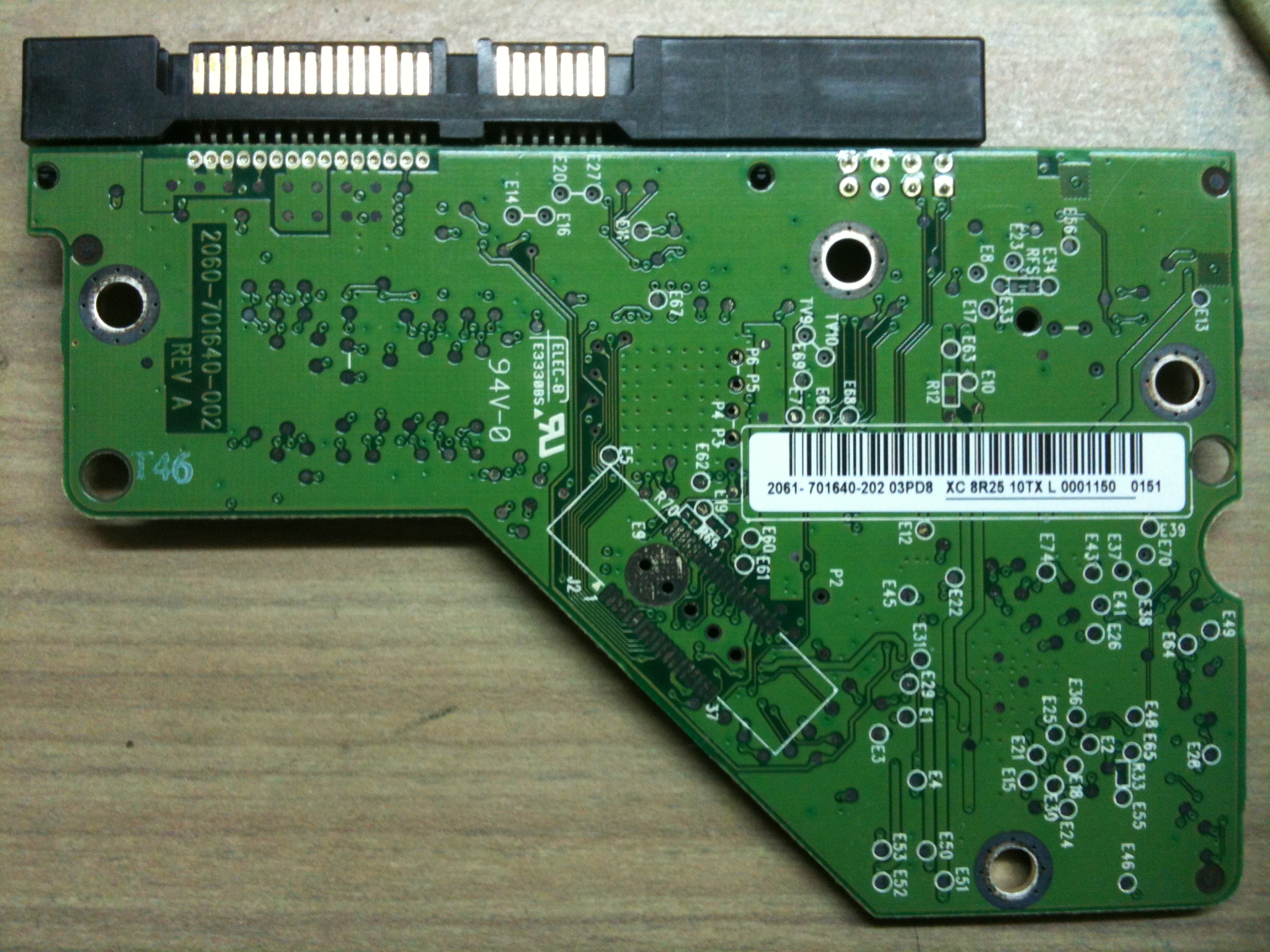

I have 1TB WD10EADS drive which not working for now after I put in the built-in front SATA dock in my case. After check in PCB board, I found that smooth chip was fired :-( (I also attach picture of PCB).
I have a multimeter for now, is it possible to make a DIY test for this PCB board (such as test a preamp or diode resistance)
And what can i do to get my data from this drive. Switch and transfer eerom to a donor board?
Thank you

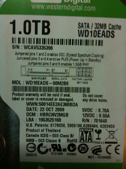

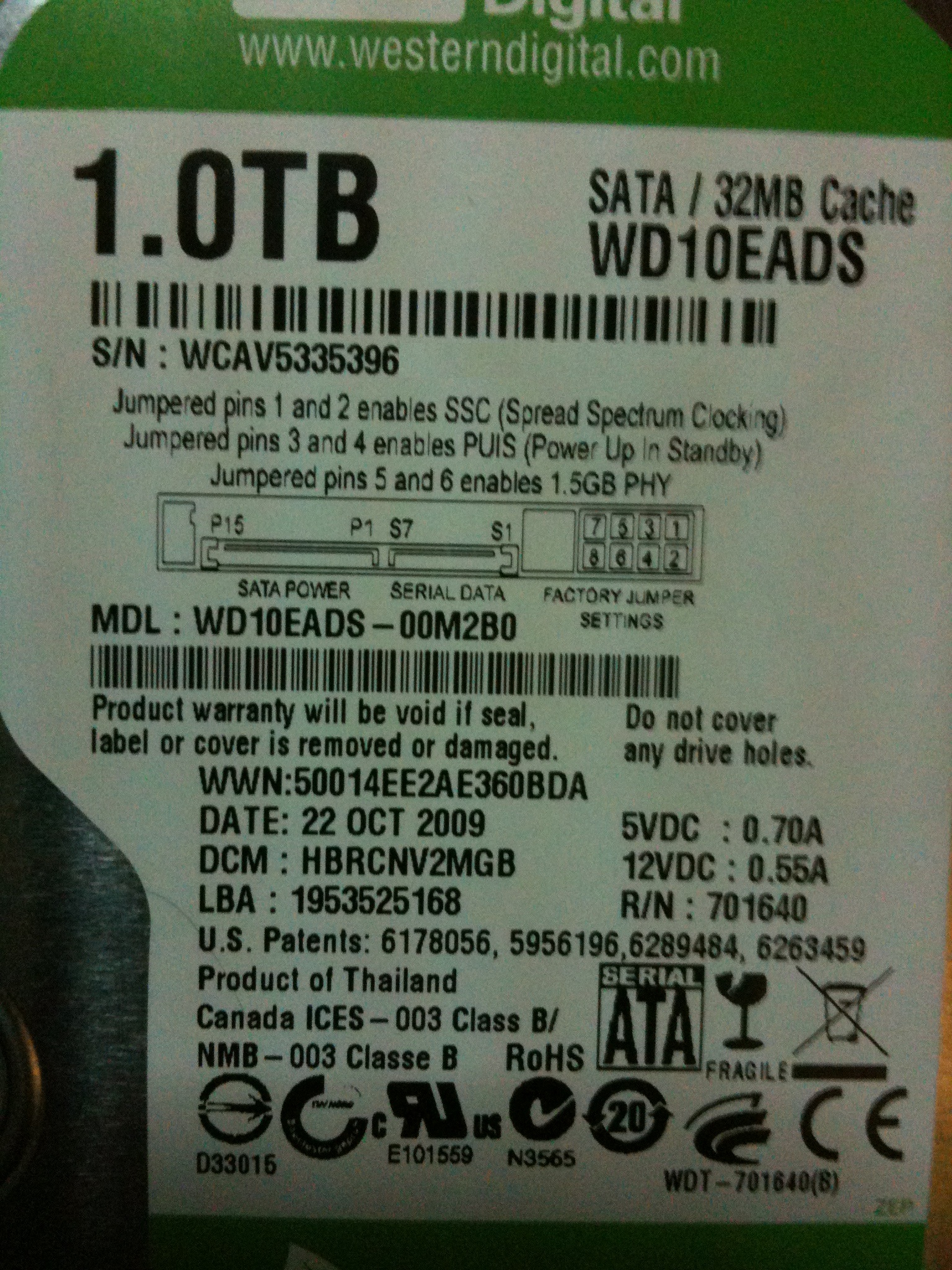

Here is my drive detail
WD10EADS-00M2B0
WWN : 50014EE2AE360BDA
Date : 22 oct 2009
DCM : HBRCNV2MGB
LBA : 1953525168
Product of Thailand
PCB 2060-701640-002 REV A
Sticker 2061-701640-202 03PD8 XC 8R25 10TX L 0001150 0151

No need to test the smooth chip is fried and so the motor will not turn (motor controller chip) so get a new PCB and swap out your ROM

If you are unable to transfer the 8-pin flash memory chip at location U12, then the following PCB supplier will do it for you for free:
http://www.donordrives.com

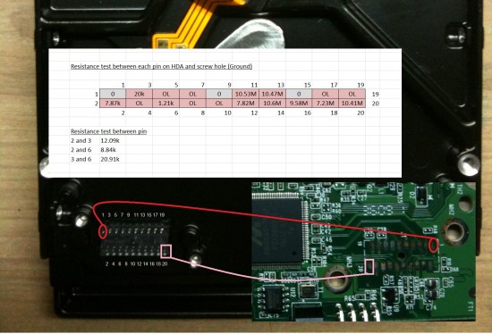

It is quite possible that your preamp is damaged. However another user with similar SMOOTH damage managed to recover his data, so with any luck you may get out of trouble for only US$50.
If you need a head swap, then contact http://myharddrivedied.com. They offer fixed price data recovery for US$800 plus parts. The proprietor, Scott Moulton, is a valued member of this forum.
As for resistance tests, set your multimeter on the 200 ohms scale and measure the resistance between pin #2 (Ground) and each of pins #4 and #6 on the 20-pin HDA connector on the body of the drive. This connector mates with the J1 contacts on the PCB.
Pins 4 & 6 are the positive and negative supplies for the preamp. I believe pin #2 is Ground, but you may like to confirm this by testing for continuity with a known PCB ground, eg the screw holes.

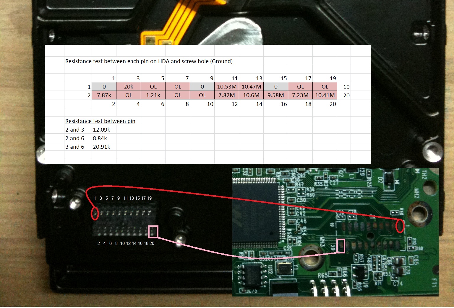

Thank you for your testing step.
Here is the testing result.
I use multimeter to make a resistance testing with my 20 pin connector on my drive. I am not sure what is number of each pin, so I label in the picture and do a resistance testing on every pin. I think Pins #1 (in my pic) on HDA connector is ground because the resistance between screw hole on HDA is close to zero.
Am I doing it correctly ? If you want me to test another thing, please tell me.

Thanks. It appears from your measurements that pin #1 is ground, not pin #2.
Pin #4 and #6 must be the supplies, in which case there is no short circuit to ground. This doesn't prove that the preamp isn't damaged, but it is probably OK.
The motor controller chip isn't damaged on the side that drives the spindle motor, but you still might like to confirm the resistance readings between each of the motor terminals. There will be three windings and one common terminal. The winding-to-winding resistance should be twice the winding-to-common resistance. A value of the order of 1 ohm is OK. If one winding differs significantly from the others, then that would be reason for concern. Otherwise if the motor tests OK, then go ahead and order a new board ... with a firmware transfer.

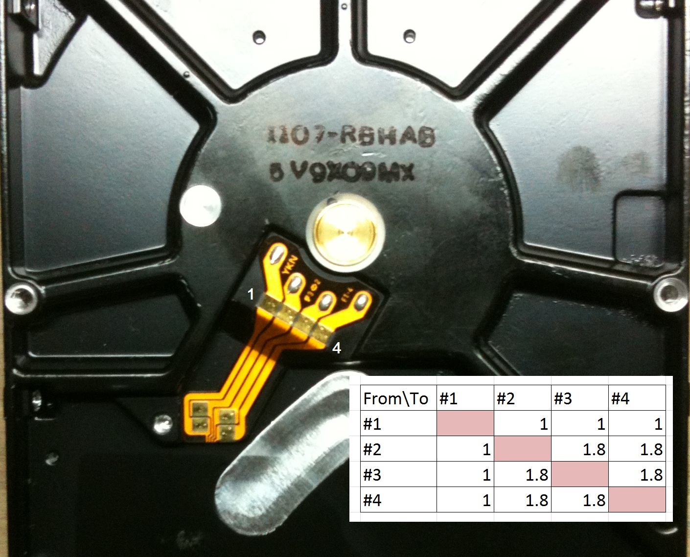

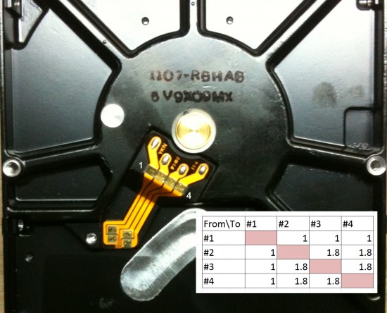

Here is the motor terminals testing result. I think it OK.
Do you think that, it is possible for DIY fixing ? I really worry about preamp which I cannot change it my self.
Should I start order a new PCB board or not?
Thank you

 Post subject: Re: WD10EADS smooth chip is fired
PostPosted: May 27th, 2012, 6:00
Posts: 17339
I agree, the motor seems OK. And yes, go ahead and order a board (and firmware transfer).
Very best of luck.
PostPosted: May 27th, 2012, 10:14
Posts: 1748
According to the motor chip condition, there's high possibility that the preamp is damaged as well.
Replace the PCB, transfer the original ROM and I wish you luck ( which you will need it )
