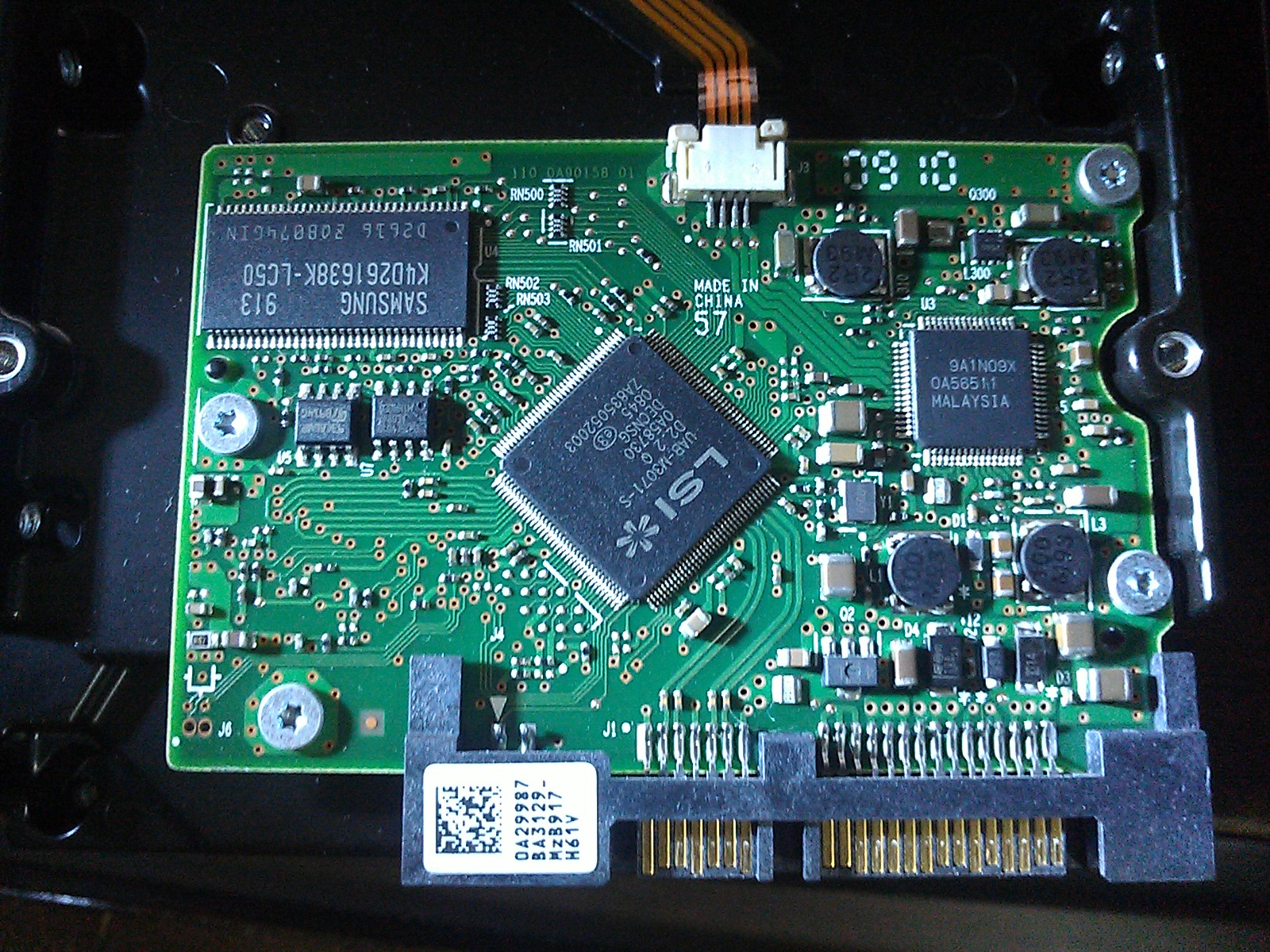

 Post subject: Need help on my Hitachi 1TB, I connected wrong voltage plug
PostPosted: May 17th, 2012, 7:31
Joined: May 17th, 2012, 5:07
Location: Singapore
Hitachi 1TB SATA 3:
HDT721010SLA360 / OA37993
White sticker on PCB: 0A29987 BA3129
CPU controller:UAB-M3071-S / OA58730
Let me know if you have stock, or how can I repair, is it just swap and it will work?
SMS me at 97561406 -Adnan Singapore
Let me know the price. anyone in Spore can help? or shop in spore?
Used (good working condition) or new.
Or you wanna loan me? I need to retrived my Holiday photos.
No, did you search this forum at all before posting? You will need to swap the ROM chip. And that is ASSUMING that the only problem is a bad PCB.
Search around, some places that sell PCBs will do the ROM chip swap for you (if you can't do it yourself).
