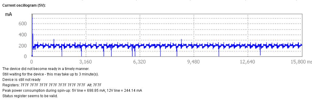

this is a 1.8" micro sata drive. fusible link was blown and replaced. now disk will not spin up. There is no typical "servo strain" noise from the series of attempts a disk normally makes before giving up.
The current trace looks like something is going on.
Q. is it possible to be stiction or spindle with NO sound?
If no is the answer, I am guessing the PCB is bad.
Thanks for your time ;)

Sounds like a bad PCB. Look there for the problem. If it was stiction, there'd be current spikes much greater then what is shown above.

I'm curious as to how your diagnostic tool can record a 244mA current draw from 12V (since the drive is rated for 700mA at 3.3V).
This leads me to ask, is the drive receiving power on its 3.3V SATA pins?

Great question fzabkar. I made a voltage converter to power 3.3V out from my Atola Insight Box, it also passes 12v straight through, I would guess theses are parasitic signals. (Btw the converter is just a simple LM317T, works great).
I agree, the current spike would be larger with stiction or spindle. and they should stop after 5 or 6 tries as the respective controllers give up.
Any pointers where to look on the PCB, it all "looks" fine. I can also bet the adaptives are in the Marvel chip, so no easy swap.
Thanks!

I normally look for voltage test points in the vicinity of the transistors and coils/inductors. Coils are the landmarks for switchmode DC-DC converters, whereas NPN transistors are often used as pass transistors in linear regulators. There may also be three-terminal LDO regulators. I'd also be measuring the resistance at the output of each DC-DC converter. That should give you an idea whether the MCU and motor controller are alive. The latter IC also controls the DC-DC converters.
If you can find the current sense resistor(s) for the spindle motor, then the voltage across them should be proportional to the motor current. You can also locate the various onboard supplies by referring to the datasheets of known components. For example, pin #1 is usually the Vcc pin of an SDRAM, as is the bottom pin on the same side.
BTW, IMO Atola's developers should revisit their design. ISTM that any tool that measures 244mA into an open circuit has a problem with Ohm's Law.

That was most likely due to a spike from a capacitor charge on power on. There is a small cap after the current measuring sensor in our units.
