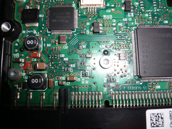

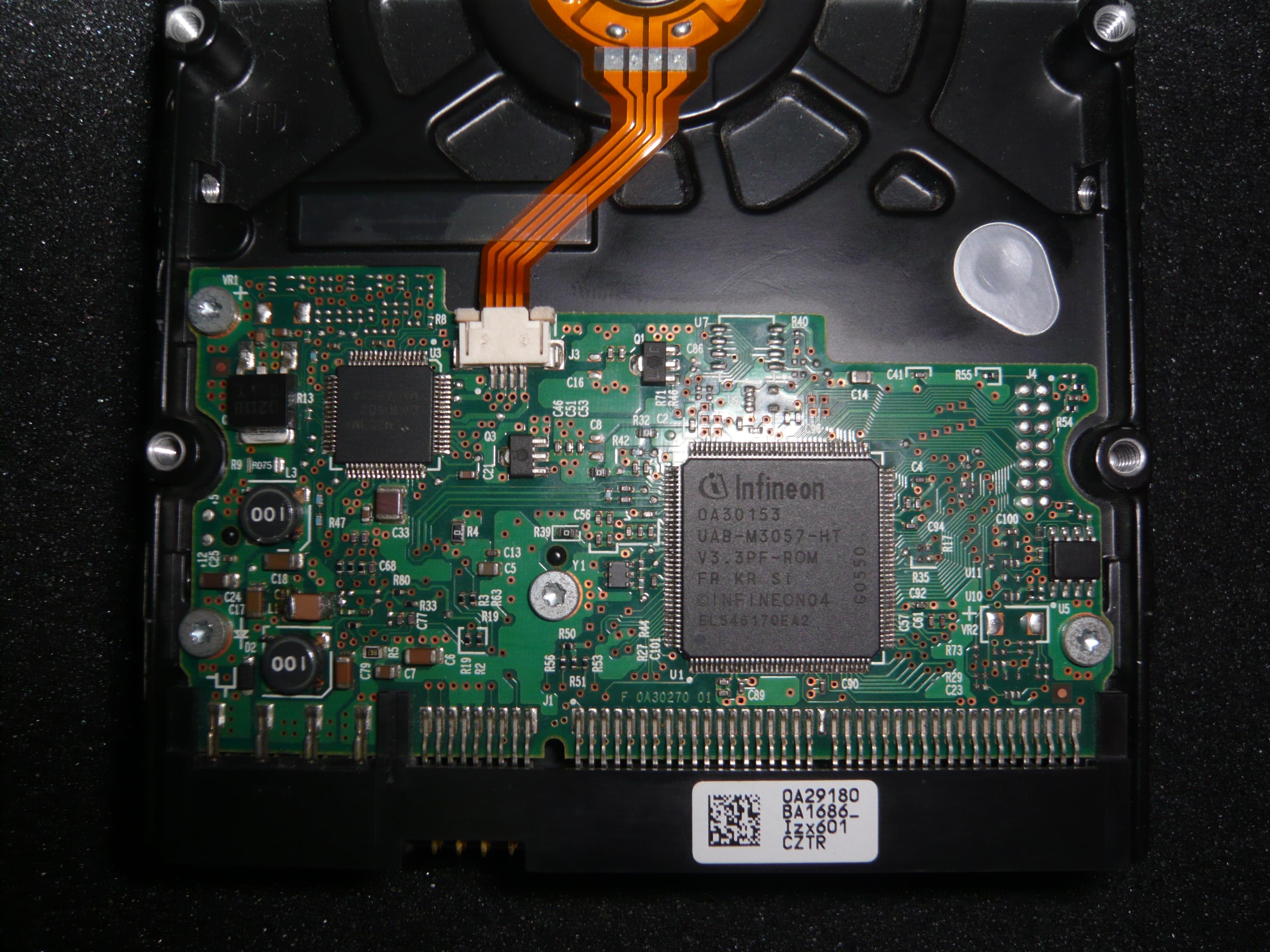

My PSU died and when I was trying to turn on my PC I notices that my hard disk had died too. He doesn't make any sound, he doesn't receive power, It doesn't spin...NOTHING. I guess it could be the PCB but it doesn't have a particular smell of something burned. I send it to a electronic technician and he measured and it seems that a diode was shorted, but i don't know if he tried to replace it or what, but he didn't even charge for the service, I guess he did nothing. He told me that it has an internal problem (He doesn't spin...No power!!! how can he know that
? I guess he didn't want to work on it)

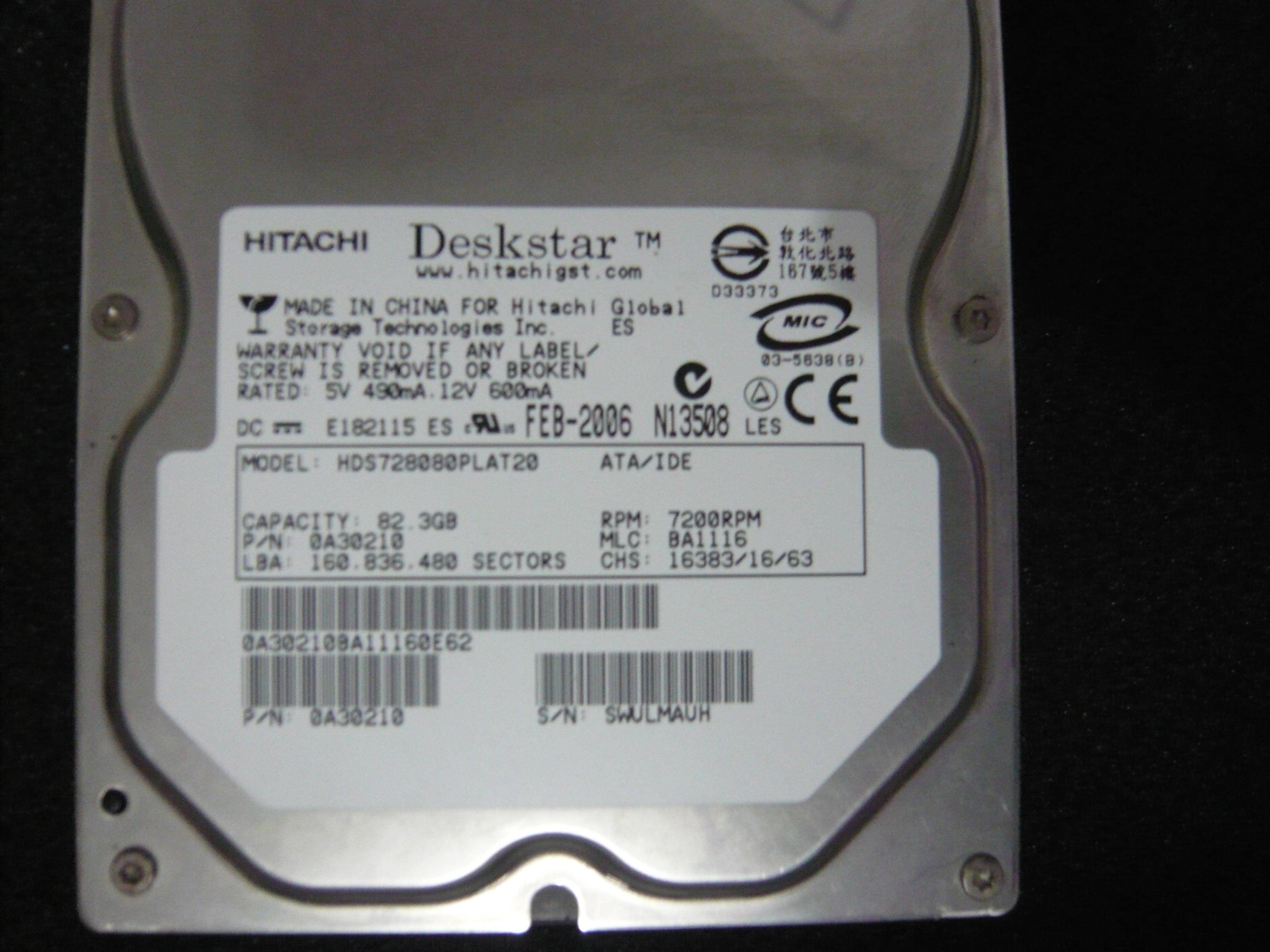

Well I have a donor, but I don't know what to do, I have read they have to match with the two lines of a sticker he has behind, also other things. I also hear they have to swap the NVRAM. I would like more info about it. I will post some pictures here. Plase I would like to recover some info but the companies who do this charge a lot of money. I would like to inform myself in order to guide a technician about this particular model, where I live, they don't usually repair hard drives. Thanks in advance!!!

The NVRAM is the 8-pin IC at location U5 at the right side of the PCB. This chip will need to be transferred to your donor board.
As for the shorted diode, do you have a multimeter? Did the technician tell you which diode was shorted? Diode D2 near the front left corner of the board appears to be a 12V TVS diode.
There are several photo clips here:
http://www.users.on.net/~fzabkar/HDD

The following site has PCB matching information:
http://www.donordrives.com/hard-drive-p ... swap-match
http://www.donordrives.com/blog/pcbswapguide

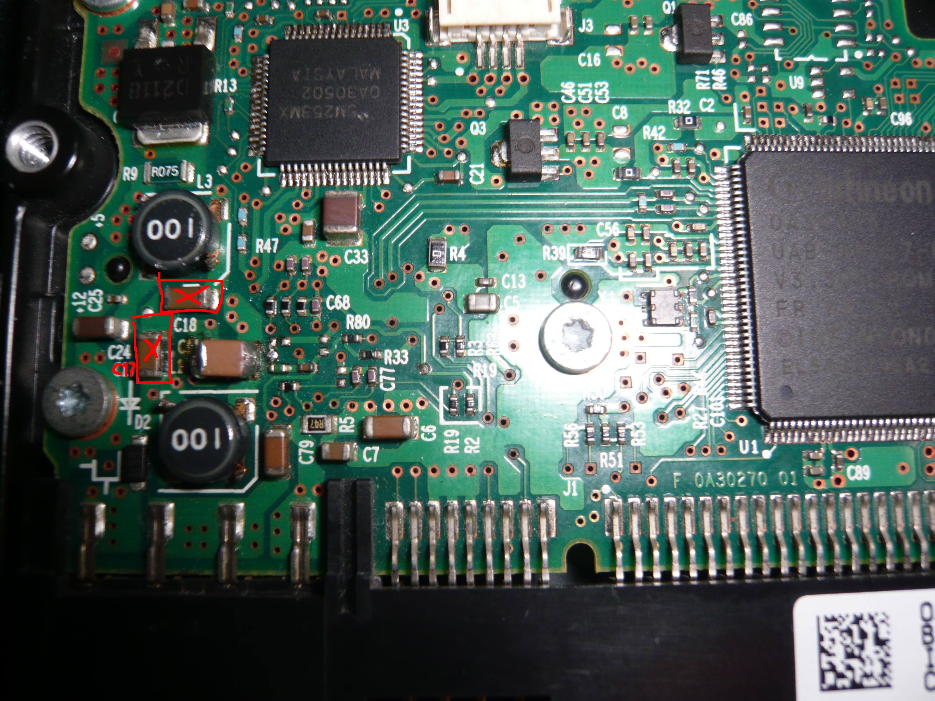

My FAQ has the required information. After you have measured the diode, then we will be able to narrow down the problem.
 Post subject: Re: Hitachi HDS728080PLAT20 Possible damaged PCB?
PostPosted: May 25th, 2012, 21:53
Joined: May 15th, 2012, 22:44
Posts: 9
Location: Barranquilla
C17 and C18 don't measure anything. The TVS are right.
