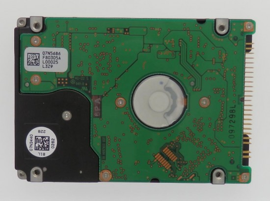

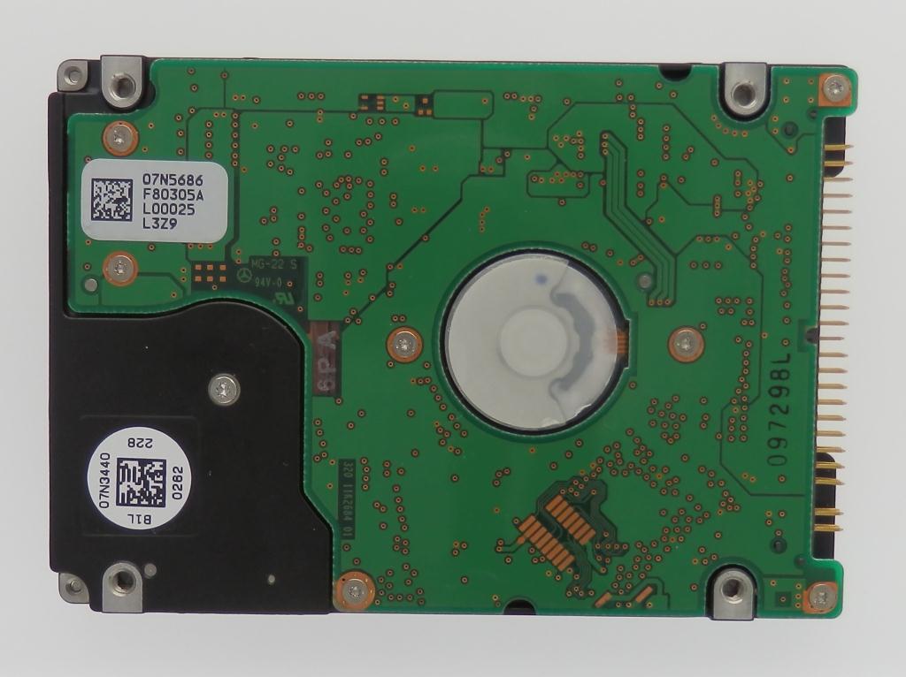

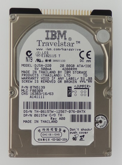

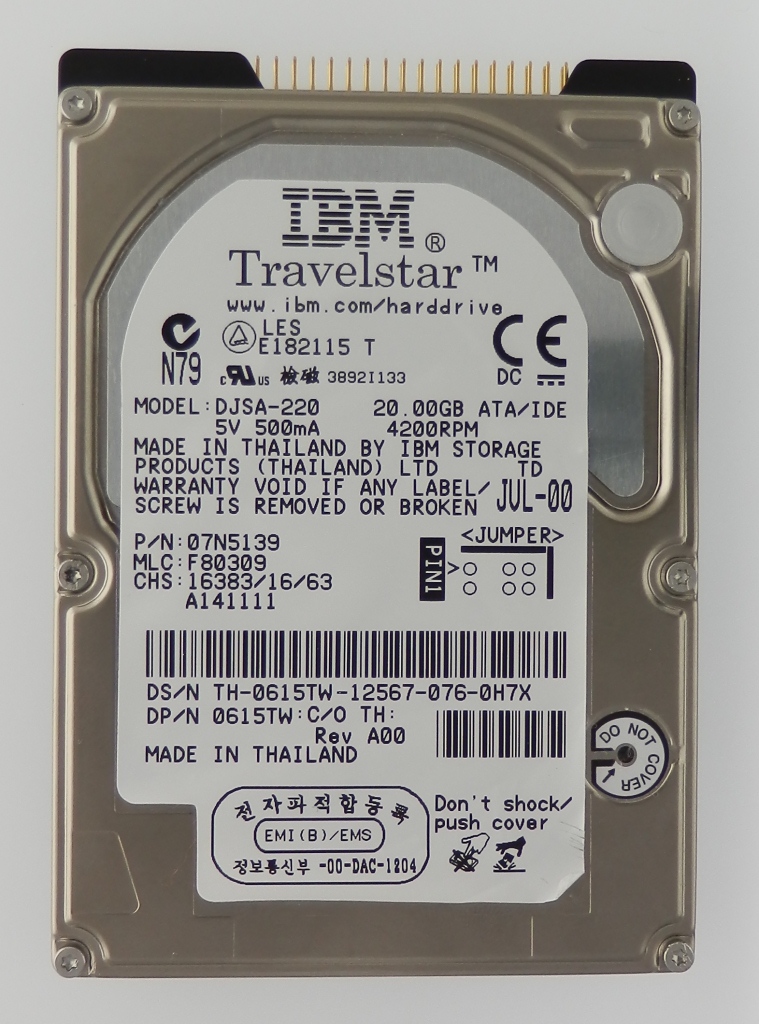

Noob here,
I'm trying to find replacement parts for an older HDD I crashed a long-long time ago (like 7 years ago) - photos attached.
After a hard drop, the drive quit working and all I get is the click of death. I'm not sure if a simple PCB swap will fix the problem, or if I also need to try a head swap? Over the years, I got bored, opened the case and practiced head removal/installation (I know not a great idea); so I probably need to replace the heads as they have contacted one another in the past...
Good news - the platters appear to be in good condition, but the heads may be damaged due to my "tinkering." I was hoping you could tell me which manufacturer numbers any replacement parts must match. Instructions regarding how to verify that the PCB is properly functioning would also be appreciated.
I purchased the adapter that allows me to plug the HDD into the IDE slot on my desktop computer. After many years, the drive still powers up and the click-of-death is still there (not that I expected it to go away). I have performed a recovery in the past on a different drive with corrupt MFT using Runtime GetDataBack software and that went excellent. RECOMMENDATIONS regarding the best SOFTWARE and DATA RECOVERY COMPANIES would also be appreciated!
Good advice is always appreciated!
Thanks for your help. Ah, the youthful ignorance of an aspiring engineer... :(
DRIVE DETAILS
Top Label
IBM Travelstar
MODEL: DJSA-220 (20.00 GB)
Made in Thailand
MFG: JUL-00
P/N: 07N5139
MLC: F80309
PCB Label
07N5686
F80305A
L00025
L3Z9

Very unlikely it is a PCB issue

So, to sum it all up:
A drive (which by the way is not the easiest around) with -possibly- bad heads,
has been opened in a non-controlled environment,
had its heads removed by someone with zero experience in the field
then had heads installed again by same person
and now will have heads re-removed and re-reinstalled by the same person.
No offense.
Chances you will recover a single byte is .... zero? OK, to be fair, it is 0.5%.
Let me explain why.
You opened the drive in non-controlled environment. Contamination. Dust, humidity, debris etc are now on the platter. It would take a long time to explain the consequences of this, but it's more or less what Keetah says above.
Then you moved heads without tools and experience and as i understand you just moved heads out of their parking area. With no other precaution. This most probably means media damage (ie. game over).
Then you re-installed heads, moving them to the parking area, and heads were already damaged. So more media damage.
Should I go on?
