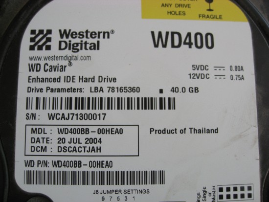

Hi to all! New here and not sure if I've come to the right place.
I have an older PC which ran a WD400 CAVIAR EIDE 40 GB HDD.
It has been on 24/7 for the past 6-7 years.

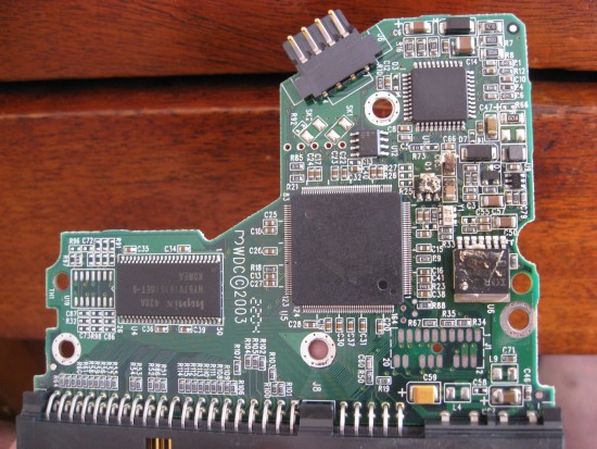

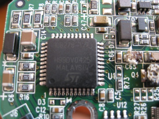

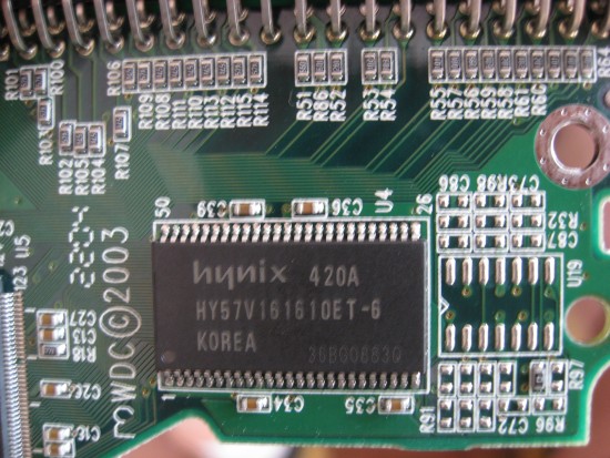

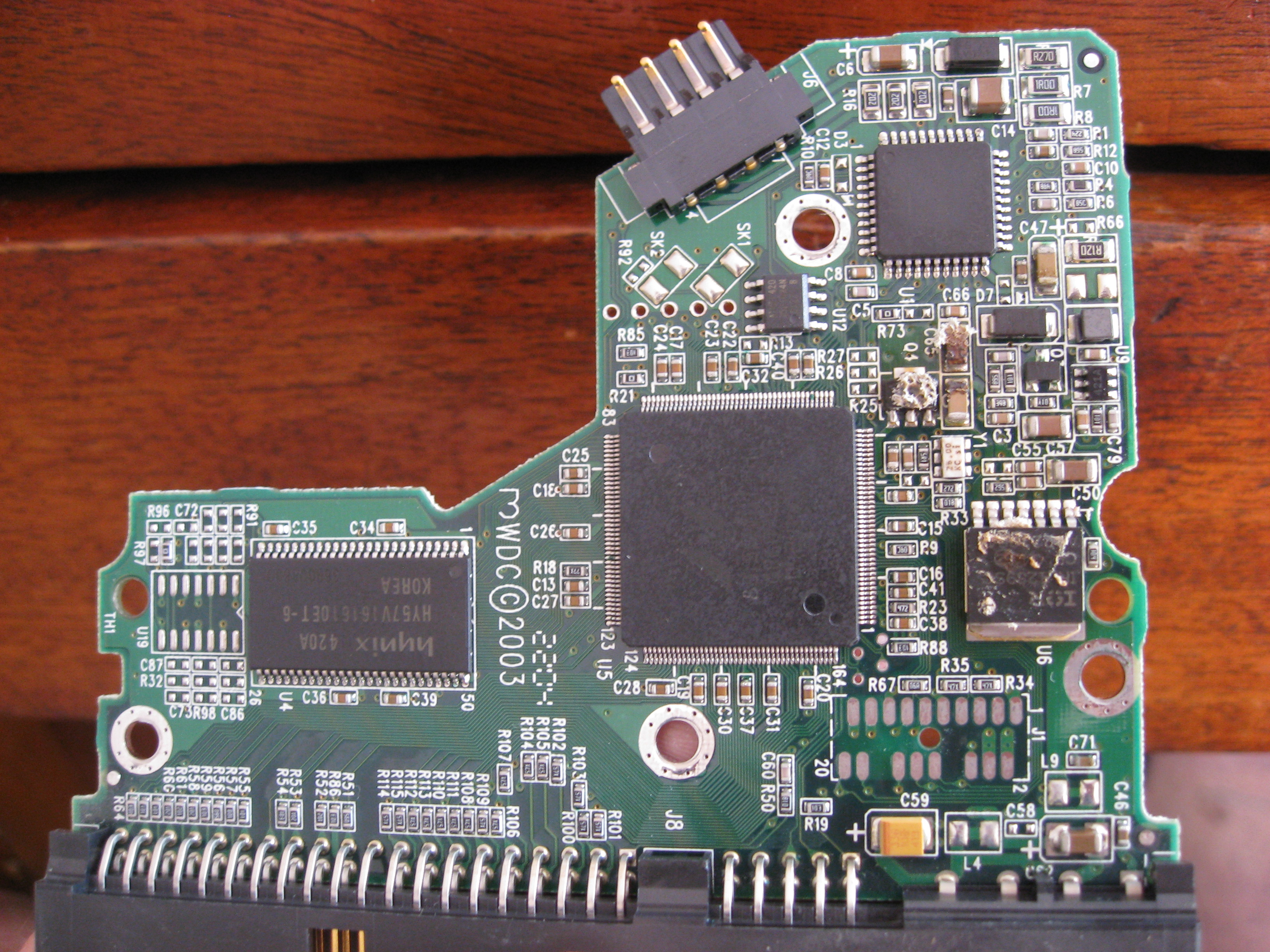

Could we see a detailed photo of the component side of the board?
 Post subject: Re: cWD400 Reovery
PostPosted: May 26th, 2012, 8:48
Joined: May 22nd, 2012, 10:11
Posts: 15
Location: New York

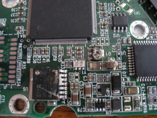

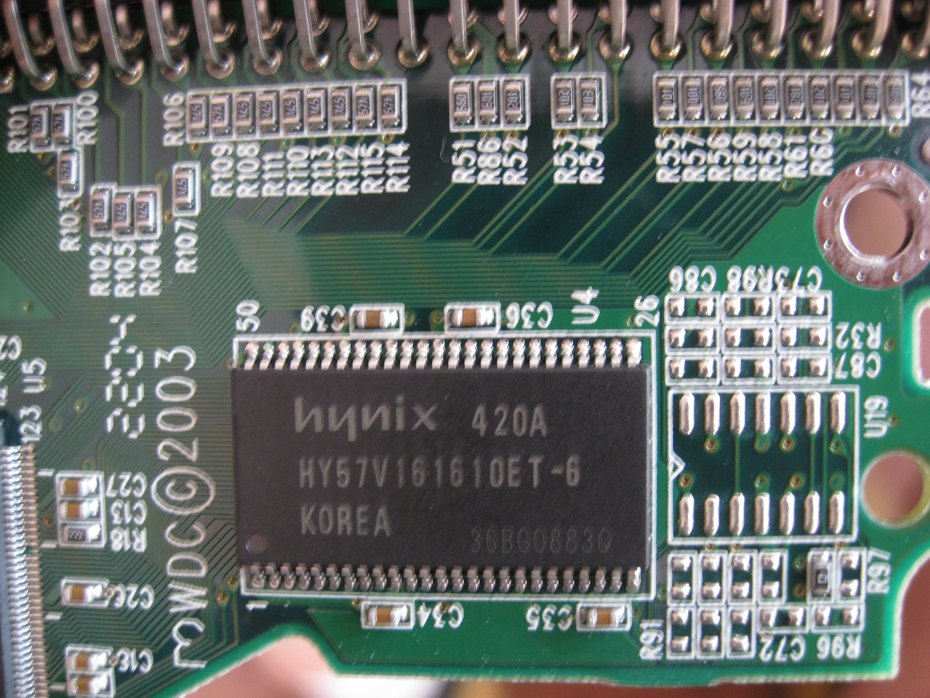

PostPosted: May 26th, 2012, 8:50
Posts: 15
Location: New York

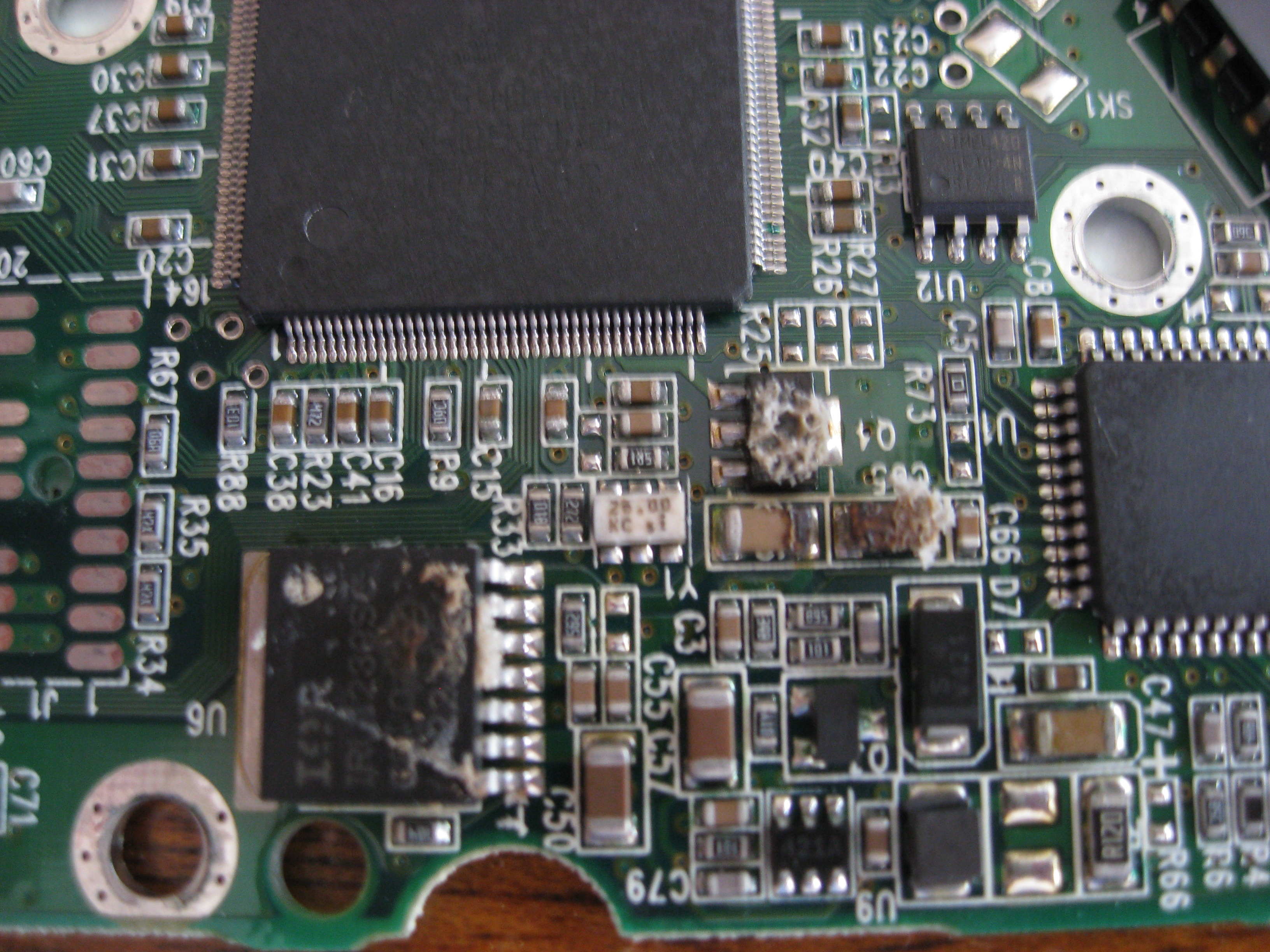

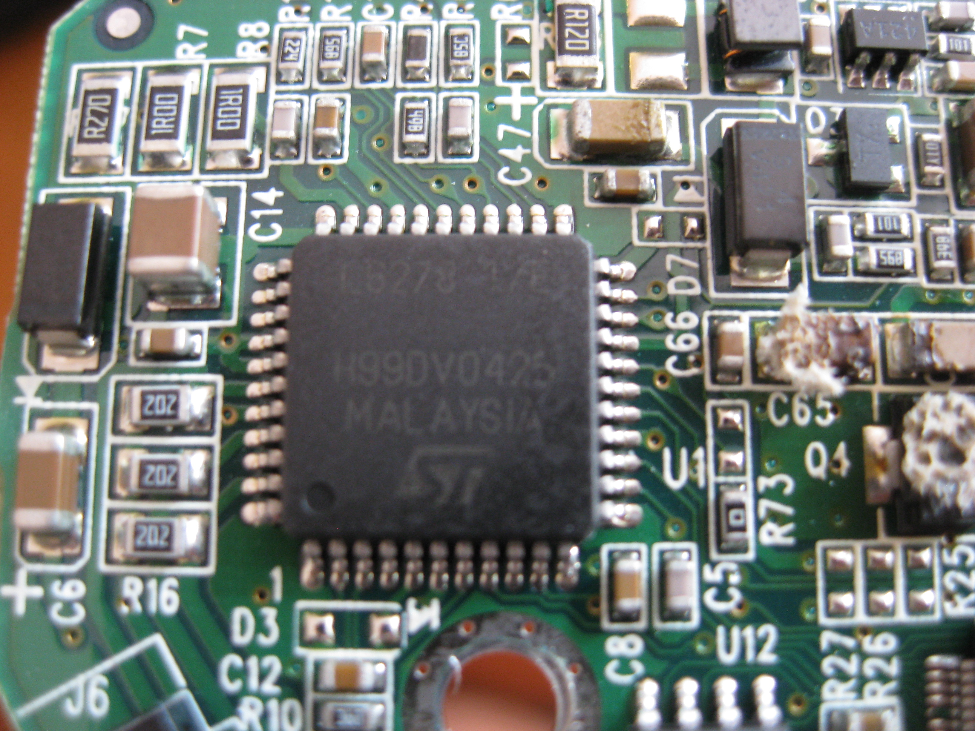

PostPosted: May 27th, 2012, 16:01
Seems like somebody has worked on the PCB. See goo like paste. Is it flux or.something? Who worked on it? What was the goal? What were the results?
Either way, at this point a working compatible PCB will be necessary, along with adaptives transferred.
PostPosted: May 27th, 2012, 16:25
C65 and nearby component don't look fine to say the least.... :(
PostPosted: May 27th, 2012, 16:52
Posts: 927
Location: uk
Just an observation........... 2 pins on U5 appear to have been marked in green. I can't say what this might mean, if anything at all.
PostPosted: May 28th, 2012, 10:21
Posts: 15
Location: New York

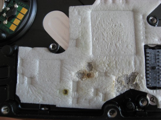

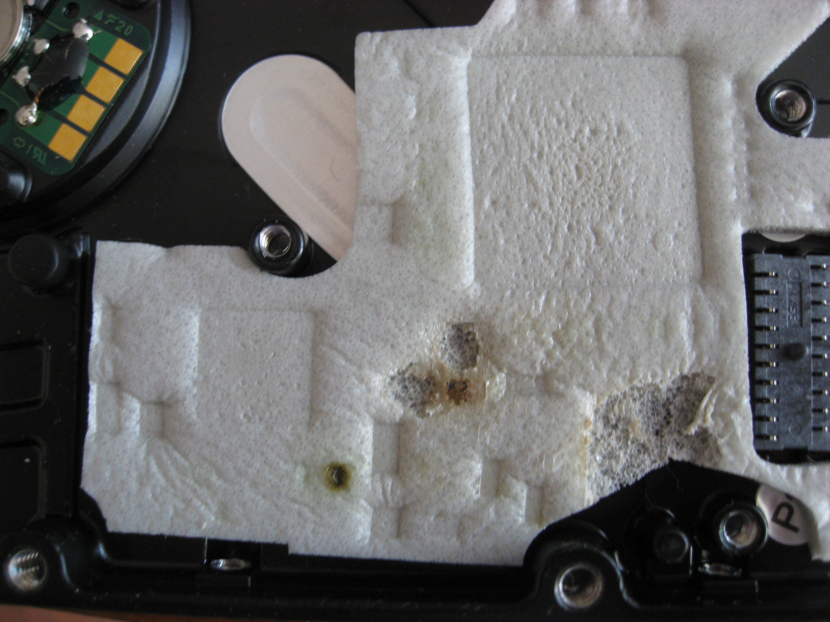

Based on the replies, I can tell you that the goop you are seeing is from the pad underneath the board where it [the pad] has melted. You can see the burn marks...
The burn marks and melted pad line up with the (3) components that have the goop...
C65, Q4?, and U6
