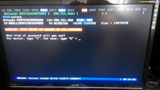

I just did the diag again and it still says its locked
I tried my passwords but they dont work on master "1" or user "0"
I think that yesterday I made a mistake and typed once password and failed then typed it again with out taping unlock
what if my password doesnt work for some reason - is there a generic master password ?

 Post subject: Re: Unable to initialize hdd after MHDD password removal
PostPosted: June 15th, 2012, 18:41
Joined: May 6th, 2008, 22:53
Posts: 2138
That explains the behaviour you've been reporting, and this is exactly what I wanted to check in the MHDD output (although that isn't the specific command that I asked you to run. ;) )
You claimed to have already unlocked the drive. I don't understand how you can have any doubts about doing it again.
For that type of drive? Probably - but the chances of it working in your case are little or none. With the modern BIOSes that I have seen, they all change the master password when you set a user password, so the default master password would likely be useless - after all, if it worked, then there wouldn't be much security!

- I thought I unlocked it yesterday when I typed unlock - 1 - and password came as fail but then I figured i made a mistake and instead of typing unlock again I entered password again then i didnt give me any error msg so i figured it worked.
- since my laptop died few weeks ago now I feel like im not sure what password I used but I went through all password I use and still none of them work in master or user mode.
im starting to lose my mind :/ and trying to come out with possible password that can work but I get fail all the time.
what else I can do to get that out ?? I have all my kids picts there since they were born and no backups :(
please help
