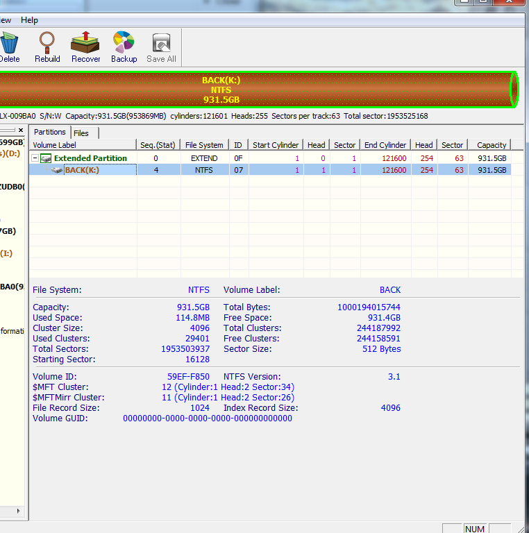

QUESTION: Can the Master File Record be restored to a partition? Essentially, can we recreate what the drive was before the formatting took place?
WHAT HAPPENED
(1). We accidentally formatted our drive
(2). I took a partial backup image of the drive. When it took too long (1TB drive), I cancelled it but saved the *.pmf (Partition Guru) file.
(3). We tried to recreate the MBR and repartition it. The process took about 5 minutes but now the data is no longer accessible.
(4). We tried using some recovery tools and the folder structure and file names have become unrecognizable. We can still recover some of the data with LOST FILE___ filenames.
SO FAR
(1) These are the details of the partial image file. Note that it incorrectly displays the size as 77.9GB because its a partial recovery

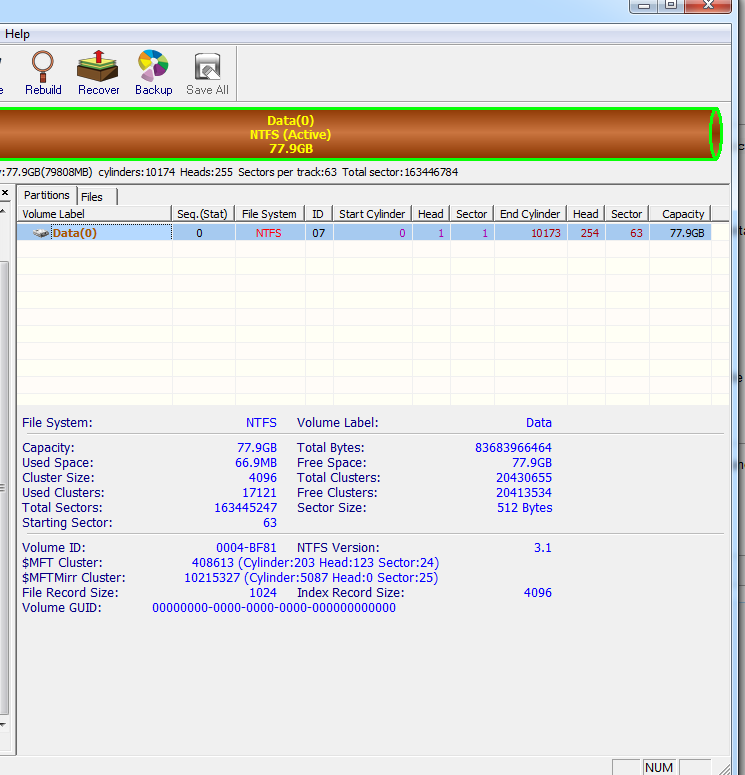

(2) These are the details of the drive after formatting and re-partitioning.

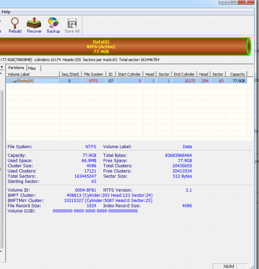

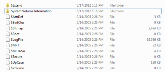

(3) I have been able to recover the system files ($MFT, etc) from the partial image *.PMF. See screenshot

At first, Keep off working with the drive.
It's Called TEMPERMENT / MESSUP - You should never do what you don't know - specially in Data Recovery - it's case sensitive and mostly One Time Assignment - Pro warn it in regularly, you never want to hear it.
Anyway,
Que-1: How did you format? WINXP/Win7 or any thirt party utility?
Que-2: Quick/Full formatted?
Que-3: Why did you Re-partitioned after the FORMAT?
__________
THANK YOU
SHAHI
shahi.mahbub@gmail.com
 Post subject: Re: Lots of blunders! Anyone up for the data recovery challe
PostPosted: June 19th, 2012, 0:44
Joined: June 18th, 2012, 5:44
Location: Singapore
Anyway,
Thanks for the response.
1. Partition Guru in NTFS.
2. Quick format (took 2 minutes)
3. Re-partitioned it to make it accessible again, otherwise it was showing as Unallocated.
PostPosted: June 19th, 2012, 4:35
Posts: 1061
Location: Bangladesh
It was simply recoverable after FORMAT, but before RE-Creation of Partition.
Well, whatever you have done, stop for now.
use some utility to search Previous PARTITION..
